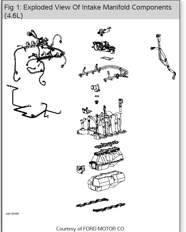

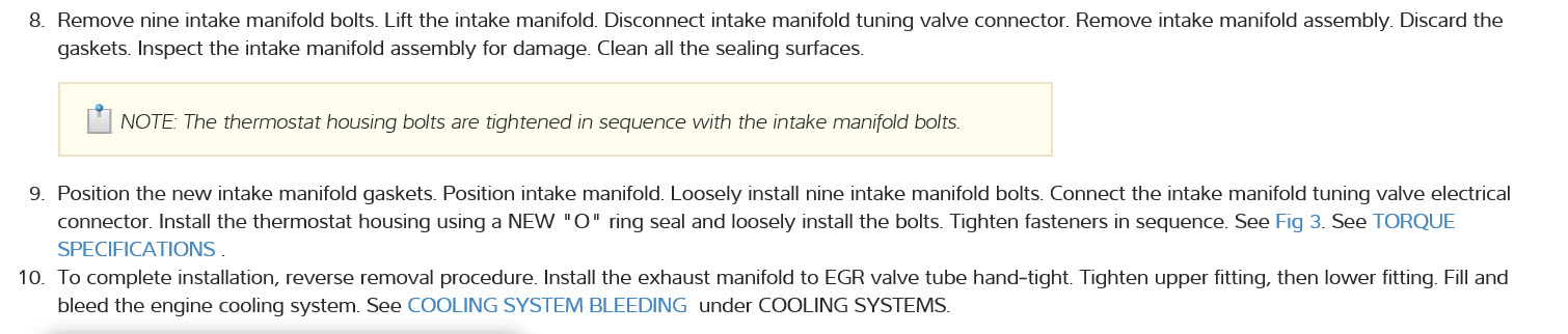

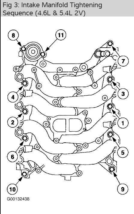

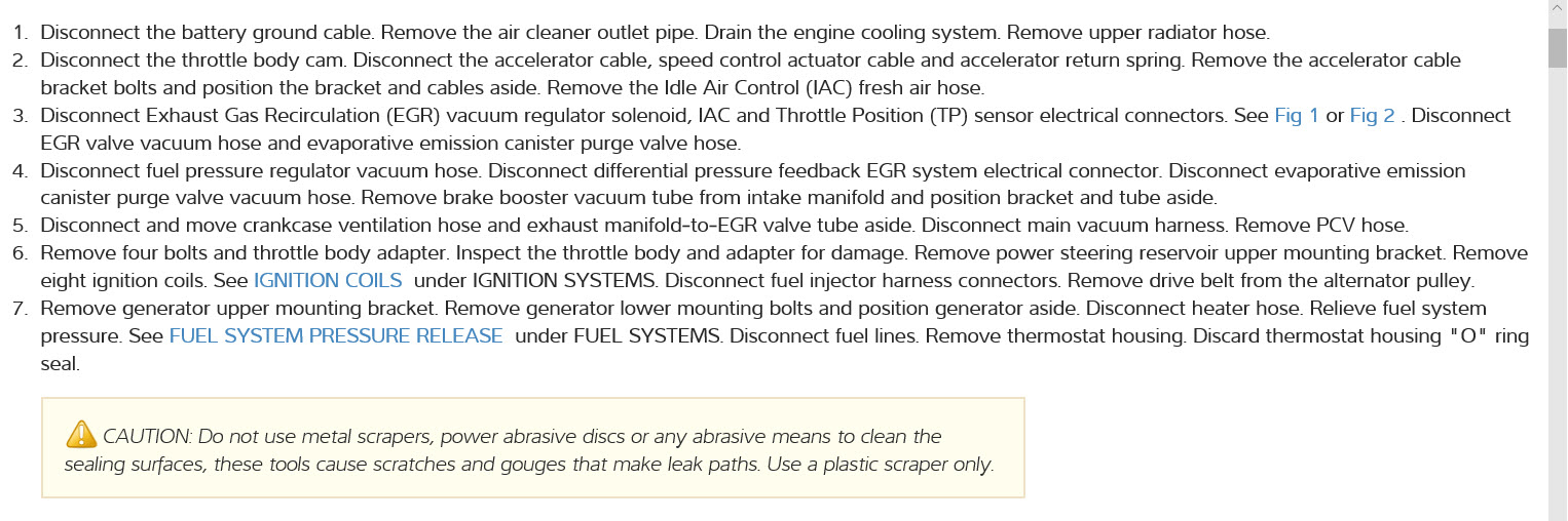

Do I have to take the whole intake off in order to change out the IMRC on my truck it is the XL model?
Wednesday, April 26th, 2017 AT 4:04 PM
HMAC300
MECHANIC
48,601 POSTS
Yes you do. See pictures for instructions.
