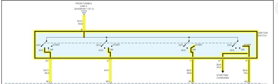

I need the wire colors and name to put on a new ignition switch.

Good morning,
I attached the diagram of the switch for you to view. The wire colors are there as well as what they control.
Let me know if you have any other questions.
