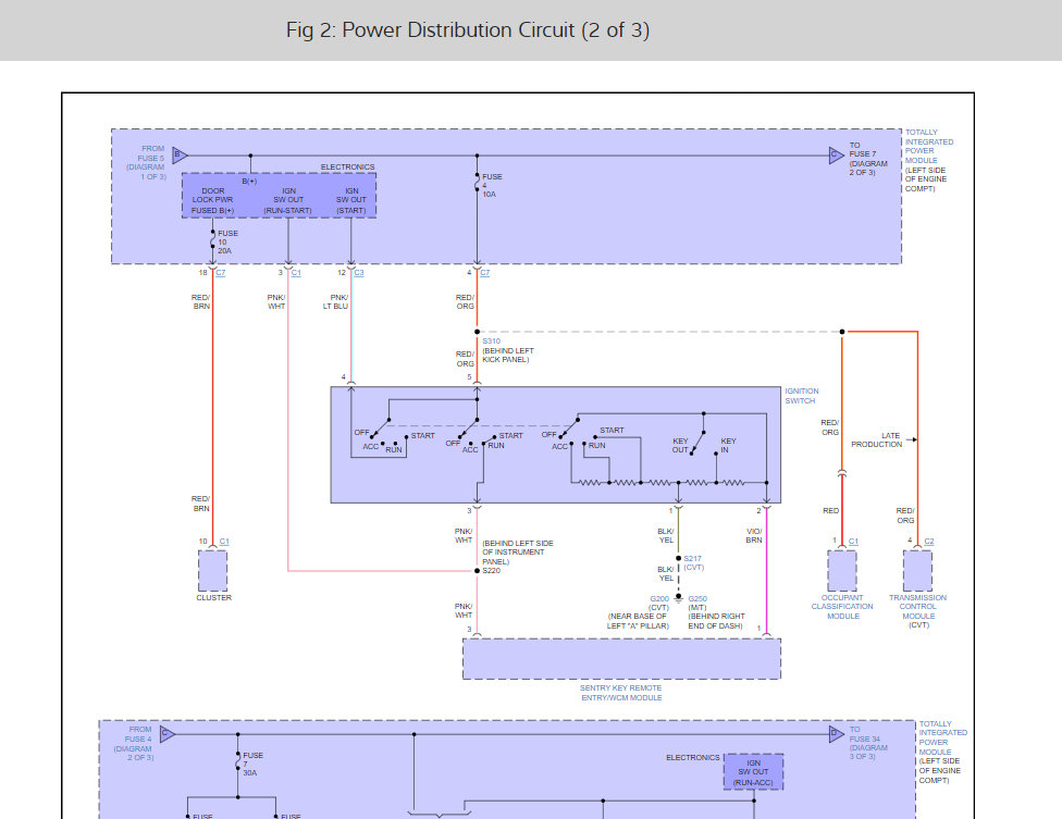

The key switch sometimes works sometimes like I have to let off and hit the key again at start up. So, I am trying to put in a push to start and I can't find what the four wires are on the ignition switch.
12+ is one I got that one.
and the ground wire I got that one.
one I think is acc.
not sure on the fourth wire oh and as of right now the car will not try to turn over.

I looked through the schematics and was able to find one pic related to the ignition switch. It is listed under power distribution,
Take a look through it and let me know if it helps.
See pic below.

This does help some, my car does not have power locks and the pnk/lt blu wire is not there. The only thing I can think of is that they changed the wire color.
1. Red/org is +12.
2. Pnk/wht is ign sw out? Acc not sure if this is right.
3. It's pnk/lt blu this wire is not there it's a violet wire this is the wire they maybe changed the color on? But if it's right this would be my start wire.
4. Blk/yel is ground.
Does this look right I don't want to break my car or start a fire with it?

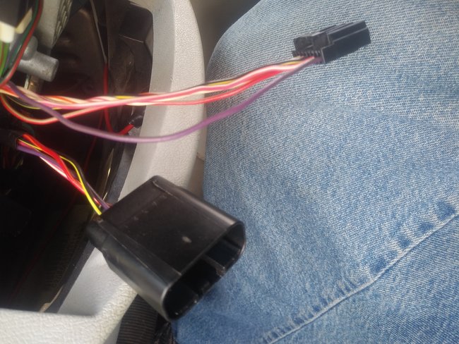

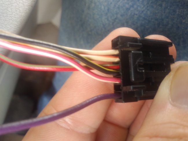

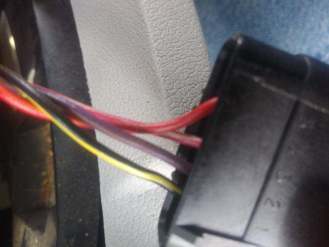

Yeah, they have made a miss of things and I don't know what I want to do as of right now can't pull the key cylinder out it's stuck 100% so that's out. Oh, I did take some pics of some of the wiring for the key switch wiring and the Sentry Key Module wiring that violet wire goes from the key switch to the Sentry Key Module. I say violet more like a purple wire to me I'll try to add pics of the wire connectors for both key switch and Sentry Key Module.
Wednesday, August 10th, 2022 AT 1:54 PM
BRANDONW2022
  • 11 POSTS
Okay, here are the pics I have this way if you guys want to see maybe i'm doing something wrong.

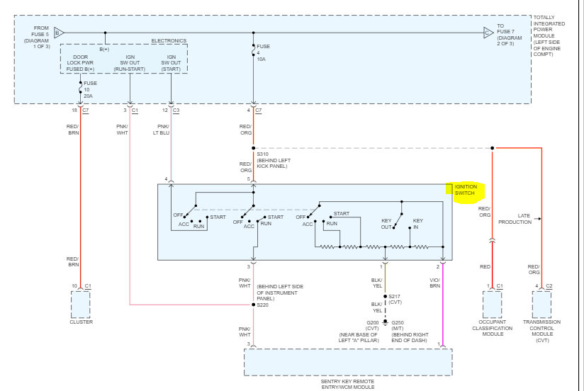

I think I just found the problem with my key switch went out to go to work this morning and hit the key lights come on on the dash but didn't turn over so I went to trying to find out what happen it was fine the day before. Looked at fuses all where fine still I replaced some of the fuses thinking maybe a bad one still nope so I started thinking key switch I pulled out the tester to see if I had power there ground was good the key sense wire was good and the pnk/wht wire was good (test key sense wire and pnk/wht wires by touching them together dash lights up so there good) now the fun part red/org wire is +12v well it is reading 0.49v not sure how this is but okay still not getting +12v to it I think the big gray connector has a problem under the dash that these wires go to. 2 things I need to ask
1. How do I get this big gray connector to come free from the dash so I can see if there is anything wrong with it
2. I don't want to ask this but is there any way I can get a wiring diagram for both sides of this big gray connector with the wire colors and what they are please
Friday, August 12th, 2022 AT 6:17 AM

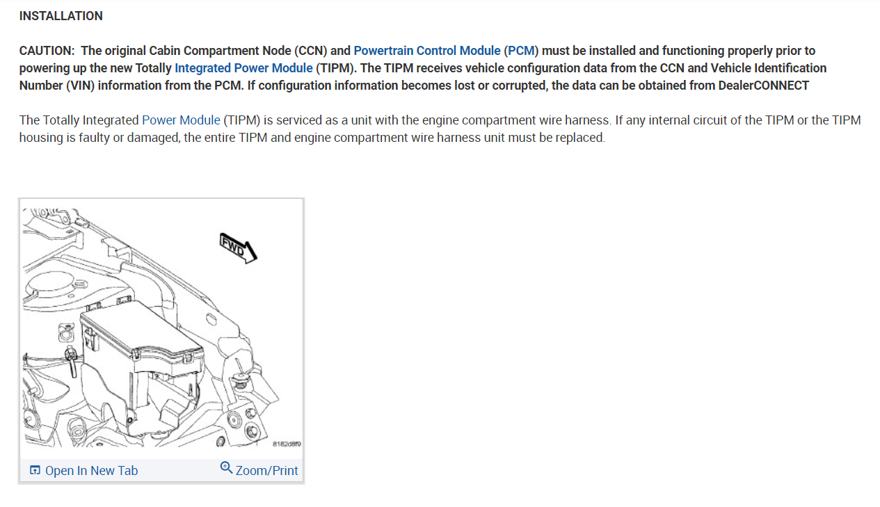

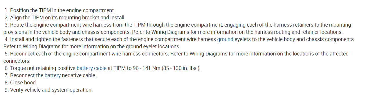

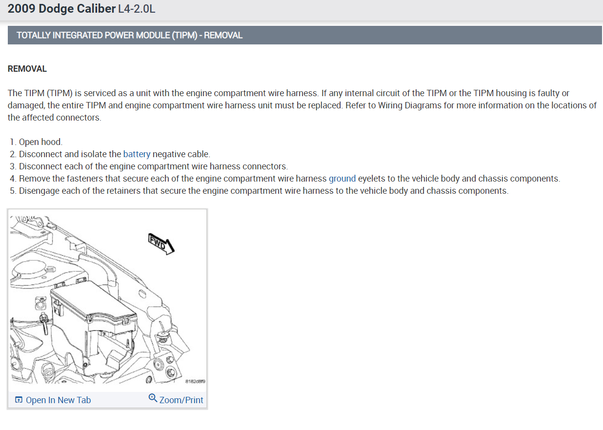

KEN L
  • MASTER CERTIFIED MECHANIC
  • 55,302 POSTS

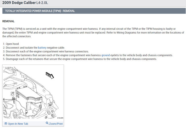

Sure, we can help you out. To me it sounds like TIPM, which is common. Here are the wiring diagrams you need. Just in case I have added how to change the TIPM out which is easy because it-self learns. Check out the diagrams (below). Please let us know what happens.
+1
Friday, August 12th, 2022 AT 11:32 AM
BRANDONW2022
  • 11 POSTS
I found a way to fix this without replacing the TIPM. The fix cost was $9.00 but thank you for the info on the TIPM box. I'm not replacing it.
