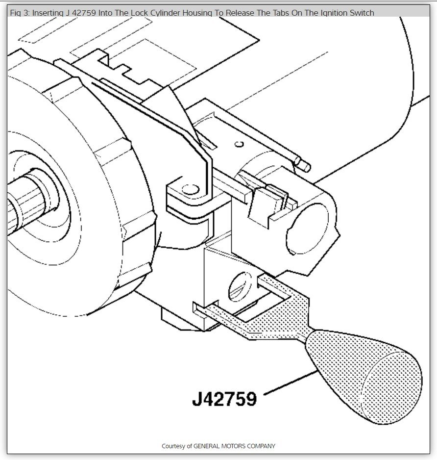

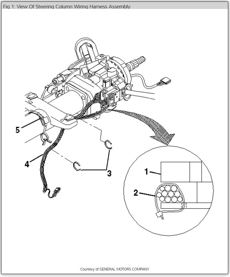

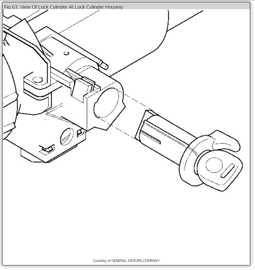

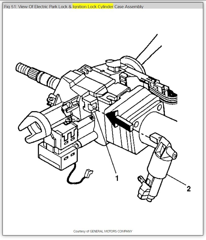

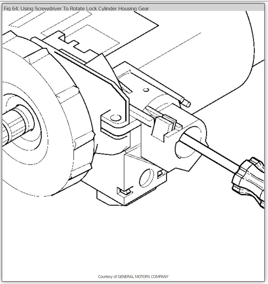

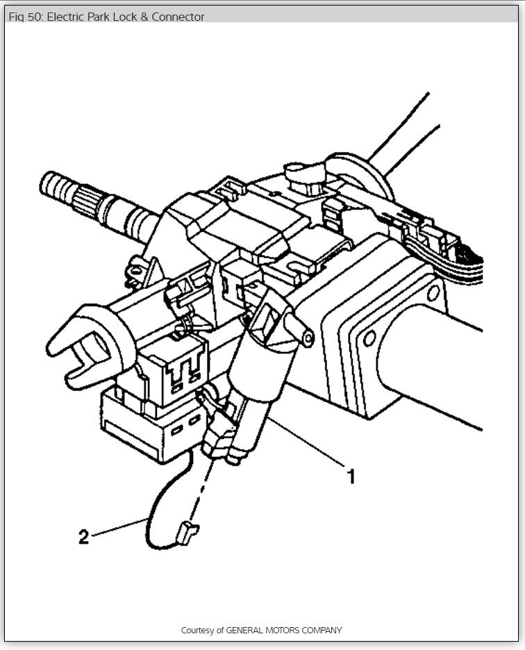

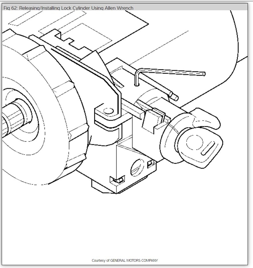

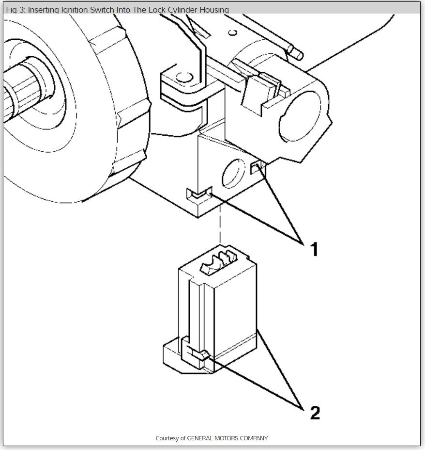

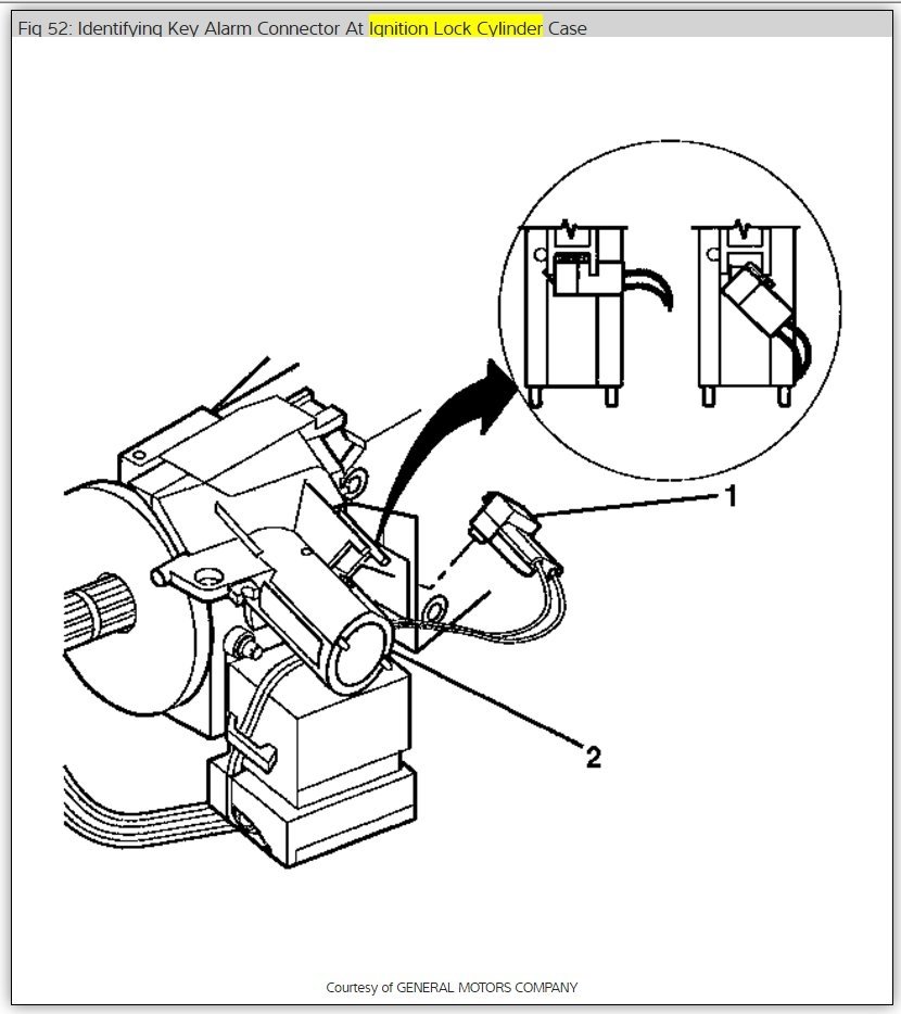

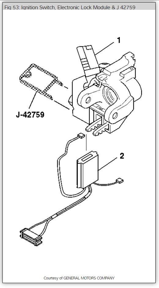

Switch stuck will not turn on or back truck in park. No buzzer sound with key in switch.
Tuesday, August 1st, 2017 AT 7:39 PM
KEN L
MASTER CERTIFIED MECHANIC
55,281 POSTS
It sounds like the ignition lock has gone bad which is common. Here are some guides to help you get the problem fixed.
You will need to have the key programmed at the dealer.
