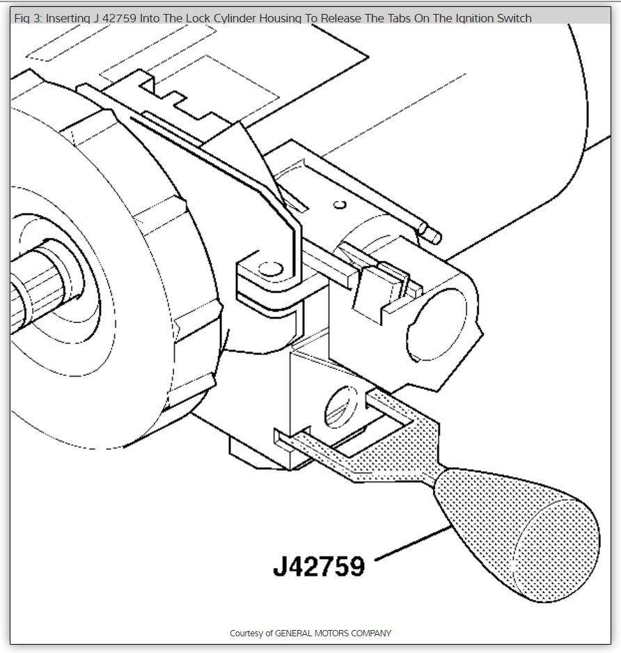

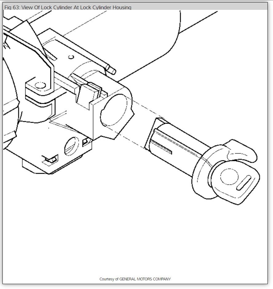

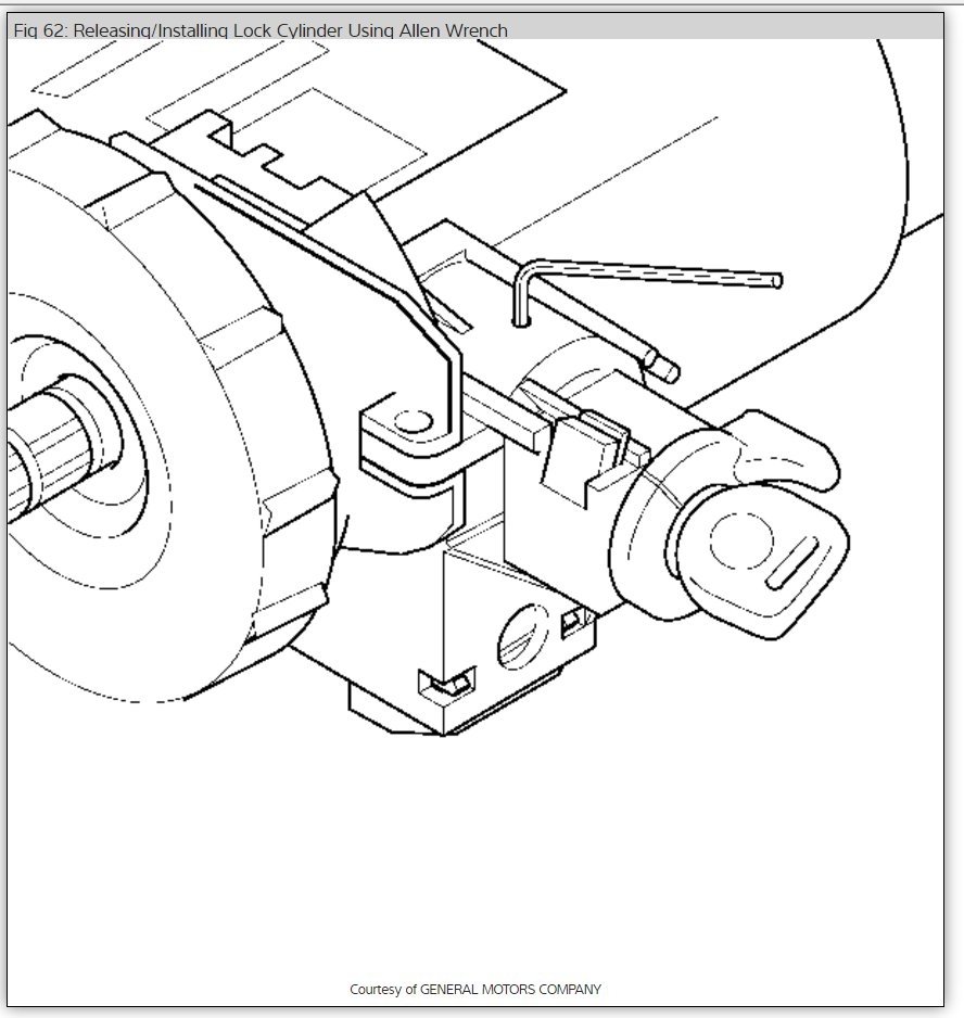

I have gone as far as trying to replace the cylinder switch, but cannot get the switch to release because the key is stuck in inserted position the linchpin underneath will not allow me to release the cylinder from the plastic holder. Therefore I cannot pull it out to install the new cylinder.

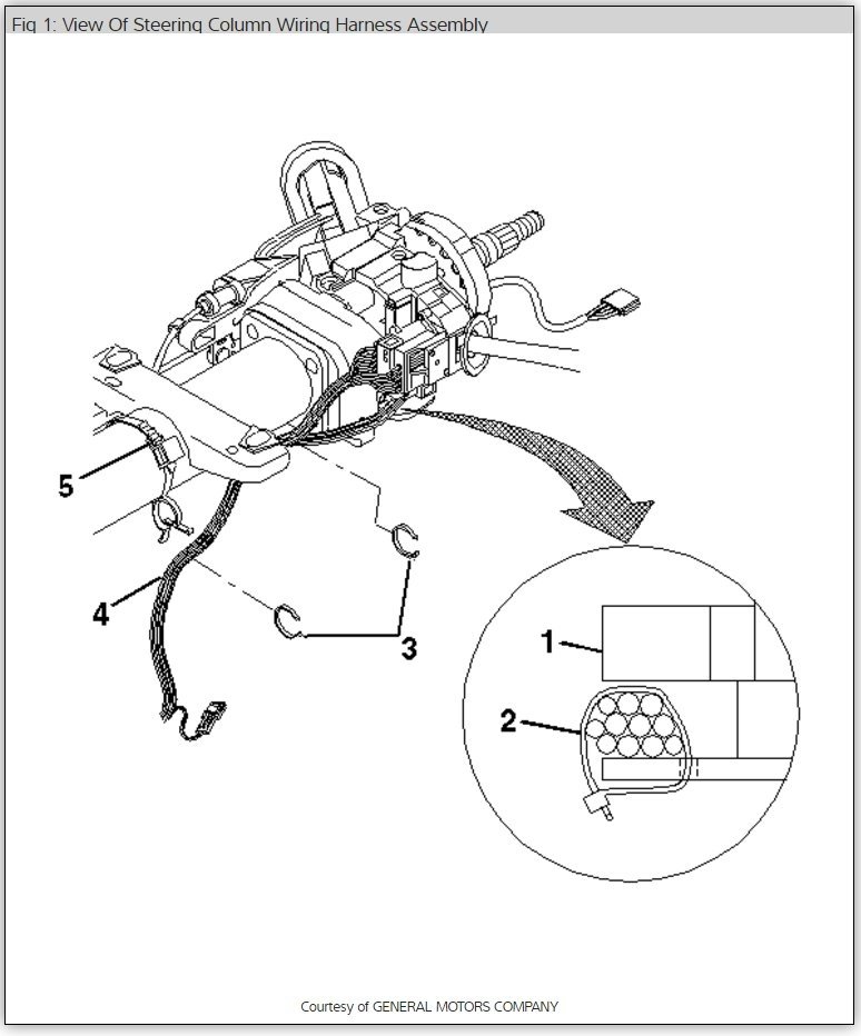

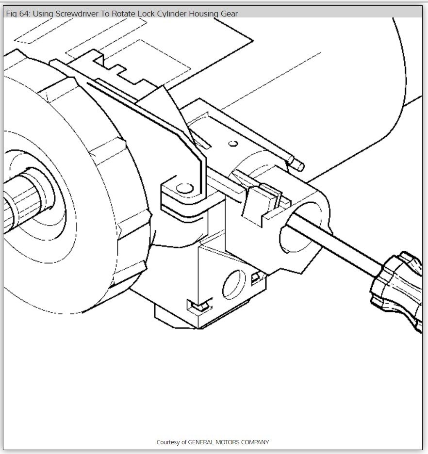

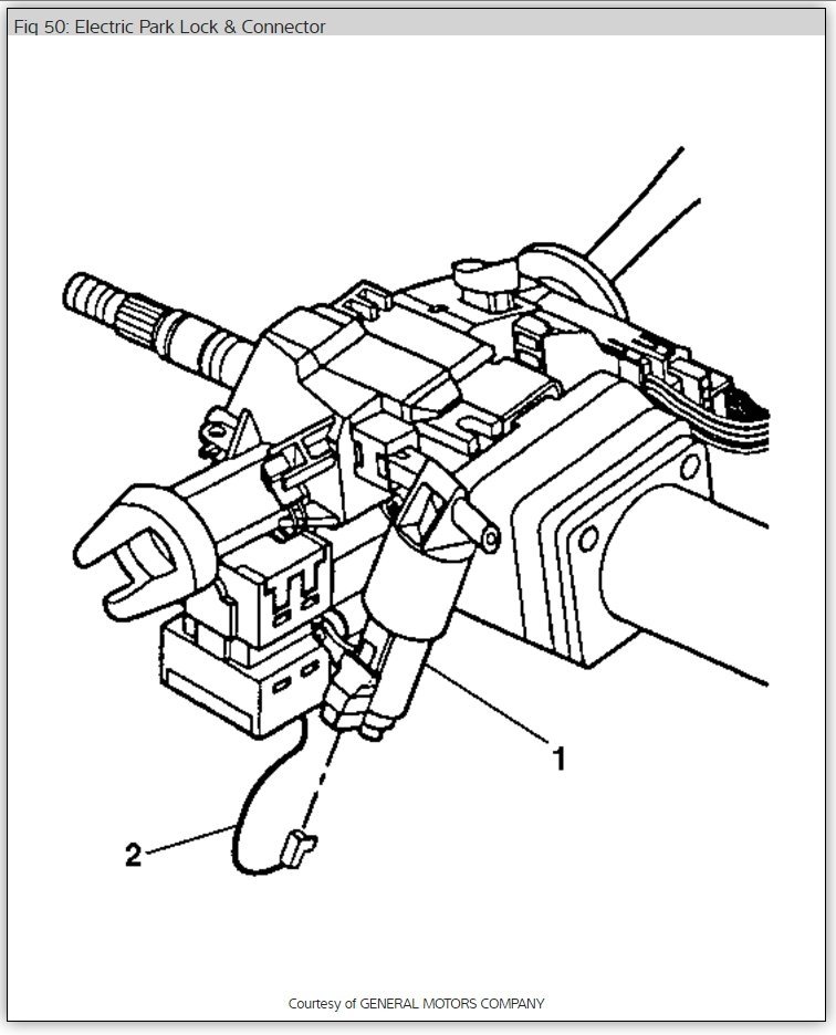

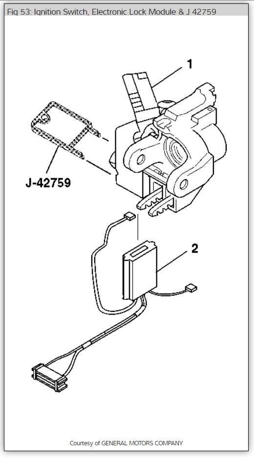

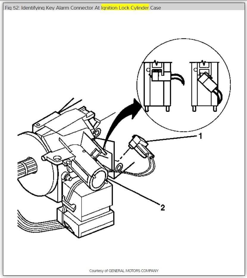

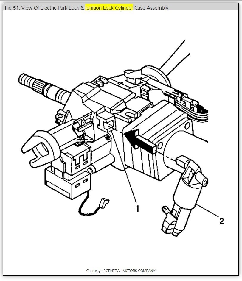

If possible force the tumbler into the correct position it will be replaced anyway. These problems can be a little rough. Here are some diagrams (below) that might help you get the job done.
