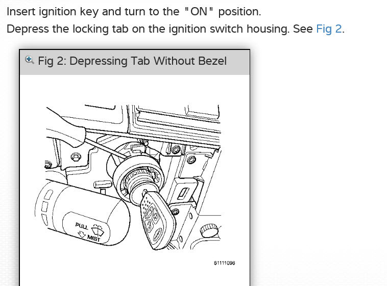

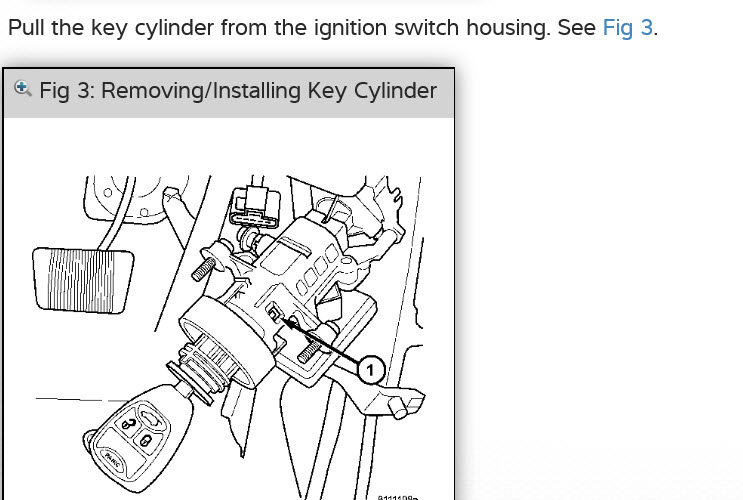

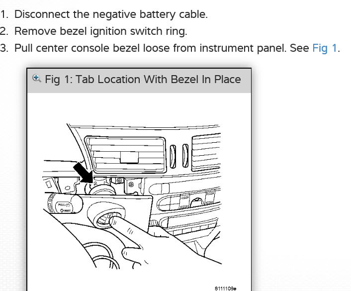

How do I remove the lock cylinder to replace the tumblers and springs

See pics
