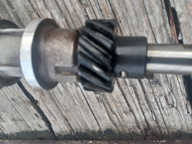

I removed it without marking first where it goes. (I did take pictures though) The roll pin broke on the cog wheel, so I replaced it.

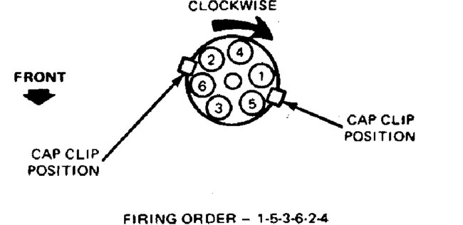

Let's start with the engine at TDC. This way the #1 cylinder will be at the top of its travel. With the distributor cap off, the rotor should be pointing at cylinder #1. I attached a diagram of your configuration for your reference. If it is not pointing at cylinder #1 then turn the distributor to match and turn the engine over twice and recheck. Once it lines up correctly you can put it back together.
Now, the important part about changing the timing. Remove the SPOUT connector before starting the truck. This is not optional. With the SPOUT connector removed, start the truck and use a timing light to check the timing. Loosen the distributor bolt and turn the distributor until you see the line revealed by the timing light on the crank pulley line up with 10BTDC. Tighten the distributor bolt and turn off the truck. Now, install the SPOUT connector and start the truck again and test drive.

Just a quick question. What would make the roll pin keep breaking? It's the second time I replaced it.
Monday, November 4th, 2024 AT 5:07 PM
CANNON1349
  • 911 POSTS
That's not a good sign and could be part of the problem. If there are issues with the oil pump shaft going into the distributor it can easily shear off the pin because of the extra load. If this is a new distributor and you keep putting pins in it, I would inspect the pump / shaft. Turn the distributor upside down and look inside the bottom where the oil pump shaft will go. Is it completely clean? Also, when tightening down the distributor the gear does not need to bottom out in the engine, this can also cause more torque on the pin. Outside of looking at the distributor side the oil pump would have to be fished out once the oil pan is off.
