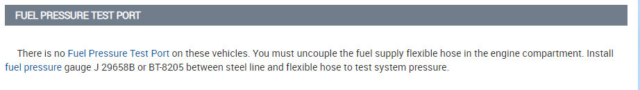

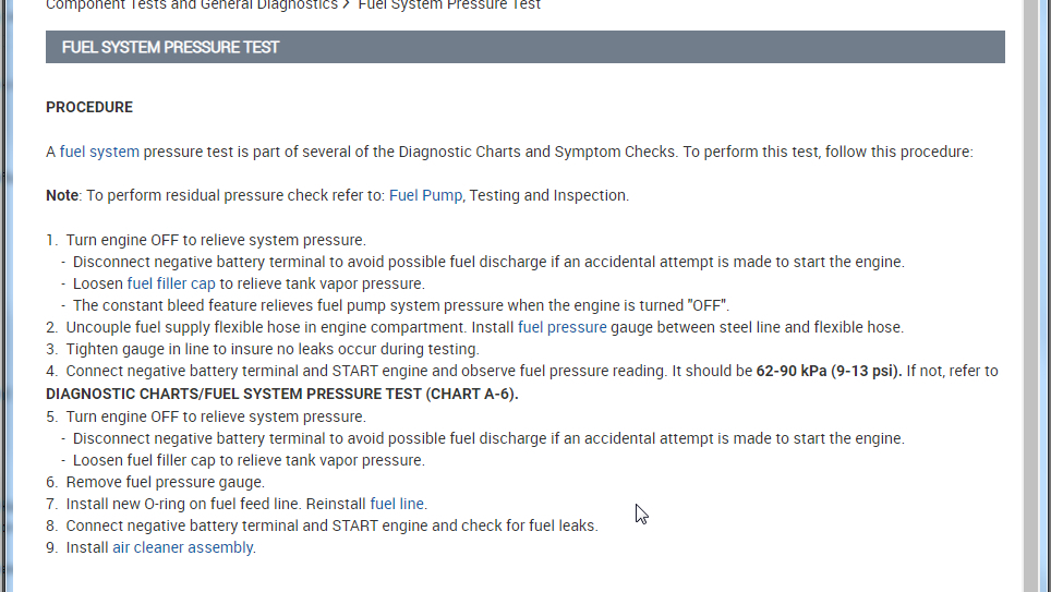

Even though starting fluid did not work this still sounds like a fuel issue so we need to check the fuel pressure and make sure it is correct.
Below is the process from the manual that will help with this.
Let us know what you find with this and we can go from there. Thanks

I'll check the fuel pressure and let you know.
Thanks

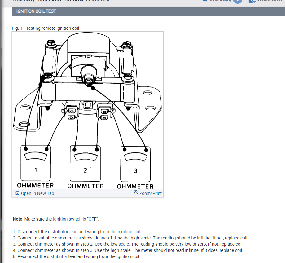

When you tested the voltage going from the coil to the distributor were you checking this with the engine cranking?
You should have high voltage going to the distributor from the coil and not just 12 volts. If you only have 12 volts then your secondary side of the coil is not operating to disrupt the 12 volt feed to create the high voltage.
Below is a test for the coil. Let's do this and go from there.
Sunday, February 21st, 2021 AT 6:48 PM

The engine was off, but the ignition was switched to the run position.
I'll check the coil. That's the only part of the electrical system that I didn't change out with the tune up.
