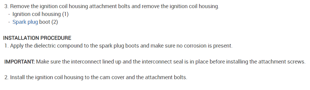

Just replaced coil pack and boots, didn't replace ignition module went to start it no start, cranked good but no start. I do have issues with my theft mode on this car since I've had it, I just bypass it by sitting with key on till it quits blinking and it starts, it did that my first crank after I changed coil pack and no start since. Just letting you know I'm a 61 years young woman so I might not give you the information in order.

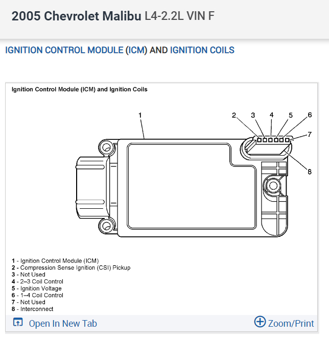

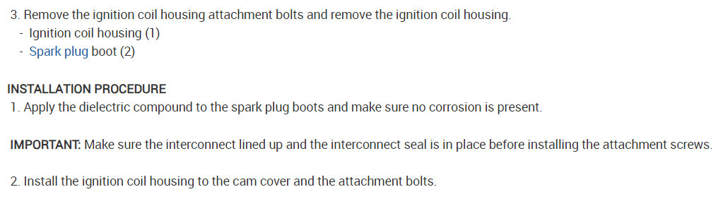

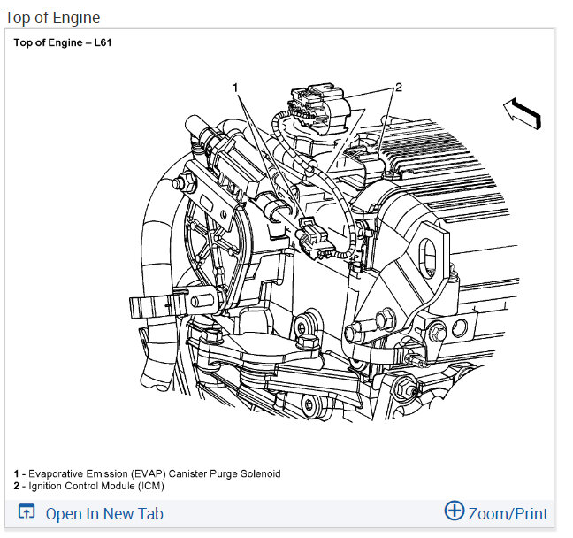

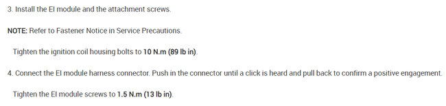

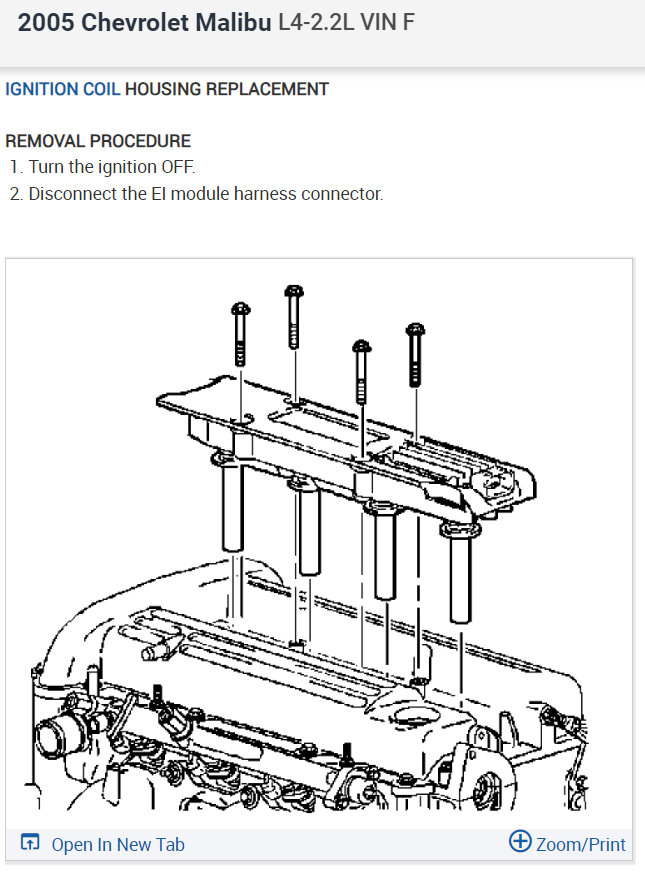

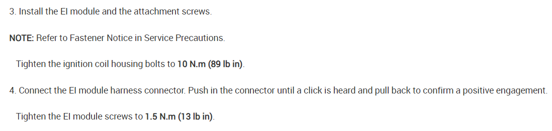

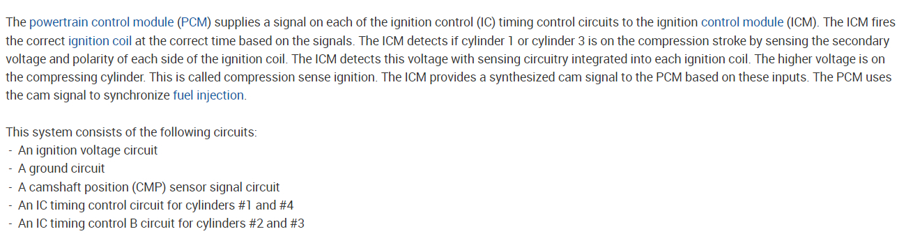

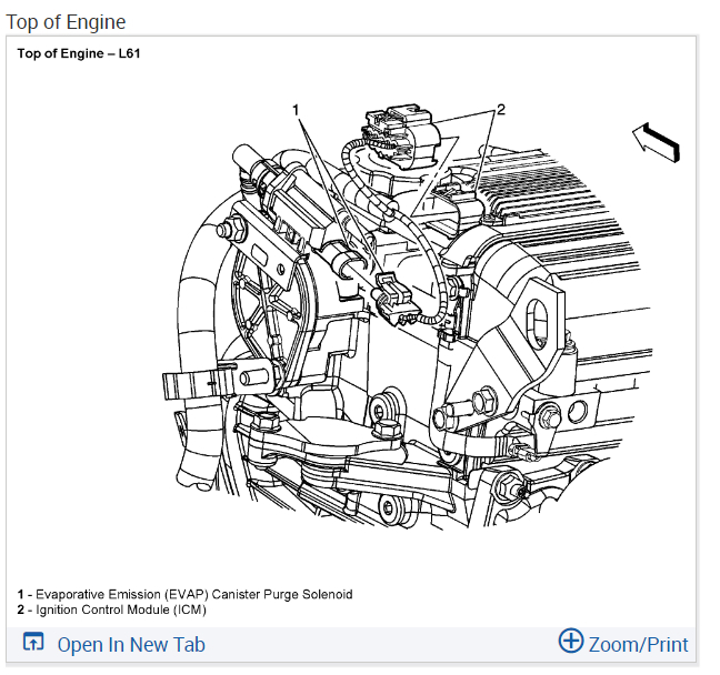

No problem, so the engine never started after the ignition coil replacement, correct? I would say you have a defective part. Can I ask which brand the part is? The ignition control module is integrated into the coil pack. Here is the correct way to replace both, also make sure the electrical connectors are plugged in completely. Check out the images (below). Please upload pictures or videos in your response of any problems so we can see what to help you with.

And the images on control module doesn't look like my 2.2l motor.

The coil pack has the module bolted to it, you can use a voltmeter and test the OHMS of each of the coil terminals but that is not an actual "in use" test which is difficult to do. The images are correct for this car I have double checked, you can upload an image so I can see so we are on the same page. The fact that it doesn't run means the installation is not correct or the new coil pack is bad. Check out the images (below). Please let us know what happens.

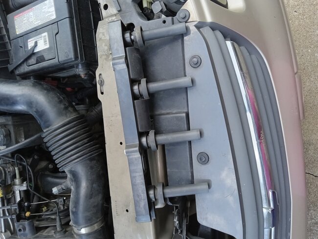

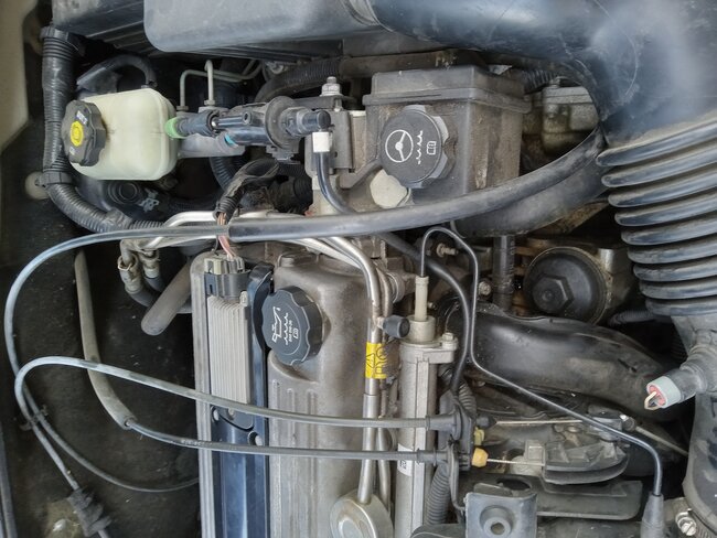

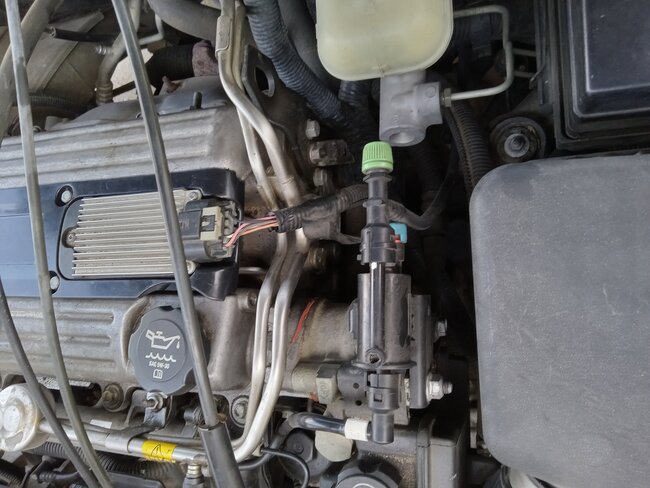

Here is my car photos the 1st is a picture of old coil pack and boots and the next 2 show the module and some connected sensors maybe.
Tuesday, July 9th, 2024 AT 5:14 PM
KEN L
  • MASTER CERTIFIED MECHANIC
  • 55,291 POSTS
Yep, we are on the same page, this is the coil pack and ignition module. I would disassemble them to see if the electrical connectors are okay, ands if so I would get another coil pack because the one you have sounds defective.

I'll be getting a new coil pack today. I put my old one back on it started so yes you were right about the bad part. I hope I have good news later. Oh, the connectors looked good. And dielectric grease, where all should I put it?
Sunday, July 14th, 2024 AT 1:26 AM
KEN L
  • 55,291 POSTS
Good job, you should install the dielectric grease inside the electrical connections and spark plug boots. Just a bit, you don't need to fill them up completely.

My car started right up thank you for your advice I would have still been trying to figure it out. You have been really helpful, have a great evening.

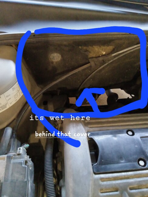

Okay, here I am again so now my car is overheating I have been hearing a whining noise for a little bit and the little hose from my reserve water tank to motor is very hot when I just went around the block.
Wednesday, July 17th, 2024 AT 2:30 PM
TERRI W
  • 37 POSTS
Also, here is an image of where water is leaking too.
Thursday, July 18th, 2024 AT 10:28 AM
KEN L
  • 55,291 POSTS
Hi Terri,
I will be glad to help and thank you for the reviews, we appreciated it. We only handle one problem per thread, can you please start a new one for the overheating problem? Thanks again.
