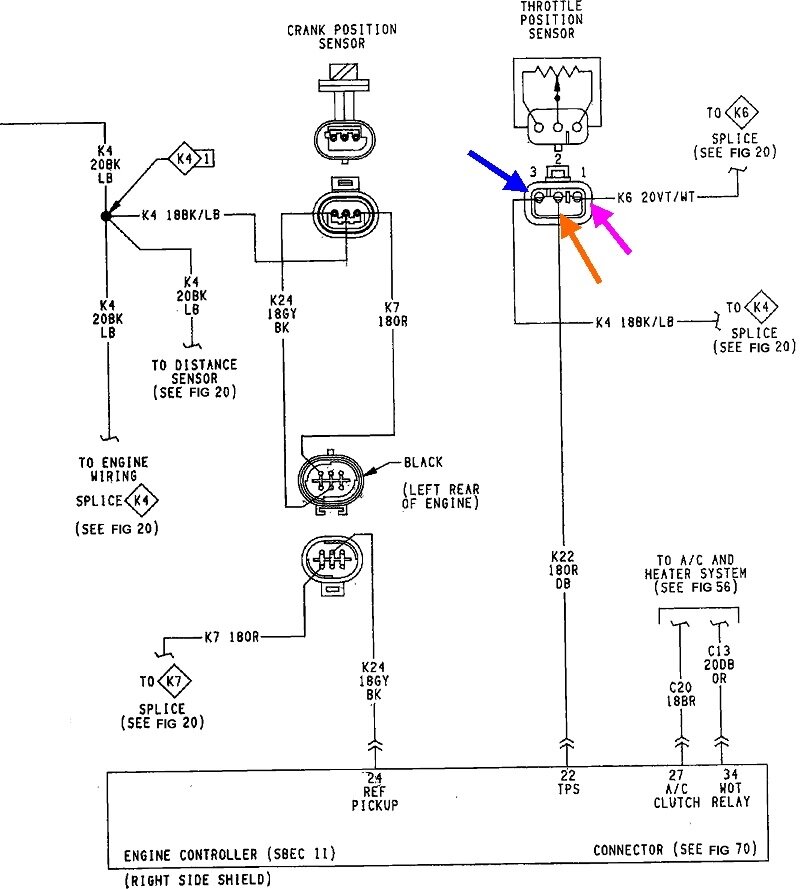

When I start my truck, it idles high and it shows trouble codes 12, 24, and 55.
Saturday, November 19th, 2022 AT 11:34 AM
8 Replies
CARADIODOC
  • 34,490 POSTS
24 - Throttle position sensor voltage high/low.
Code 12 just sets because the ignition switch was turned off. Code 55 means it's done displaying codes.
The throttle position sensor is fed with 5.0 volts and 0.2 volts, then the center terminal is connected to the movable contact that picks off the signal voltage between them, but there are mechanical stops inside it that limit the range of that signal voltage. The acceptable range is from roughly 0.5 to 4.5 volts, give or take a little, from idle to wide-open-throttle. If there's a break in the ground circuit, either inside the sensor, between its mating connector terminals, or that wire, you'll see the full 5.0 volts on the signal wire. That's outside the acceptable range and will set this code.
Likewise, if there's a break in the 5.0-volt feed wire, you'll find 0.2 volts on the signal wire, also outside the acceptable range. That will also set code 24.

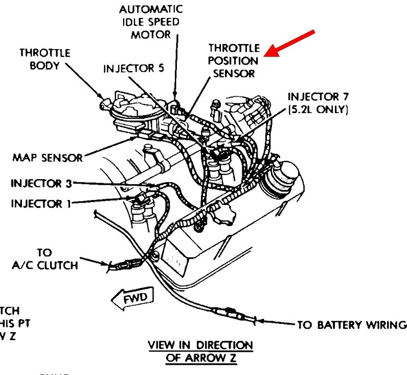

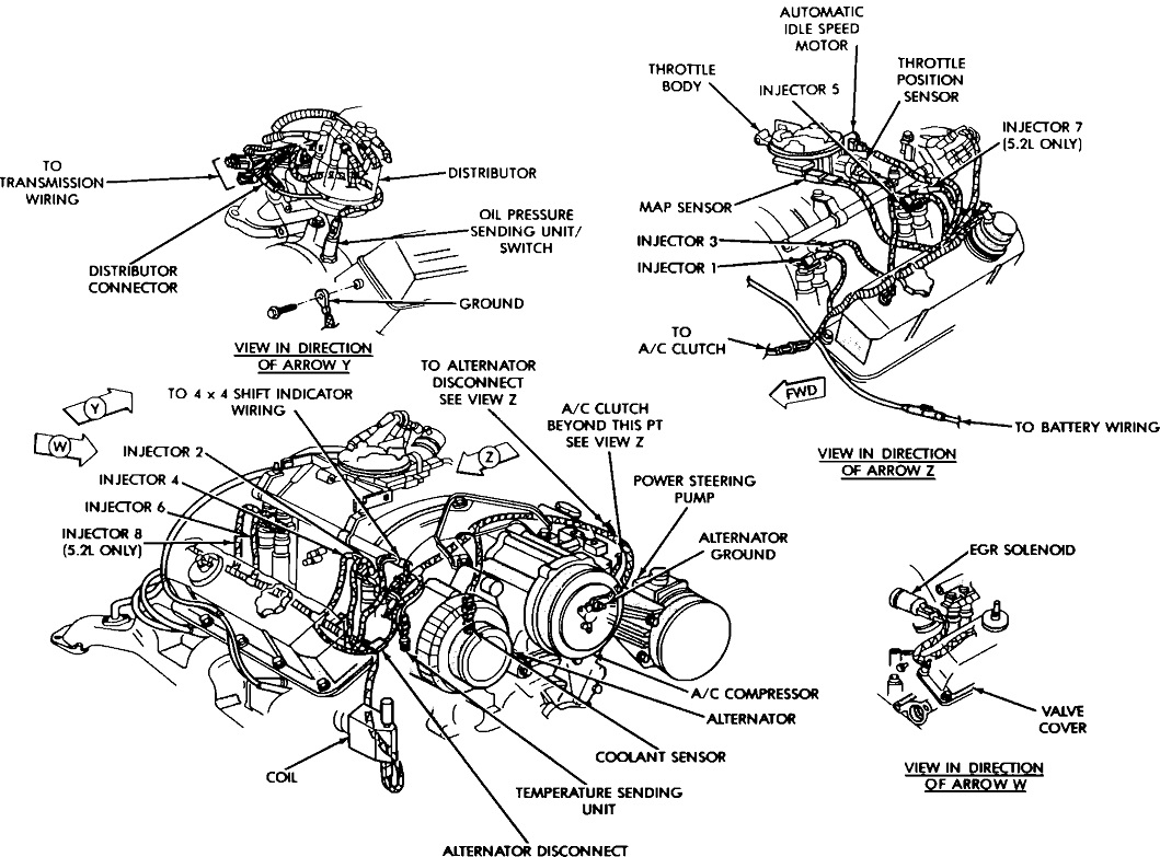

The place to start now is with voltage readings at the throttle position sensor, but those must be taken with the sensor plugged in to be valid. The sensor is on the driver's side of the throttle body. That's shown in the second drawing. It's easier to see in the expanded section in the third drawing. Back-probe through the rubber weather seals alongside each wire. The ignition switch must be in "run". If you aren't familiar with using a digital voltmeter, look at this article first:
They're using an auto-ranging meter here. That's an expensive option you don't need. You can find a perfectly fine meter at Harbor Freight Tools for around $7.00. Also look at Walmart, any hardware store or any auto parts store. If you need help setting it up, I can help with that.
First check for the 5.0 volts and ground wires. If those are both correct, check the middle wire in the connector. Those will tell us where to go next. The voltage on that middle wire should go up to around 4.5 volts smoothly as you open the throttle.
Let me know what you find on those three wires.

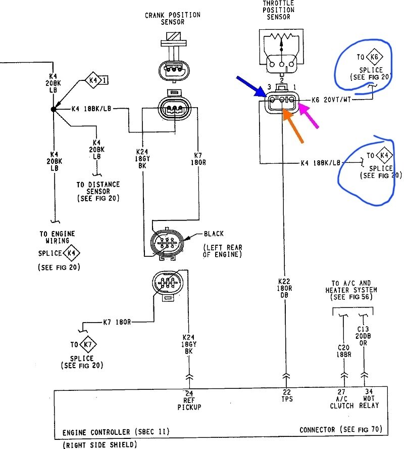

Where is the k4 and k6 splices located?
Friday, November 25th, 2022 AT 7:01 AM
CARADIODOC
  • 34,490 POSTS
I've never looked for those and it is irrelevant. One is for the 5.0-volt supply. That wire and splice feeds at least three or four other sensors. If there was a problem with that wire or splice, you'd have fault codes for all of those sensors. Also, you'd be missing the 5.0 volts to the TPS. That's why we need to know those three voltages.
Same for the other splice. That's for the ground wire, commonly referred to as the "sensor return". It's the ground circuit for those same three or four other sensors, and again, a defect in that circuit or splice would result in fault codes for all of those other sensors.
Both of those splices are buried inside a large harness. They're not practical for use as test points. I haven't found the location of them yet. They're in the paper service manuals, but I haven't found them in the online manuals.

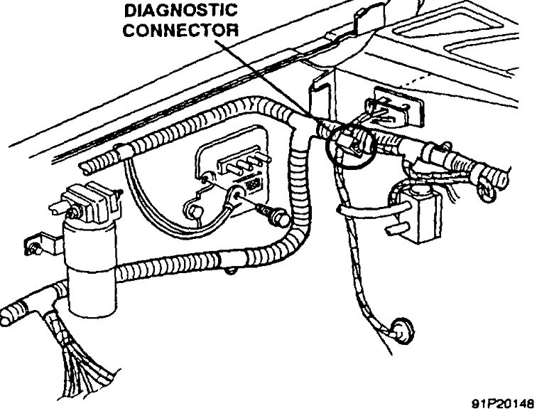

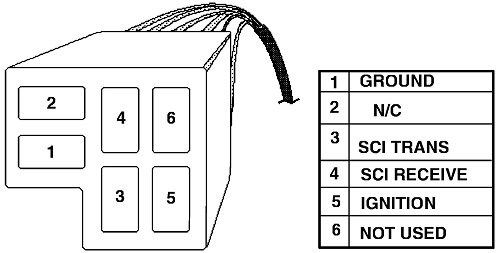

You're right. All OBD2 plugs must be under or near the steering column. Most '95 and older Chrysler plugs are under the hood on the driver's side. On a few models it was on the passenger side. '89 was the first year for the 4-speed transmission in Caravans. That computer used a different plug under the center of the dash, usually on the right side, and often behind a small pop-off cover. It will be blue. That's also the plug for Air Bag Computers. If you have anti-lock brakes, as I recall, the module and / or the connector is in / behind the glove box. For ABS in the early years on Dakotas, no other scanner works on that system other than the Chrysler scanners. I guess the aftermarket scanner manufacturers felt there wasn't much call for that.
I just found that I had the diagnostic connector saved for a '92 Dakota, and it is indeed on the passenger side. Check out the two drawings.
