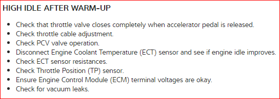

Trying to adjust idle speed, but my idle stop screw is missing. I need to know replacement size or part number.

Hello, I am Danny.
From what I understand the engine is completely computer controlled. Do you have a picture or description of the piece missing? There is no Idle stop screw. I have attached a step-by step guide to test a few things that would contribute to a high idle. Hope this helps and feel free to ask any questions if needed.Thanks for using 2CarPros.
