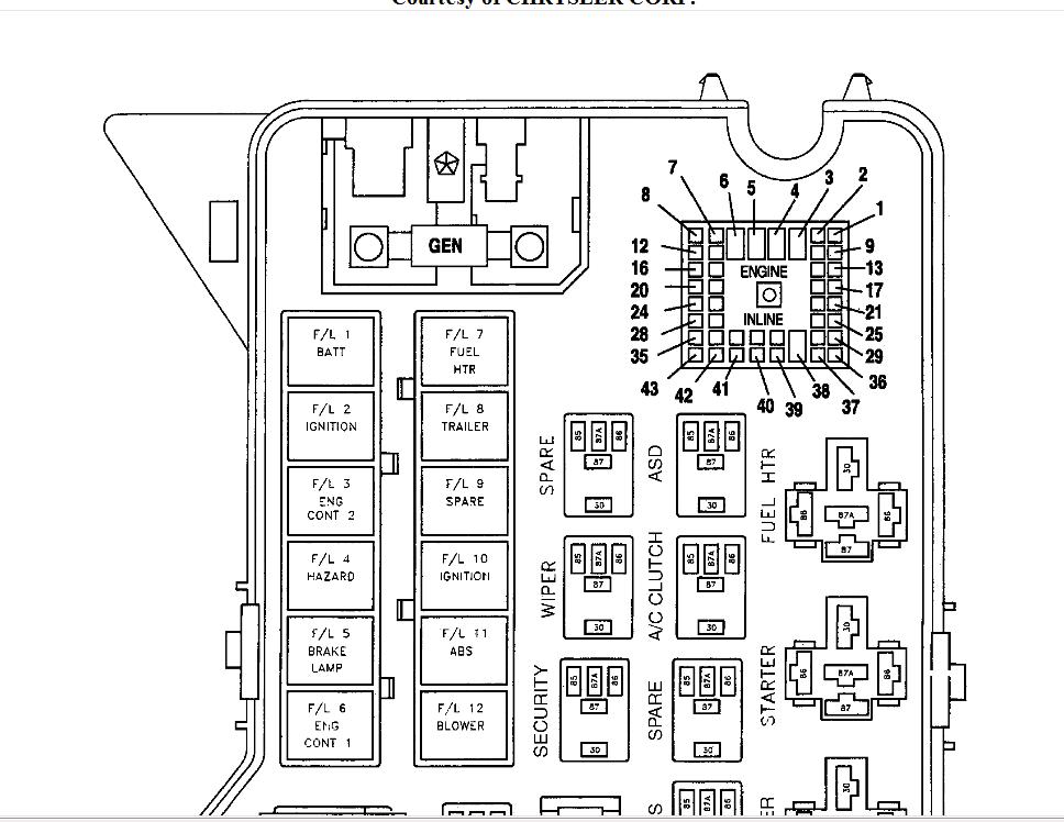

1998 dodge ram 1500 5.2 4x4 truck was running fine, stopped for gas, after filling started losing power and didn't want to accelerate, continued to get worse there. CEL never came on, it does work when you turn on key. Pulled codes p1388 p0138 p1492 p0300 p0301 p0303 fuel pump is working while running. I am also missing my cover for fuse/relay box under hood, so I have no clue which relay is for ASD. My owner's manual shows a different layout then mine.

Here is pic for asd also check battery for condition including load test an dclean battery terminals. Also switch asd relay with a like relay and see if it doesn the same this can be several things. Including a bad pcm or wiring. The o300 series codes are misfires an ddue to being very hard to diagnose then a pro should really look at this.

I have gauge, will check tomorrow and report back.
I switched relay with 2 others and no change.
