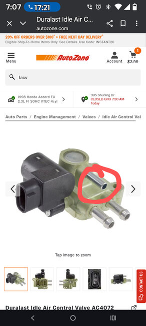

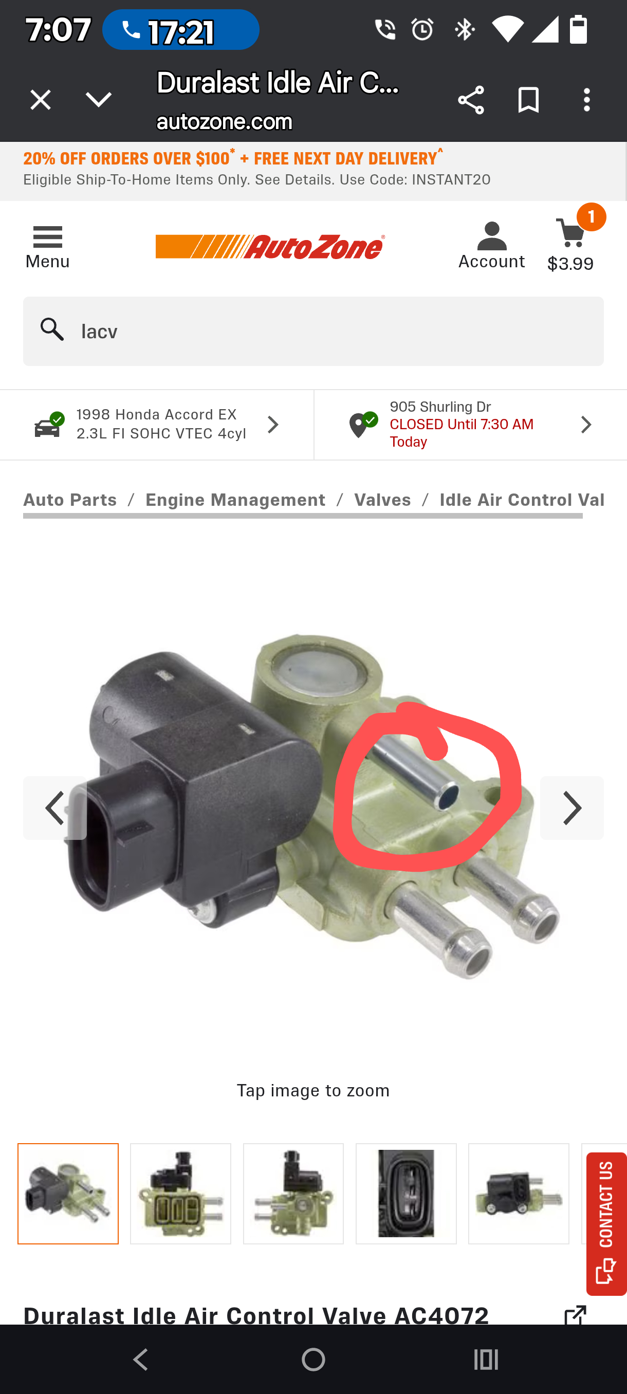

I just recently put the engine in this vehicle, and I was doing it in parts which took a little time, so I have a brain block on where the vacuum line on the IACV connects to. There are three ports on the IACV, two are coolant lines which I have connected but I can't remember where the vacuum goes. I have a photo of the IACV and have the vacuum highlighted in red.

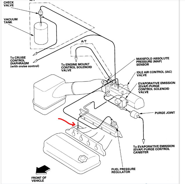

That vacuum line goes to a small port on the intake manifold near the #4 cylinder. Here is a diagram to show you. How did you make out with the crankshaft sensor? Check out the images (below). Let us know if you need anything else.

I thought so but I wasn't 100% sure. Thank you.
