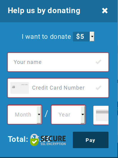

Thank You for everything. I tried to donate but the field to the right of Month will not expand so that I may enter info. See image, and show to webmaster.
Wednesday, February 22nd, 2017 AT 3:33 AM

Thanks for the image we have our tech guy working on that now. Can you tell us what device and browser you are using?

Firefox 51.0.1
Ubuntu Mate 16.04
Computer
Friday, February 24th, 2017 AT 1:50 PM

It has been fixed.
