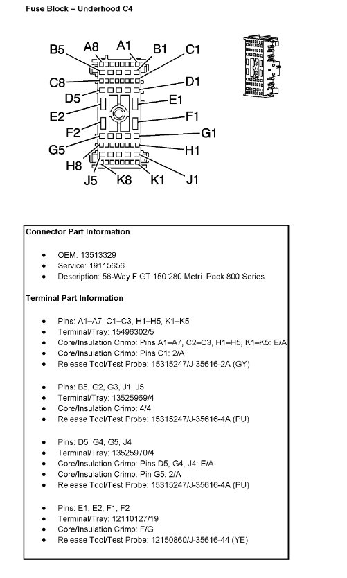

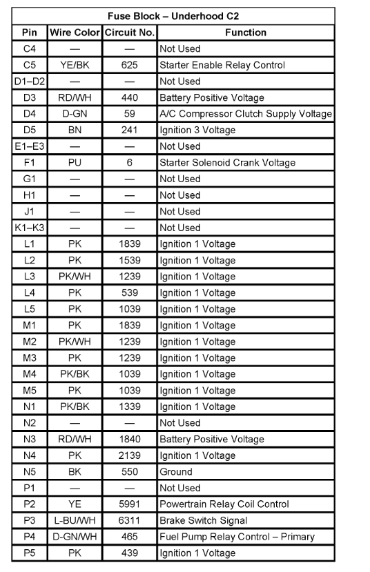

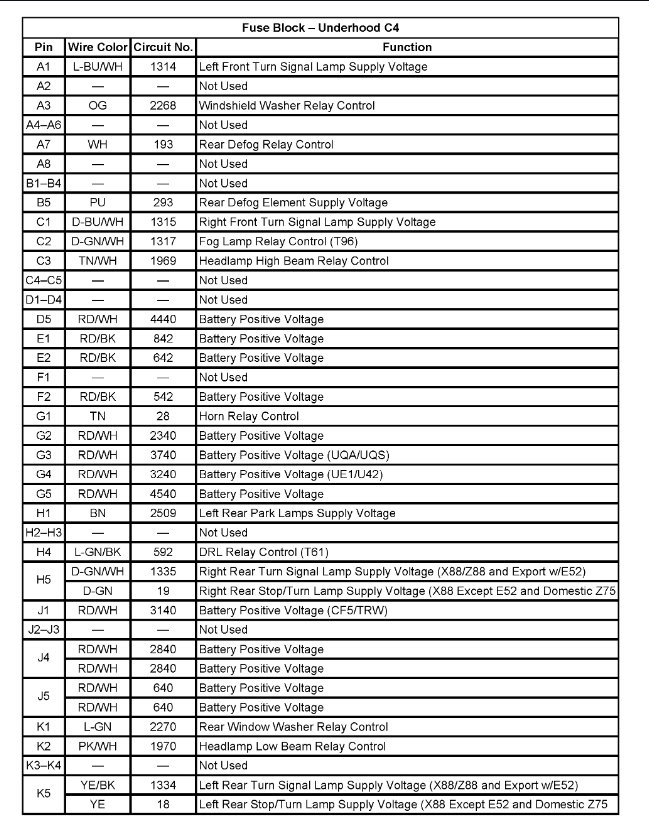

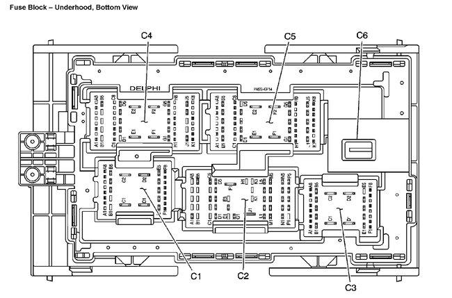

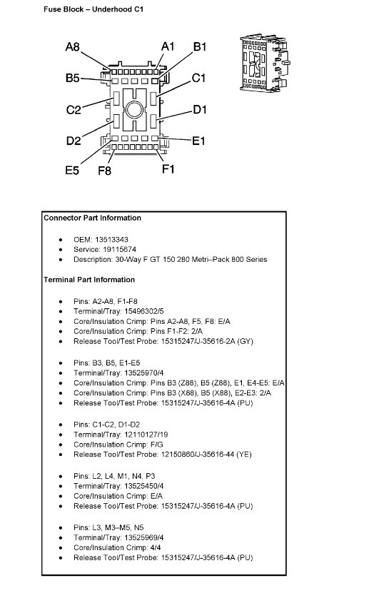

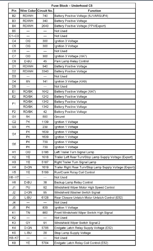

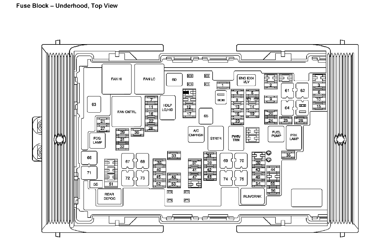

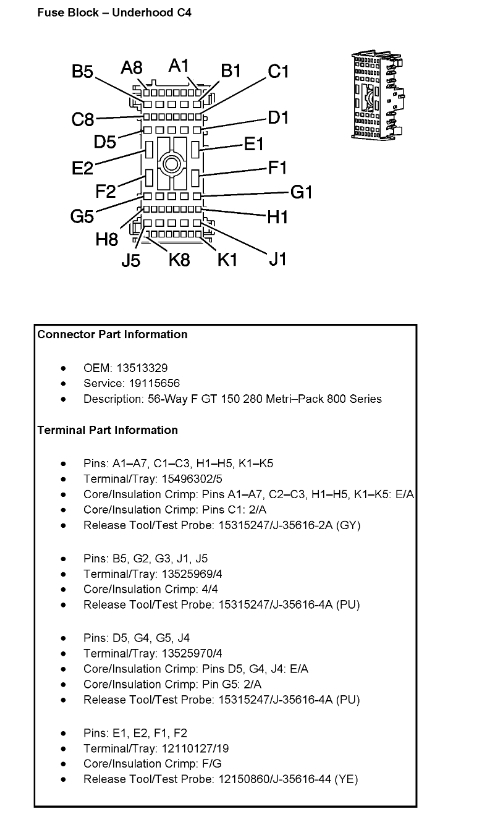

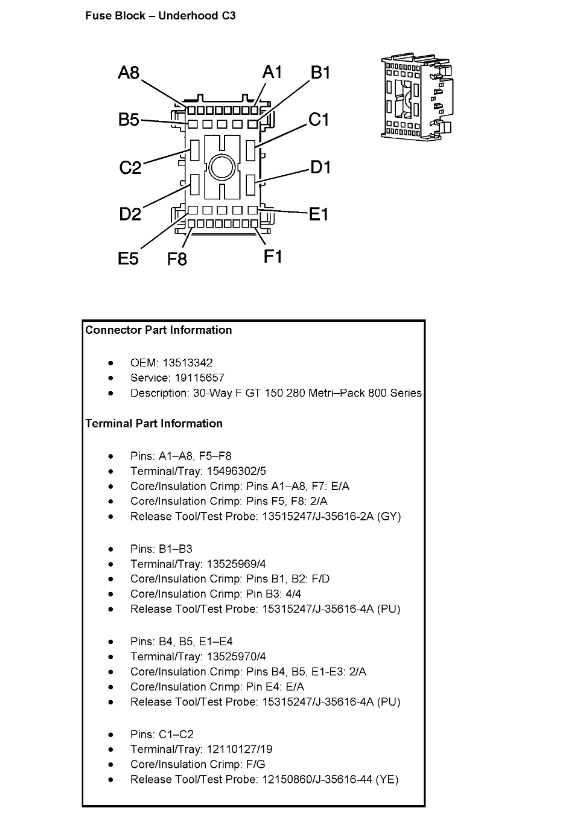

Can someone please help me with the diagrams I need for my wiring harness for my vehicle listed above? The connectors, the pins that hook up underneath the fuse block and also the ends that meet under that.

Sure, here are the under-hood fuse panel connector wiring colors and position diagrams in the images below. Let me know if you need anything else.
