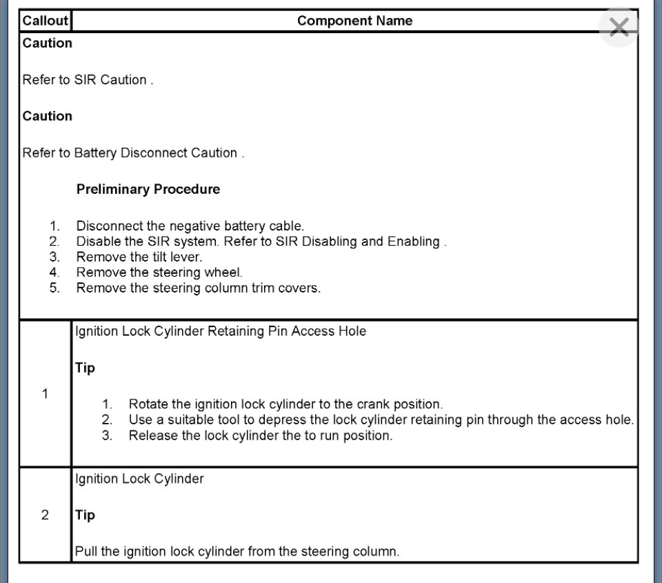

I changed the ignition. I put it back in and it won't move. I'm assuming when the tumblers is messed up but in order to change that ignition you have to be able to get it to turn over mine will not. How do I get it out or what do I do?

Just to be sure I understand, you replaced the ignition switch and not the cylinder. So now you put the key in, and it will not turn?
If that is the case, then we need to start with this guide to make sure we are not missing something that this covers.
https://www.2carpros.com/articles/ignition-switch-wont-turn-stuck

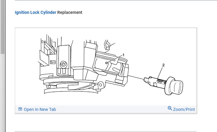

If these check out, then we need to most likely drill out the tumblers which will be the only way we are going to be able to get it to turn. Basically, once you drill this out then you will be able to freely turn the cylinder which will allow you to remove it.
I attached the process below on the replacement in case you need it.
