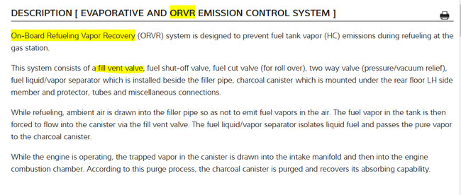

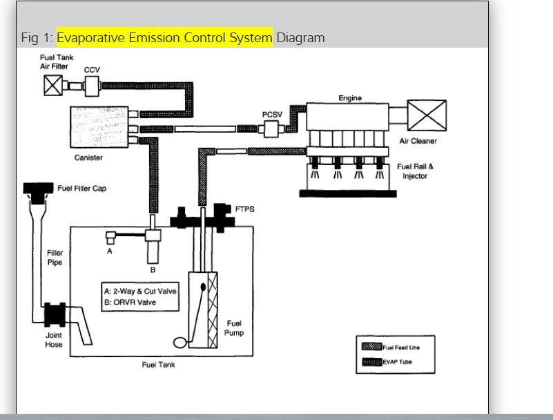

I have the vehicle listed above 2.7 engine. every time I go to the gas station and put the nozzle in my tank it will only let me put in a little under a gallon of gas and then it spits the rest out as in it over fills. is there anyone out there that you can't pinpoint me in the right direction to sell this issue? thank you
Jul 21, 2019 at 11:33 AM
SCGRANTURISMO
  • CAR REPAIR CONTRIBUTOR
  • 4,897 POSTS
This could be a problem with your vehicle's Fuel Fill Vent Valve. In the diagrams down below I have included a description and a diagram of your vehicle's EVAP system. Please go through this guide and get back to us with what you are able to find out.

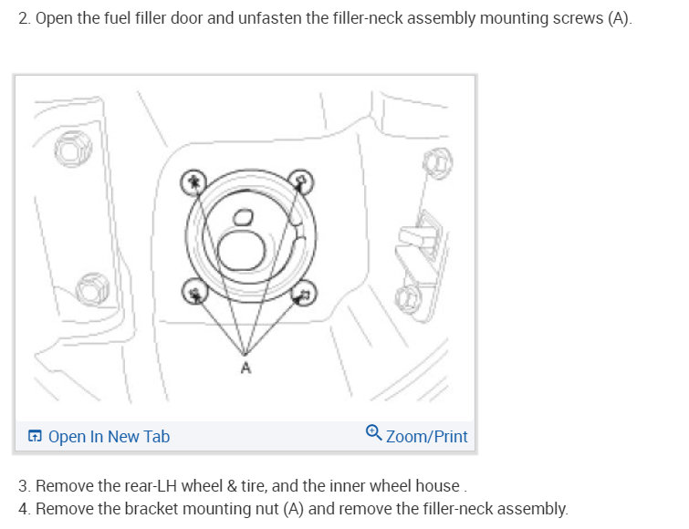

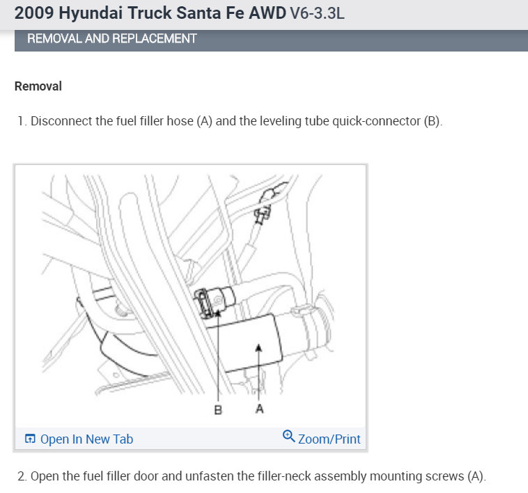

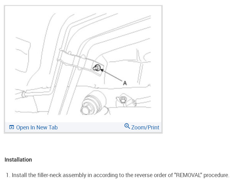

Thank you Alex but do I have to drop my tank to get to this
Jul 21, 2019 at 8:53 PM
  • 54,189 POSTS
No you don't here are the instructions on how to replace the filler neck. Check out the diagrams (Below). Please let us know what happens.
