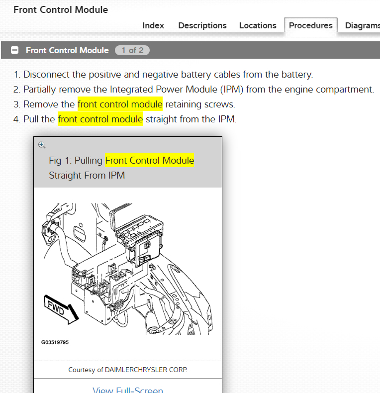

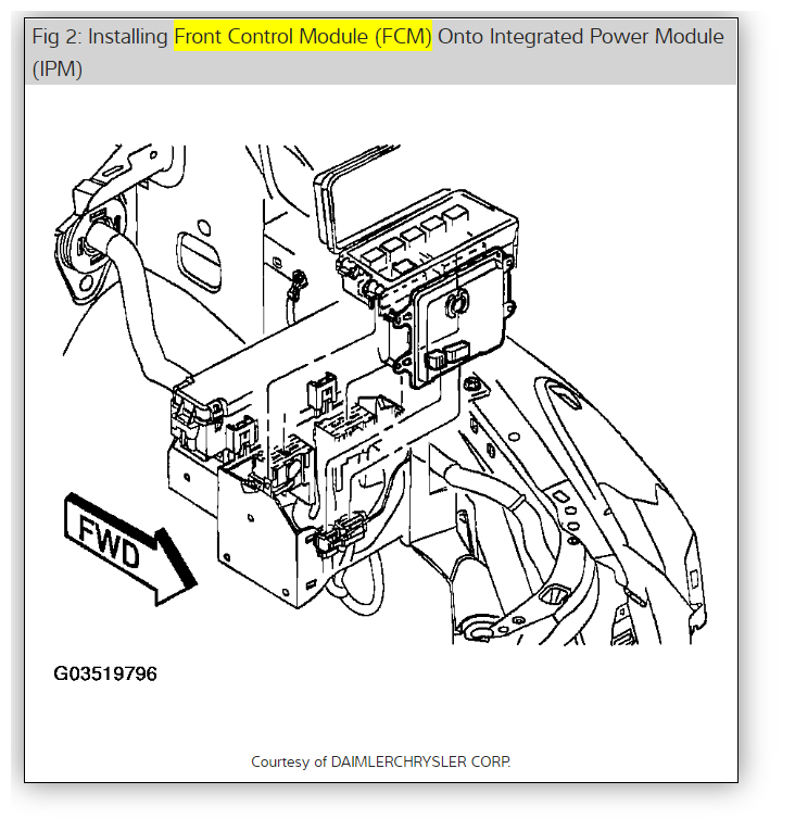

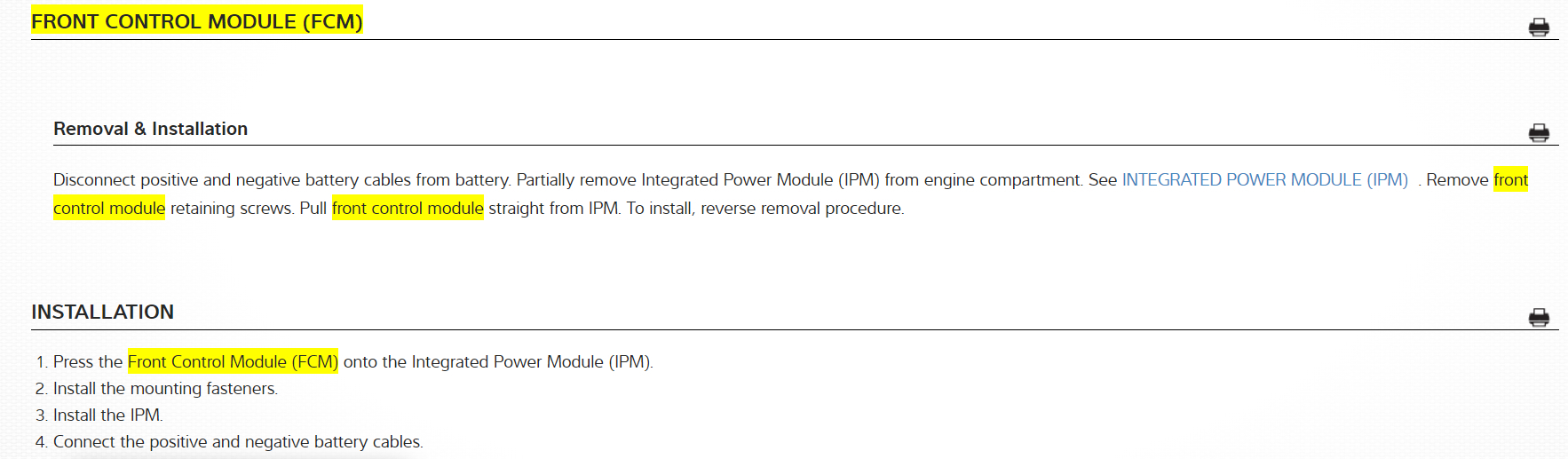

It sounds like the front control module is out. To be sure here is a video on how to scan the CAN system which is the future of car repair which you can get a scanner for about $50.00 and the instruction on how to replace the FCM in the diagrams below. The unit self initializes so its easy to replace.
https://youtu.be/InIlnsjOVFA
