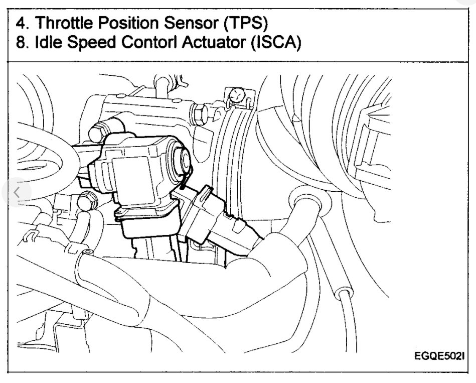

How to install throttle position sensor
Friday, May 21st, 2010 AT 6:35 PM

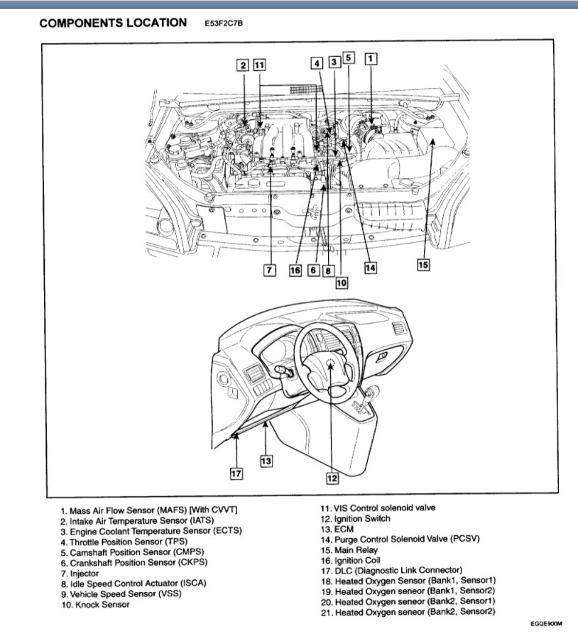

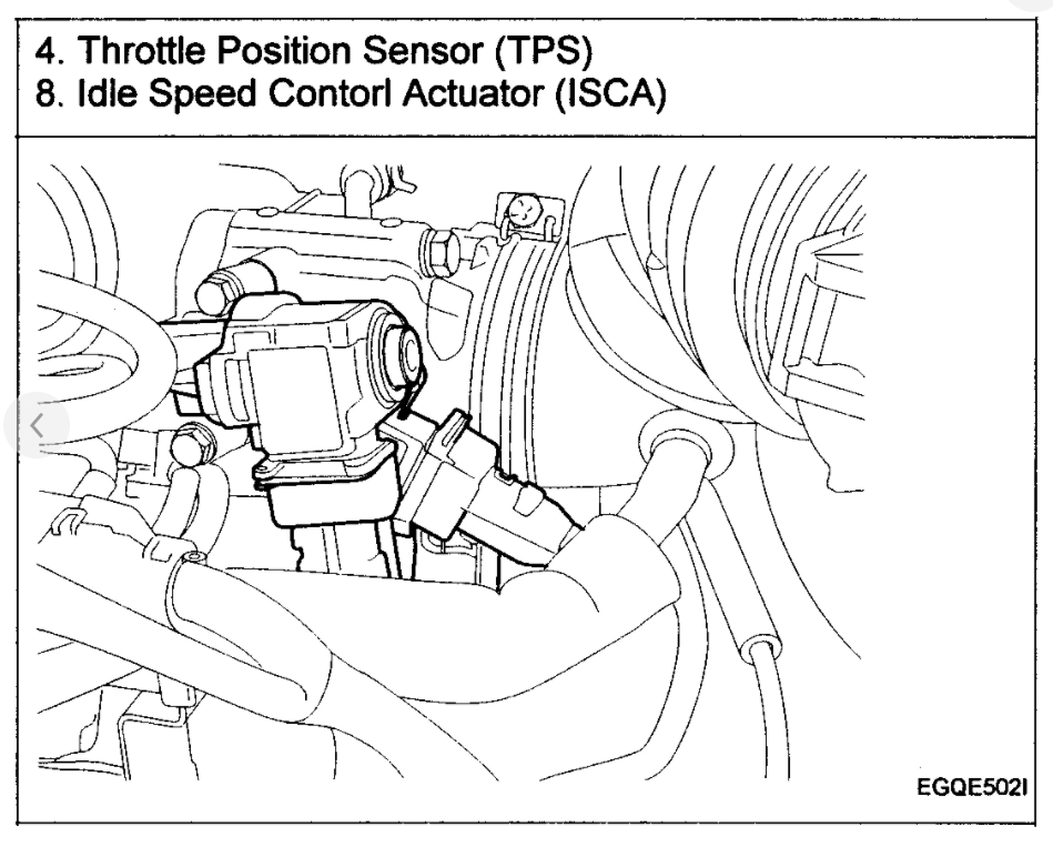

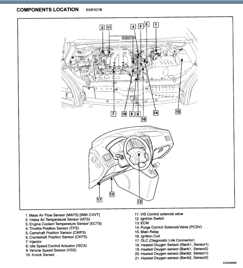

The throttle position sensor is on the throttle body of this vehicle.

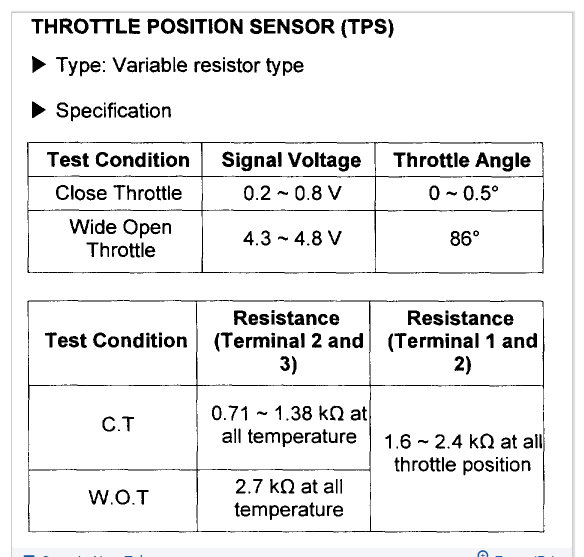

I am attaching info below but here is some useful info on this system as well
https://www.2carpros.com/articles/how-a-throttle-body-works
I attached the info below on this system with the location and the parameters to test it.
Please let us know what other questions you have. Thanks
