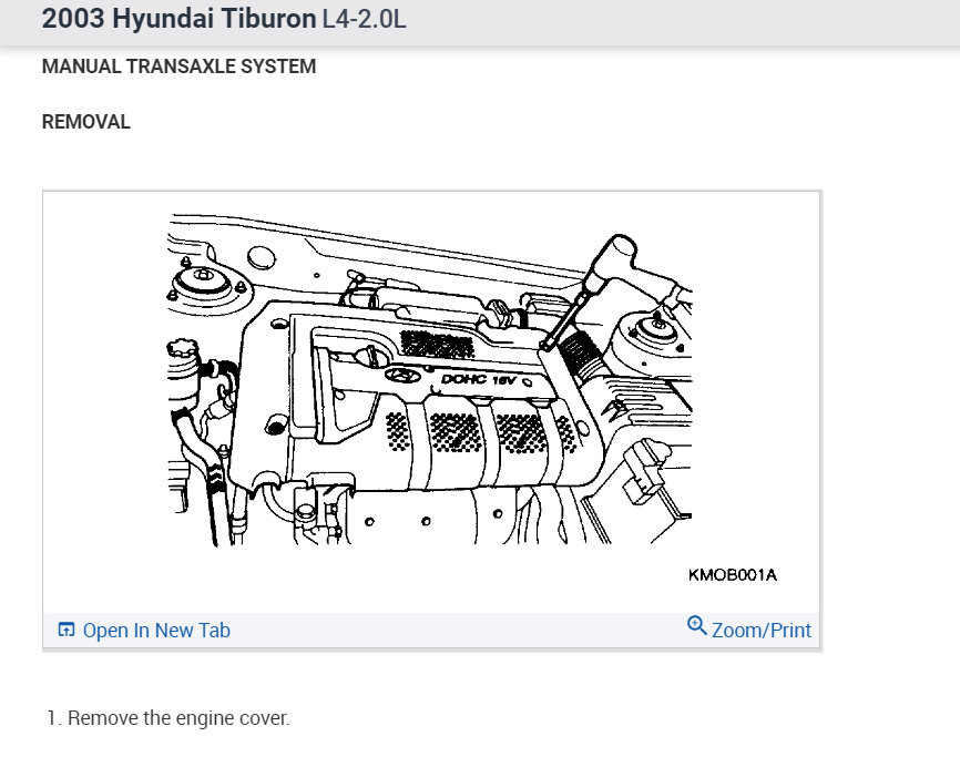

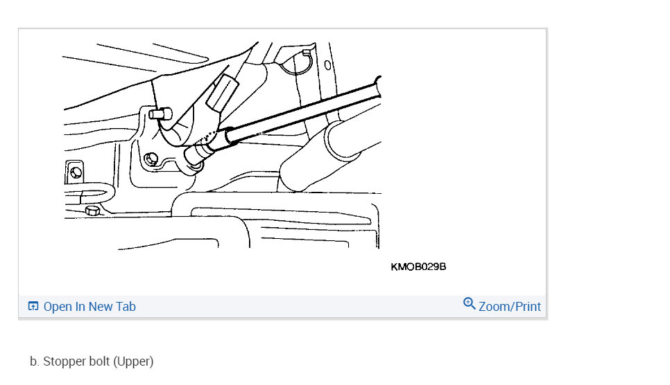

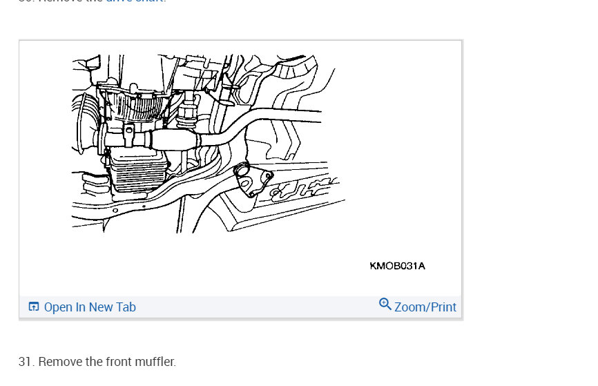

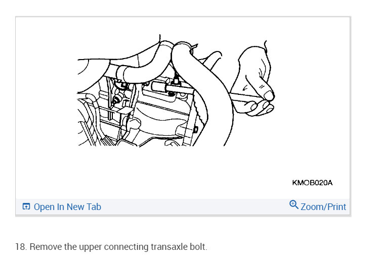

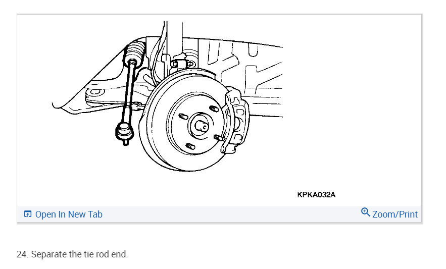

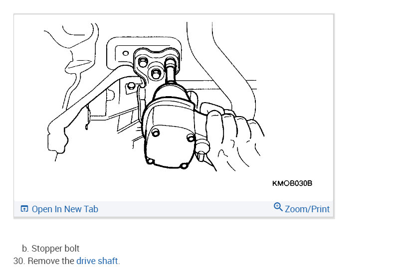

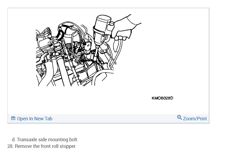

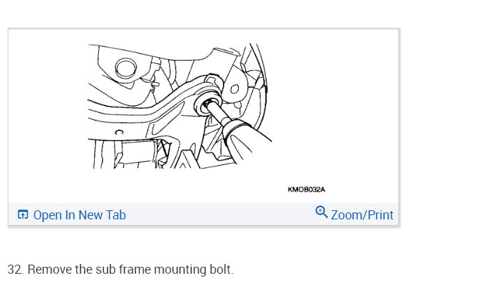

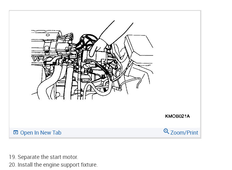

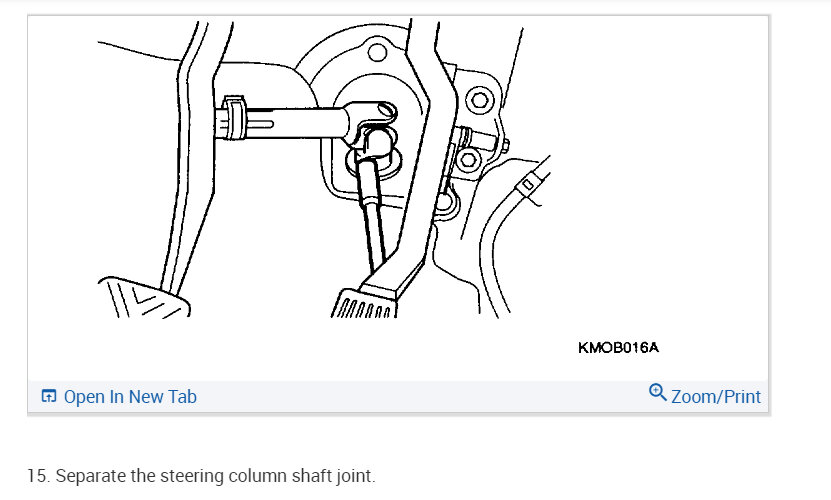

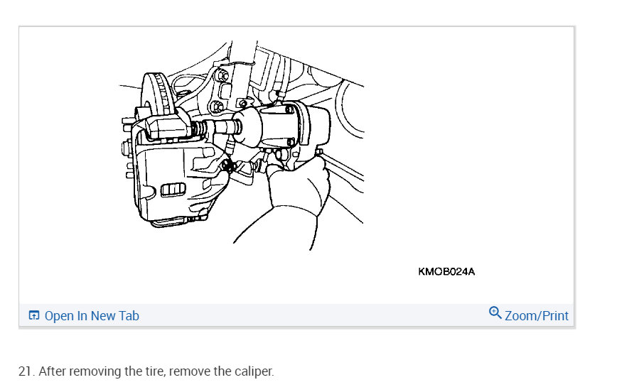

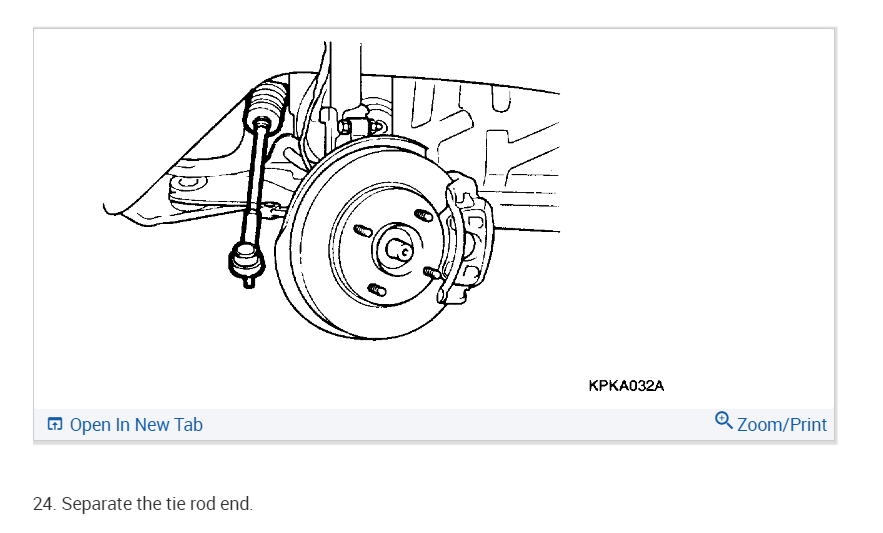

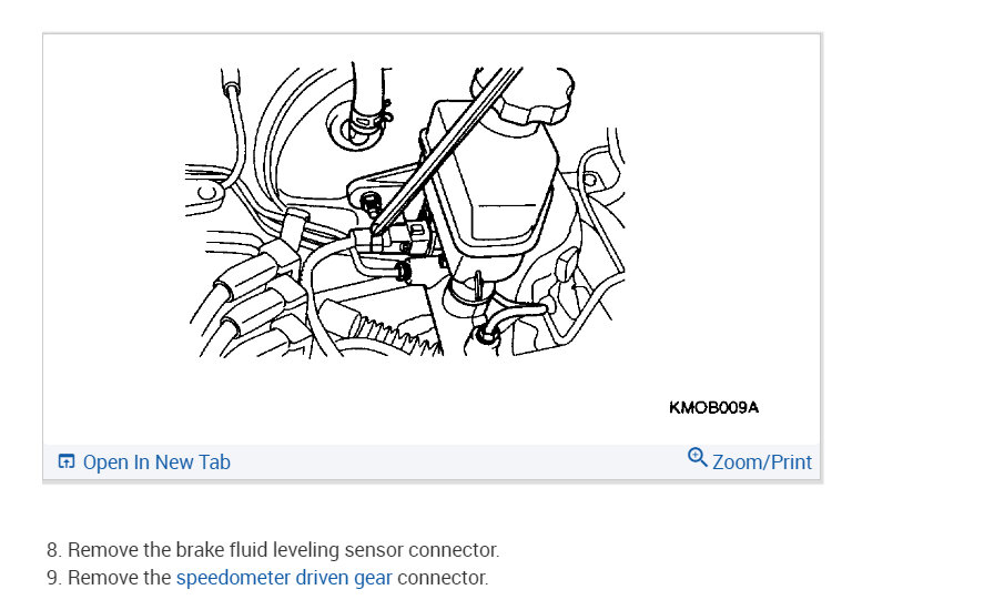

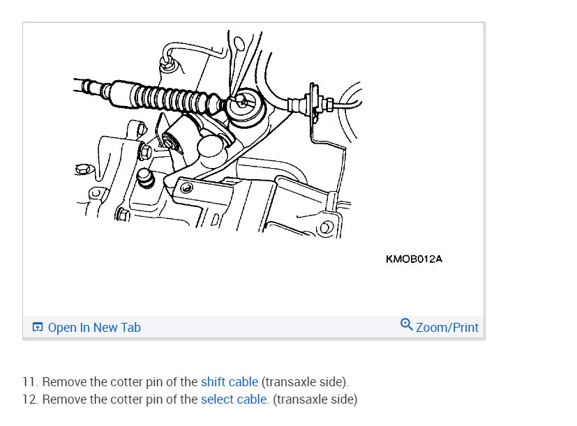

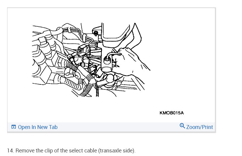

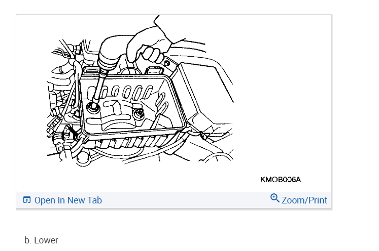

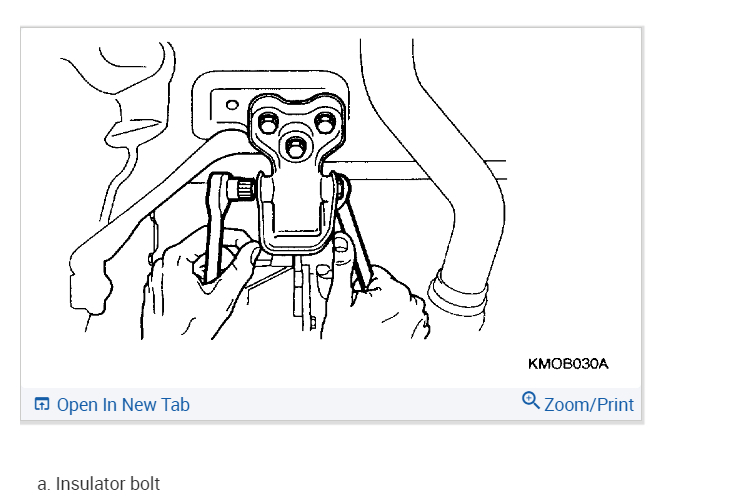

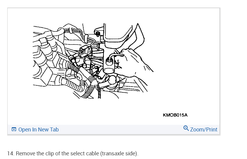

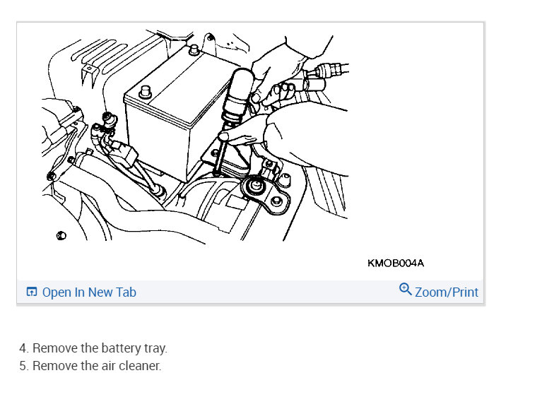

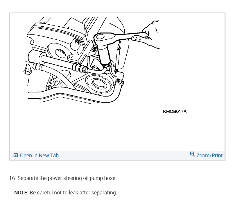

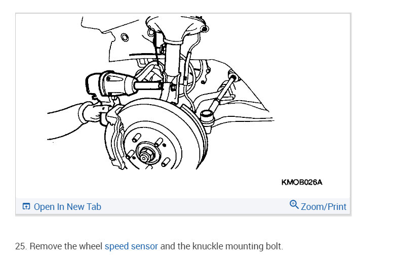

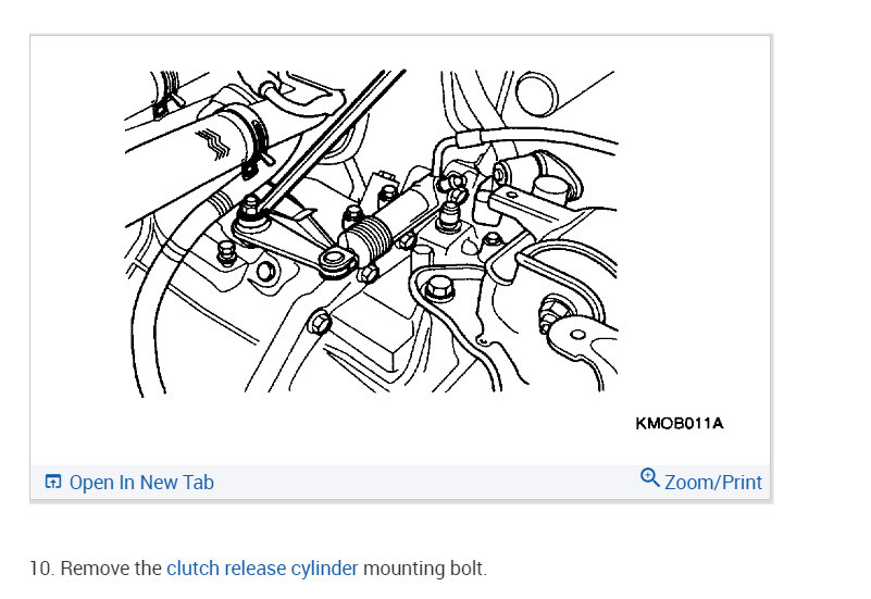

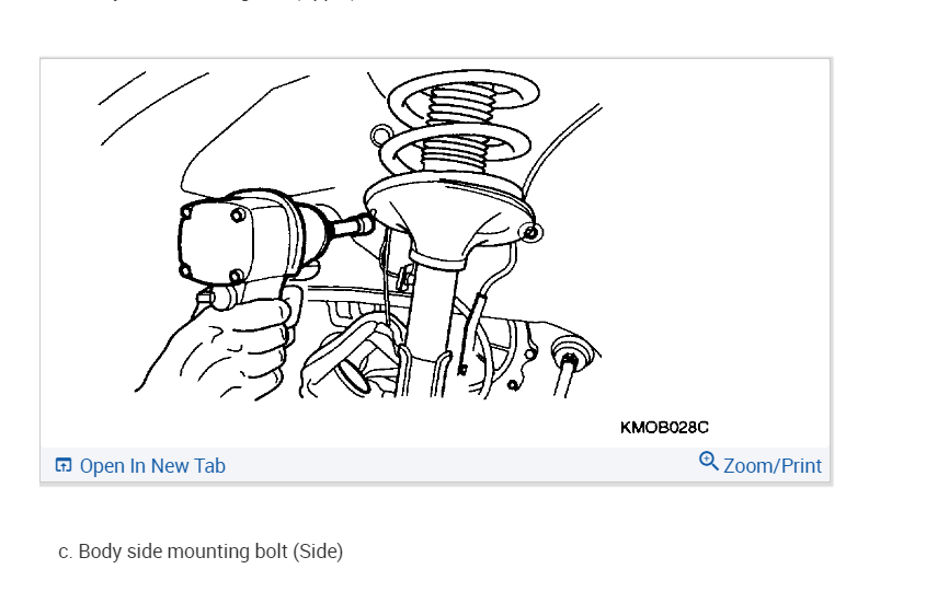

2003 hyundai tiburon gt r/r clutch Need help on where to find step by step info on how to remove the clutch Any help will be helpful Thanks Robert
Jun 18, 2010 at 1:13 PM
KHLOW2008
Experienced Mechanic
41,812 POSTS

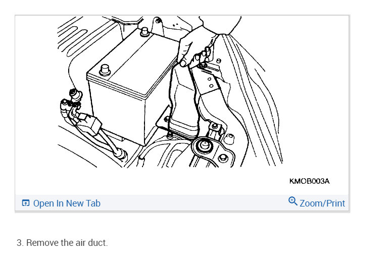

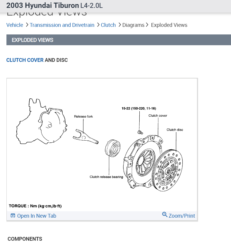

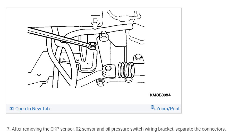

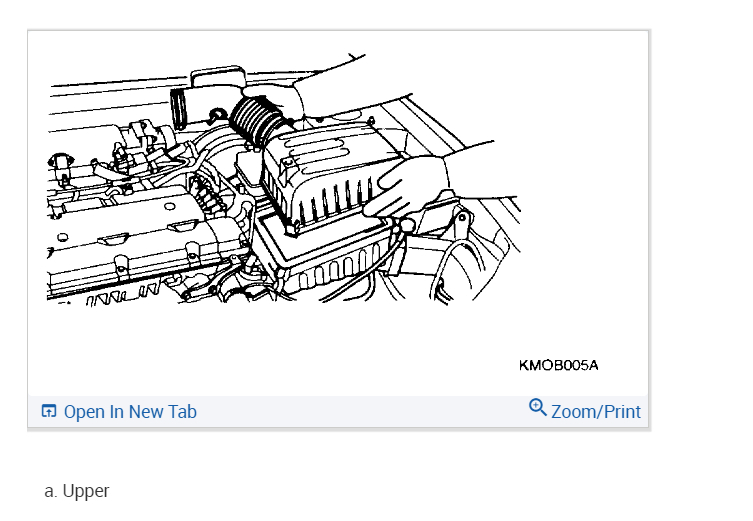

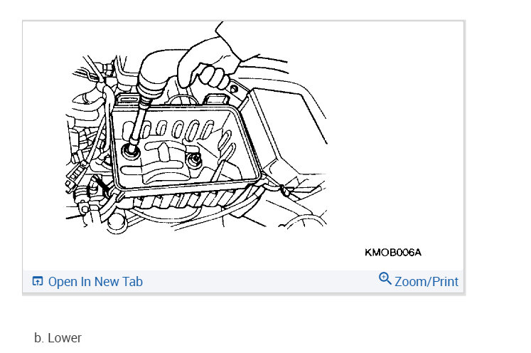

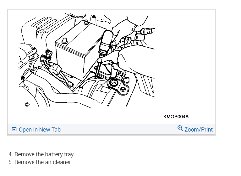

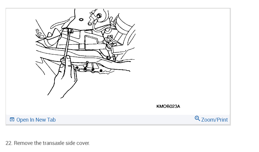

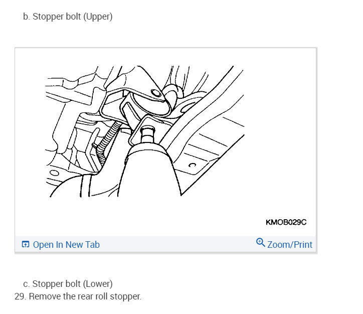

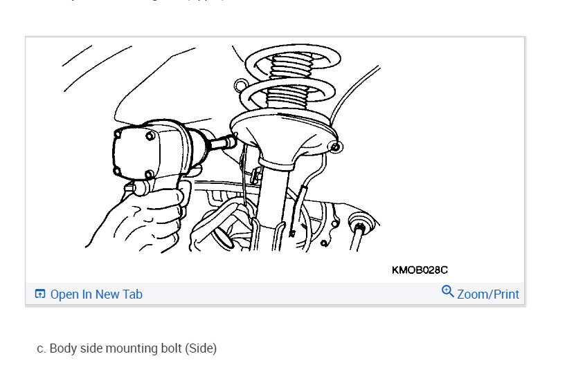

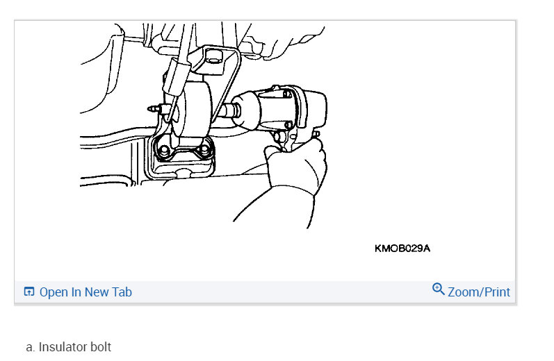

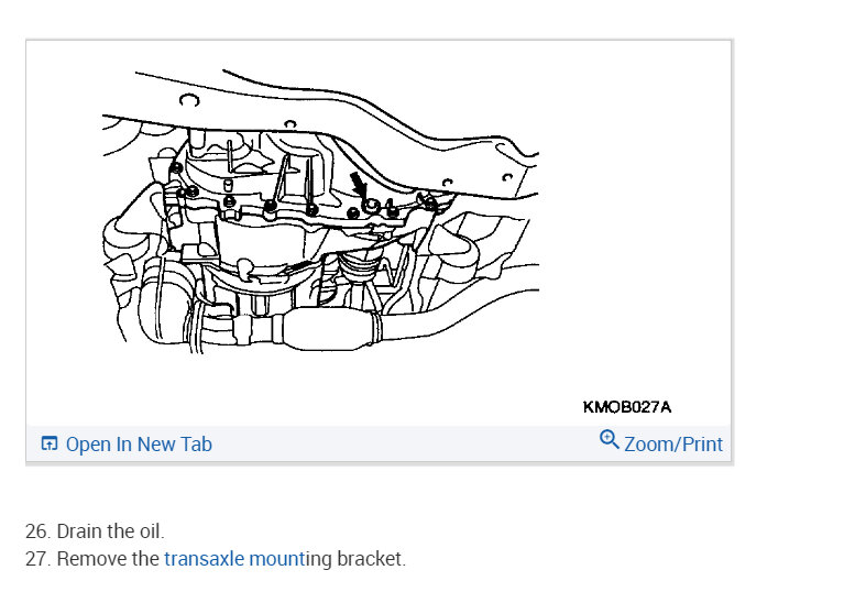

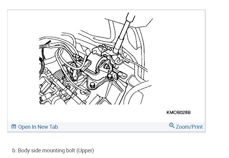

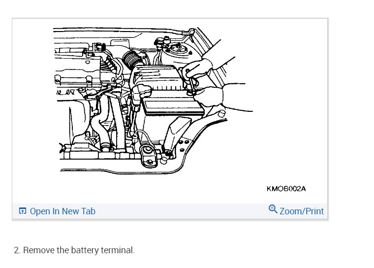

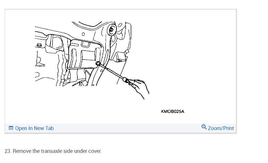

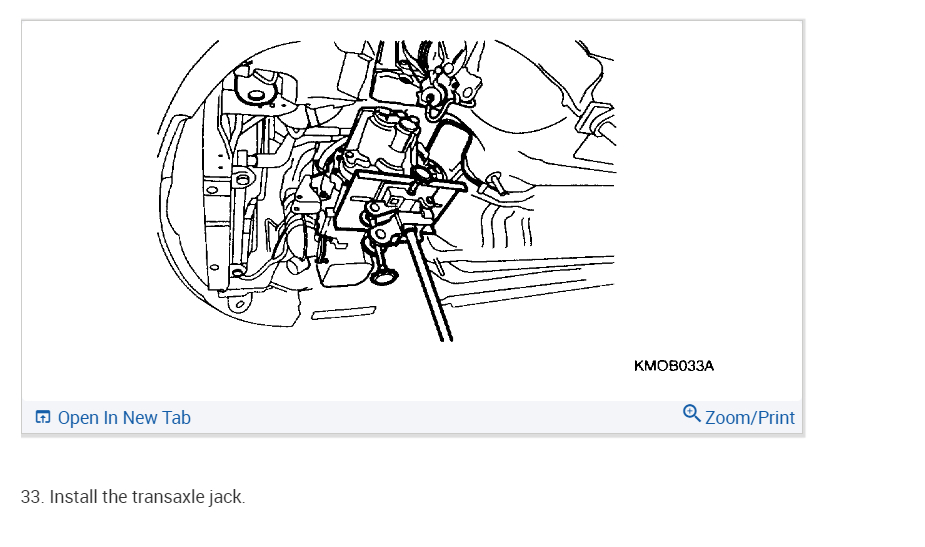

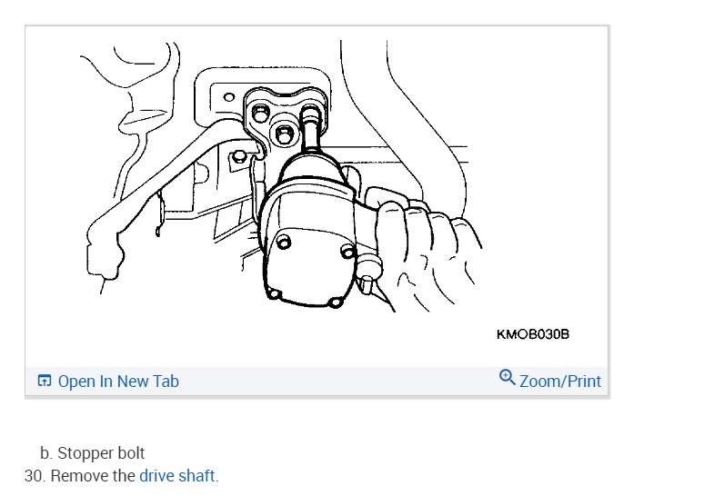

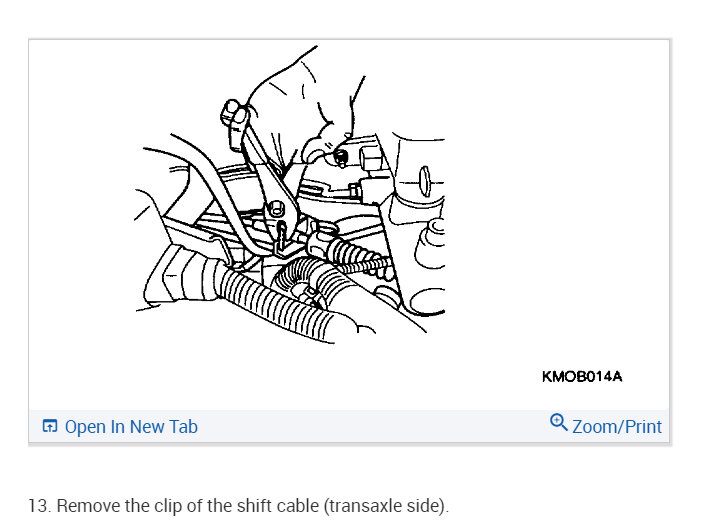

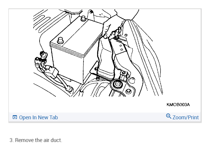

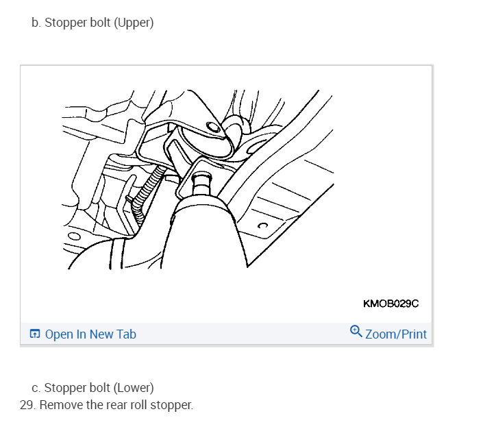

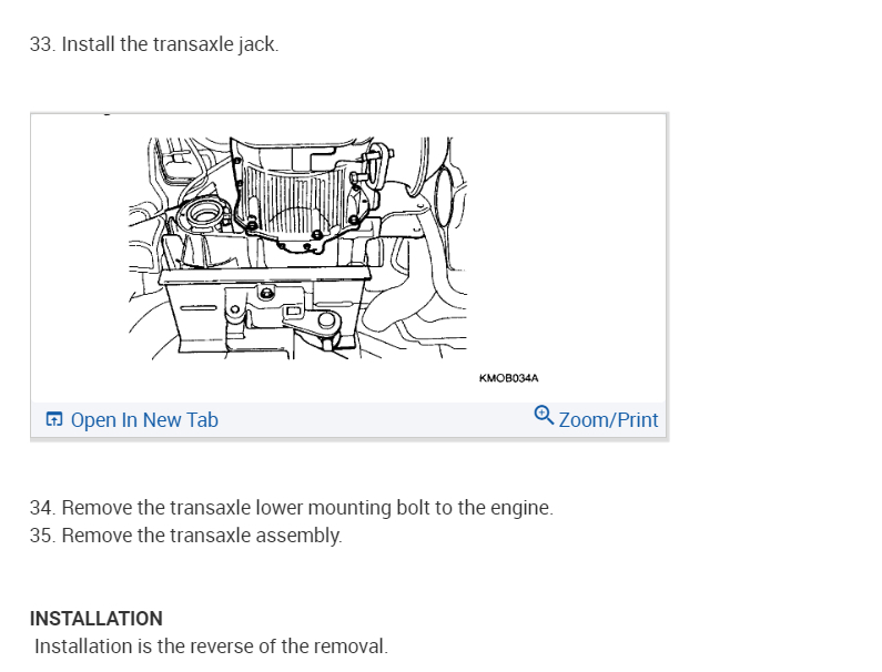

Hi Robert,

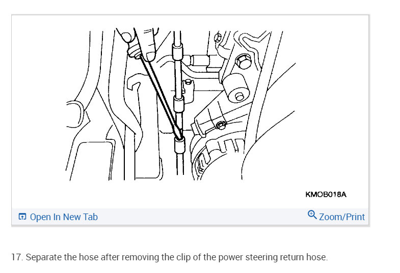

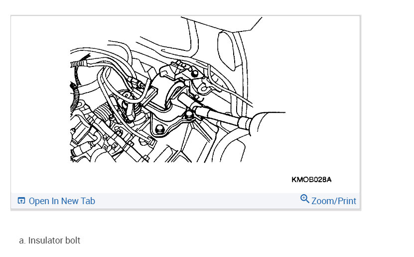

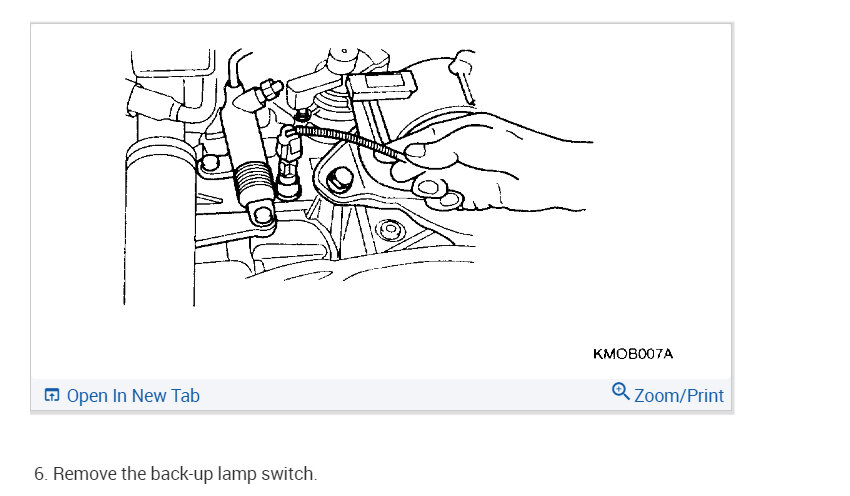

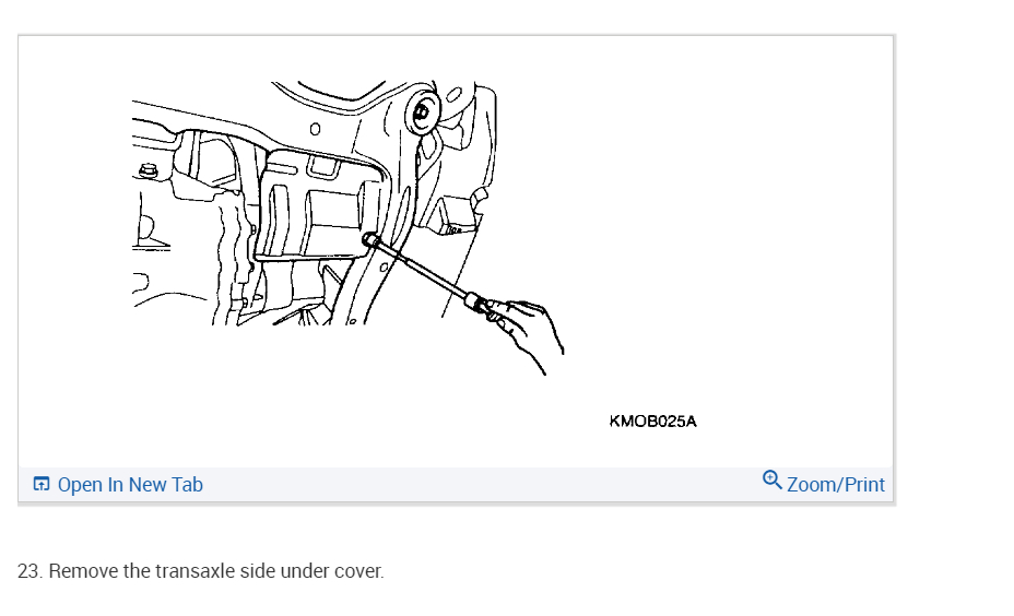

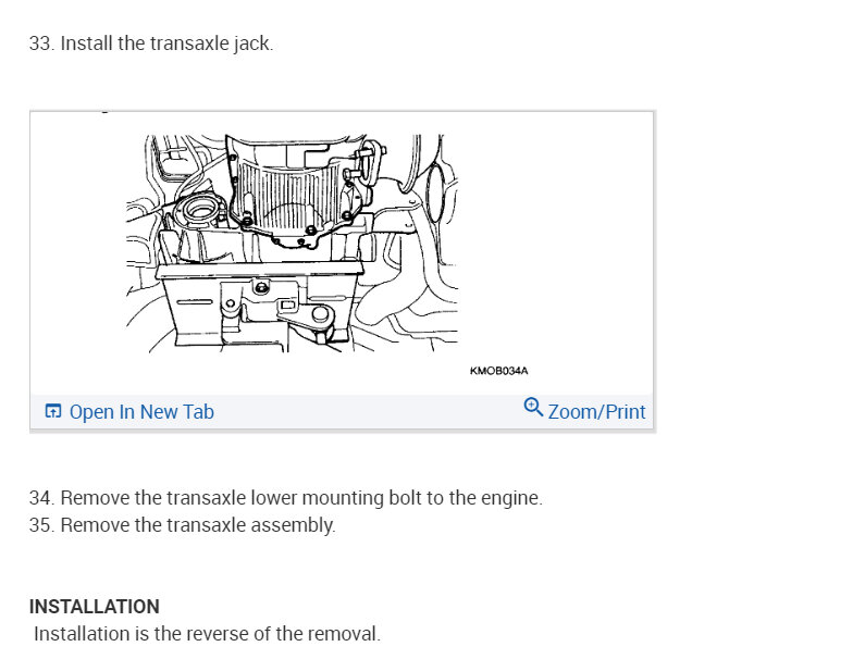

Here is a video of the job being done on a similar car and I have included instructions for you car in the images below.
https://youtu.be/6N6b5F2ChyE
Check out the images (Below). Please let us know if you need anything else to get the problem fixed.
Images (Click to enlarge)
