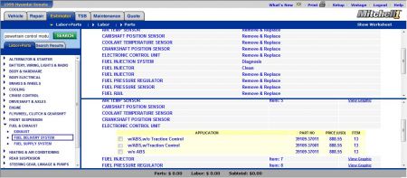

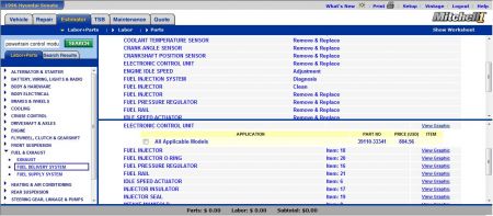

Hi would anyone know where the computer is situated in a GLE 1999 sonata, also if a 1996 model computer is compatable with the 1999 car.

Behind center console, under the radio.
96 and 99 ECMs are not compatible.

Engine Control Module (ECM) (2.5L)Behind lower center of dash
Engine Control Module (ECM) (M/T) (2.4L)Behind lower center of dash
Its not compatible See below P/N
