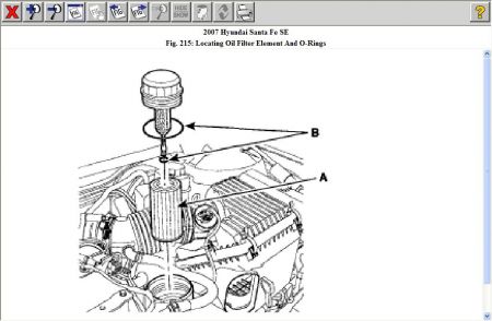

Oil Filter location
2007 HYUNDAI SANTA FE
8,000 MILES • 6 CYL • FWD • AUTOMATIC
D. THORSEN
I cannot locate the oil filter on the 3.3 engine of my 2007 Santa Fe

https://images.2carpros.com/forum/automotive_pictures/192750_OilFilter07SanteFe_1.jpg

Should the cap on the filter housing just unscrew? I turned it anti-clockwise and heard a clicking sound. It didn't seem to loosen up.

Yes, the cap is opened turning anti-clockwise. There is an O ring which which acts as a sprng so it would only loosen up after a little turn. The clicking noise that you heard should be the cover loosening up.

[quote:26a4db41c5="KHLow2008"]Yes, the cap is opened turning anti-clockwise. There is an O ring which which acts as a sprng so it would only loosen up after a little turn. The clicking noise that you heard should be the cover loosening up.[/quote:26a4db41c5]
Thanks, I'll try it again.
