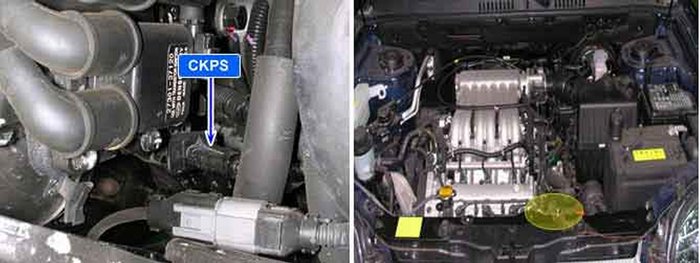

HMAC300
  • 48,601 POSTS
Here are some pictures that should help you:

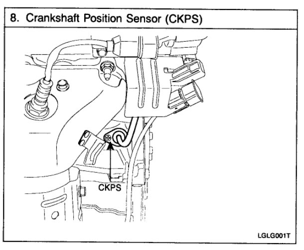

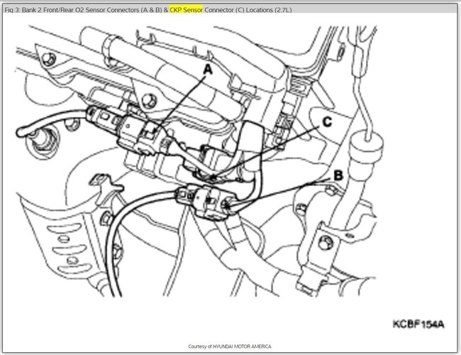

WRENCHTECH
  • 20,761 POSTS
The crankshaft sensor is in the side of the block, behind the exhaust manifold.
https://www.2carpros.com/images/external/139983558.gif
Part#
391803E100 $74.27
Thursday, December 29th, 2016 AT 6:32 PM (Merged)
KEN L
  • MASTER CERTIFIED MECHANIC
  • 55,512 POSTS
Hey MUSA,
The crankshaft position sensor is in the side of the block, behind the exhaust manifold.
Here is a diagram to help you locate it:
Please let us know what you find so it will help others.
Best, Ken

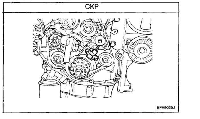

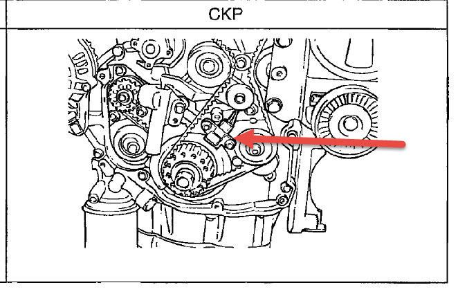

MANOLO GONZALEZ
  • 2003 HYUNDAI SANTA FE
Four cylinder front wheel drive manual.

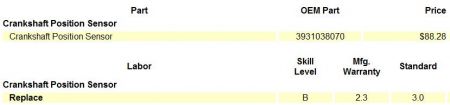

Where is the crankshaft position sensor and how long does it take to replace on a 2.4L?
Thursday, December 29th, 2016 AT 6:33 PM (Merged)
  • 75,992 POSTS
https://www.2carpros.com/forum/automotive_pictures/12900_ckp_1.jpg
https://www.2carpros.com/forum/automotive_pictures/12900_ckpp_1.jpg
Note:Part and labor may vary within location.
https://www.2carpros.com/kpages/auto_repair_manuals_alldata.htm

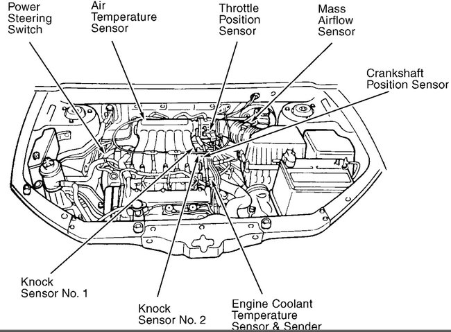

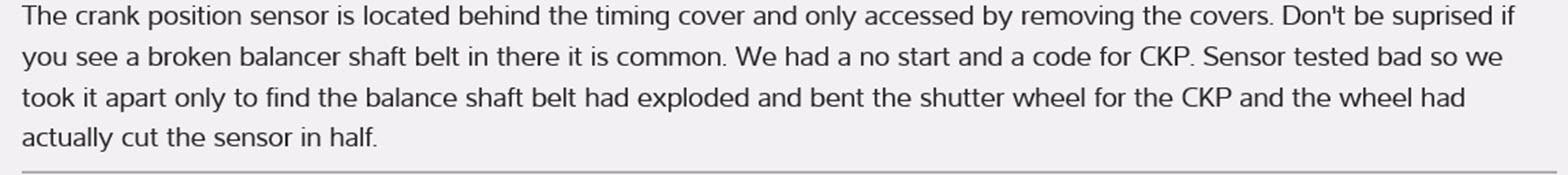

MCAVINEE
  • 69 POSTS
  • 2.7L
  • V6
  • 2WD
  • 175,000 MILES

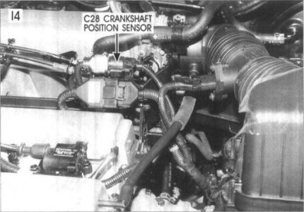

My SUV suddenly would not shift into second gear going down the highway. I babied it home and noticed also that placing it in reverse the engine immediately quit. Idle the car and it is fine. Placing it in drive it jumps. So I took out my computer check tool and it said the crankshaft sensor was bad.
So I guess I need to know where this is located on the engine? Thanks, Mark
+1
Thursday, October 12th, 2017 AT 3:11 PM (Merged)
HMAC300
  • 48,601 POSTS
I doubt it is your crank sensor, but here is location in picture. If it still does it have a transmission professional check it. It may be a governor or in need of transmission rebuild.
-1
MCAVINEE
  • 69 POSTS
Reason I said the sensor is my tester gave me the p003 and said crankshaft position sensor. Somebody told me that I would have to remove the timing belt cover and crankshaft pulley. You are showing the sensor at the top of the engine?
-1
HMAC300
  • 48,601 POSTS
That is what our book says its location is.
