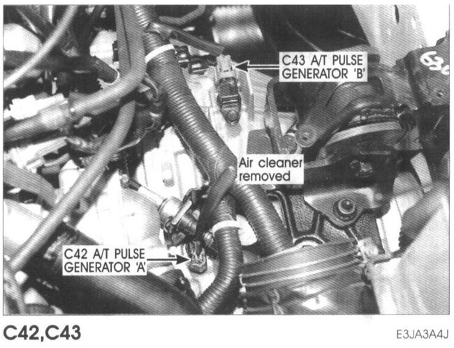

Code indicated speed sensor failure (hard shift). Purchased same from Auto Zone and cannot find anything like part on the transmission. Forum said "left side of transaxle" or "behind engine" - not much help. Part requires three wire lead from harness and found two such leads, but neither fits part. Checked again with Auto Zone to see if part is correct and they claim it is. Where is this thing?
