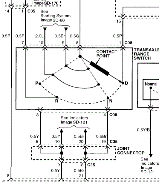

Hello, I want to know wiring. Trans-axle Range Switch With mention colors.

Good morning,
attached is the diagram you requested.
Image (Click to make bigger)
