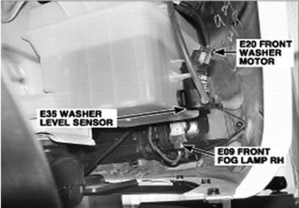

I was wondering if my 2007 hyundai elantra has a low washer fluid indicator light in the insturment cluster. It says it does have one in the owners manual and it does have it in the cluster but it doesnt light up when the fluids low. I mentioned it to the service department and they said it doesnt have one. Please let me know! Thanxs! Chris

yes it should have it..you can check easily though . just look at bottom of where you fill the washer fluid and check for sensor in pic below.. if its there you have it and if the bulb is not coming on and you are out of washer fluid then it's either a blown bulb in the instrument cluster or the sensor may be faulty.
https://images.2carpros.com/forum/automotive_pictures/261618_Noname_2050.jpg
