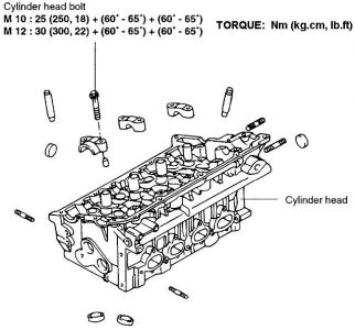

2003 Hyundai Elantra 4 cyl Front Wheel Drive Manual
Looking for the toque specs for cylinder head bolts.

https://images.2carpros.com/forum/automotive_pictures/55316_03elantraheadbolt_1.jpg
