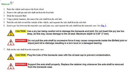

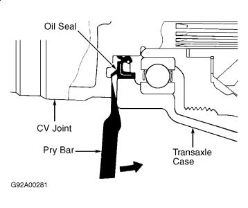

How do I replace & replace the cv joints? Will I need special tools to remove and install the cv joints?
Friday, March 27th, 2009 AT 9:29 PM
OBXAUTOMEDIC
  • 3,711 POSTS
As long as you are replacing the whole Axle and not just the joints, the only special tool you will need is a Axle Nut Socket. I am not sure exactly what size it is. But most oarts store can look up the Axle Nut Kit and tell you.
Here are the removal instructions... I will also email them to you for easier reading if you will send it to me....
