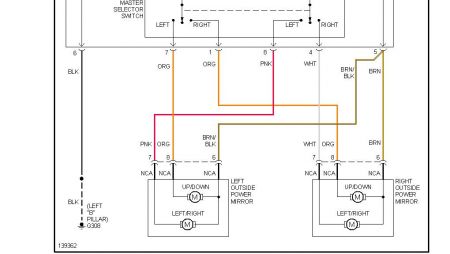

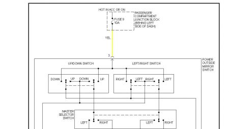

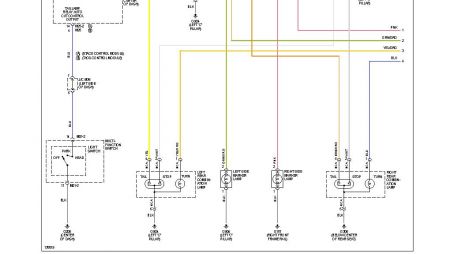

My 2001 elantra parking lights stay on or come on by
themselves when car is stopped. Also my rightside
power mirror changes it setting by itself. All this happens when ignition is off and car is parked. You come out and find the lights lit. Any clue?

For the power mirrors, it is not possible for it to happen as it receives power ONLY when ignition switch is in ACC or ON position, so this is baffling.

Lights will come on about 1 or 2 minutes after ignition is turned off. I remove fuse to shut them off otherwise I don, t have tail lights while driving at night or dash lights if I don't put it back in before driving. I don't have alarm system or remote start The mirror changes posiition while I'm driving or ignition is on only when the switch is in center position. I suspect corrsion on wires inside driver side door. Read about that somewhere. Also when I put fuse back in I see sparks when blades make contact with the connection. I don't think it should be hot when ignition is off. I guess you can tell I have been troubleshooting this for awhile. Anymore idea s will be appreciated. John

The taillights fuse is hot at all tiems so the ignition switch is not required to be on for it to operate. Either the taillight relay is stuck in the on position or you have a bad switch that is not turning off. Which fuse did you unplug?
https://www.2carpros.com/forum/automotive_pictures/192750_Taillight01Elantra01_1.jpg
https://www.2carpros.com/forum/automotive_pictures/192750_Taillight01Elantra01a_1.jpg
If the switch is at the central position, there should be no power supply to the mirrors therefore if the wiring harness are bad, it should not cause any problem unless power from another source is getting to the mirror circuit. I would suspect the switch to be the culprit.
https://www.2carpros.com/forum/automotive_pictures/192750_Mirror01Elantra01_1.jpg
https://www.2carpros.com/forum/automotive_pictures/192750_Mirror01Elantra01a_1.jpg
