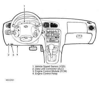

Where do I find the PCM and how do I replace it on my Hyundai Elantra 1999?
Thursday, June 17th, 2010 AT 5:46 PM
DOCFIXIT
MECHANIC
18,828 POSTS
ECM left of steering column
Before handling touch metal of car to discharge any static
