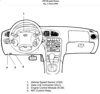

The main fuse going out should be due to a shorting somewhere and it can cause the ECM to go bad.
The ECM ( is known as ECM and not PCM as the transmission control unit is separated from it) is located at left side of dash.
https://www.2carpros.com/forum/automotive_pictures/192750_Dashcomp96ElantraFig02_1.jpg
