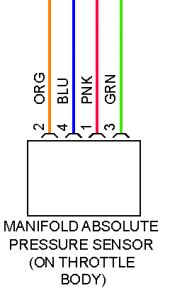

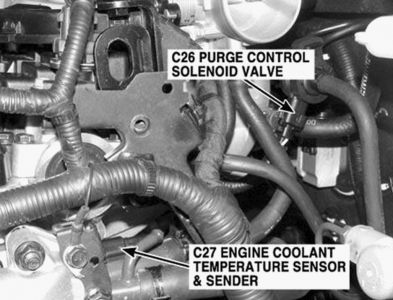

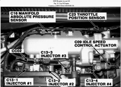

I have two sensors on my 2009 accent, one on the throtle control and the second one on the air intake manifold, wich one is the iat sensor and what color are the two wire to it ?? ......thanks

This one uses a MAP and has no IAT. Heres a few picts, But since these sensors are part of vehicle emmission and powertrain control, and Hyundai has their great warranty, why dont you bring it back to the dealer, it is covered?
