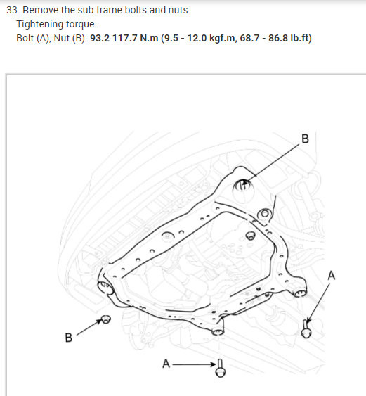

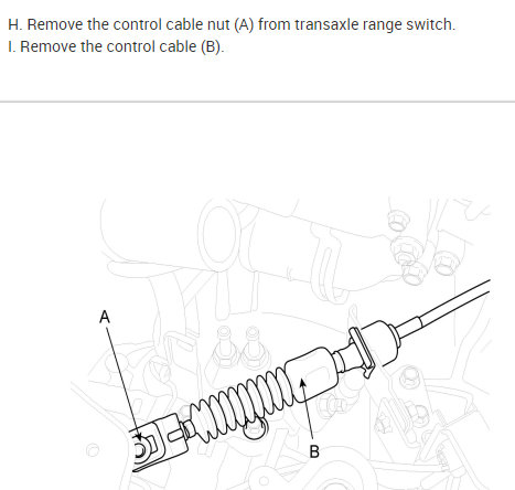

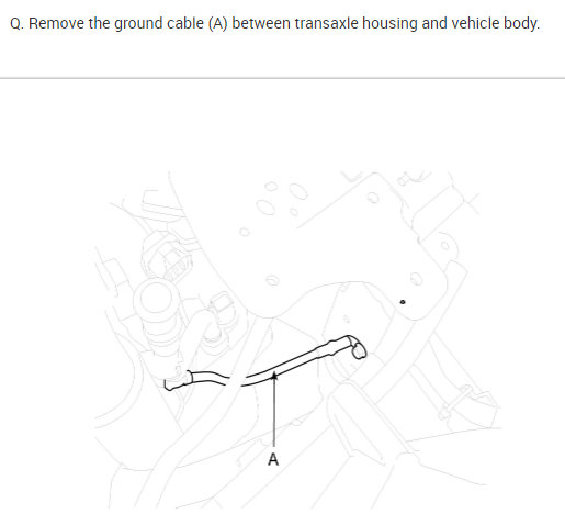

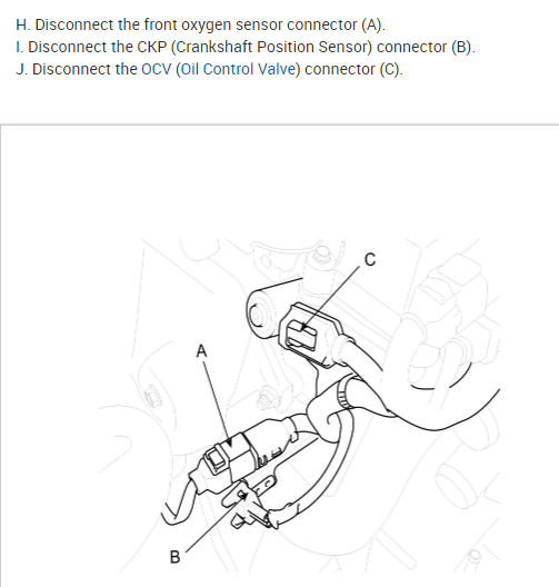

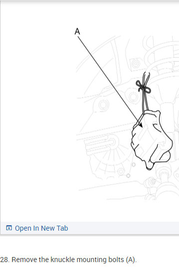

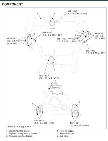

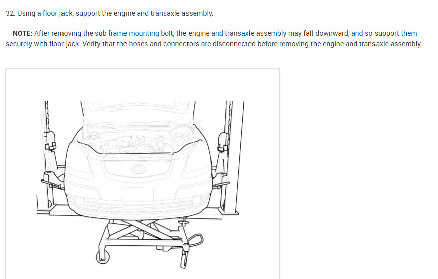

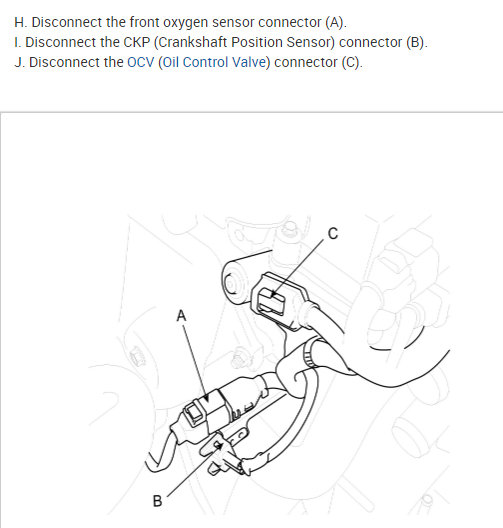

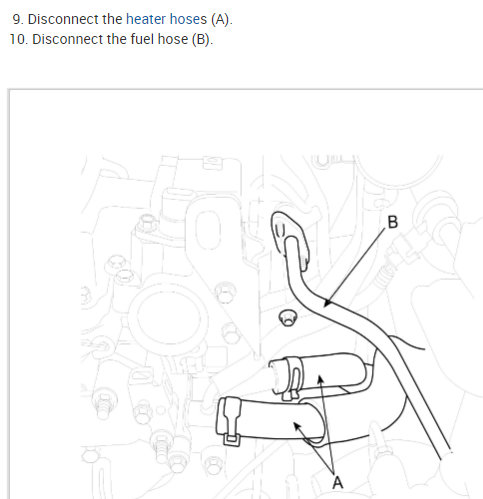

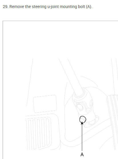

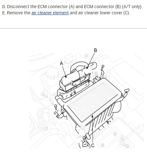

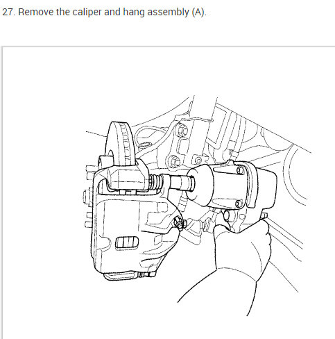

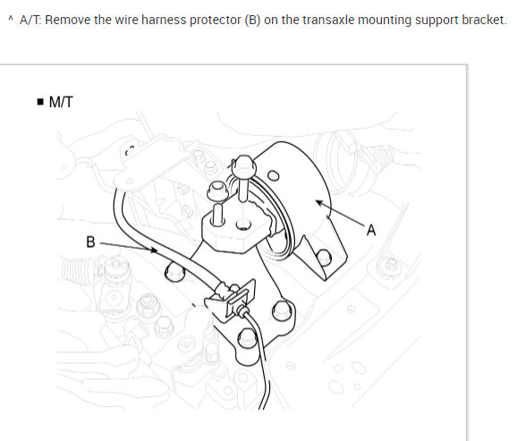

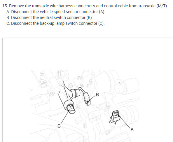

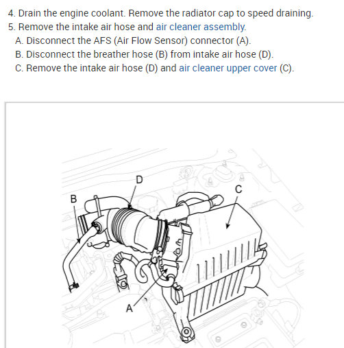

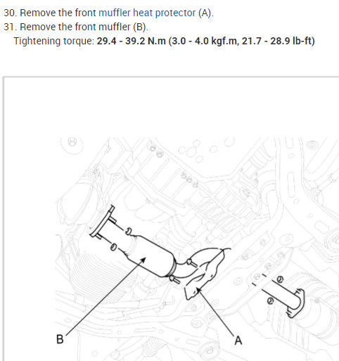

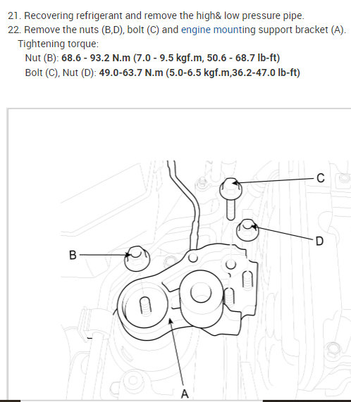

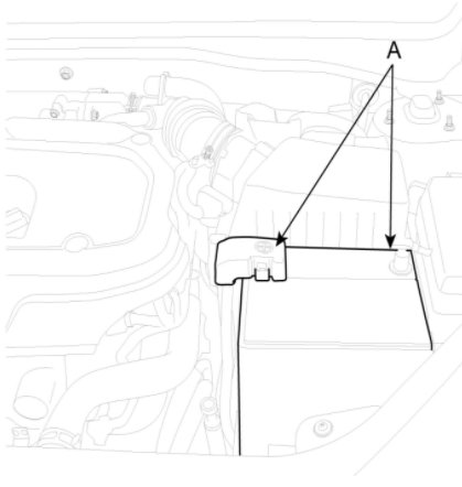

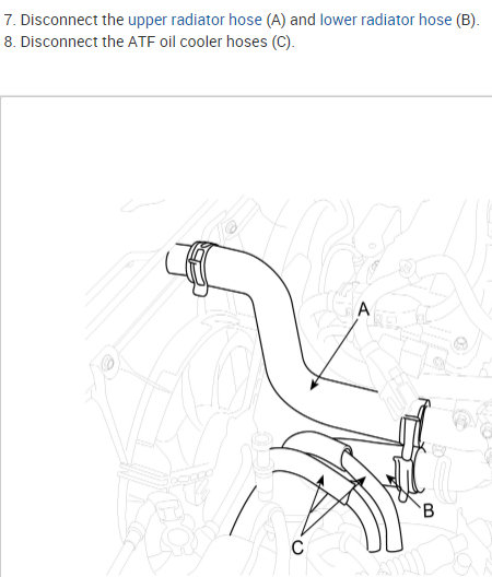

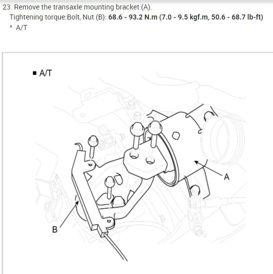

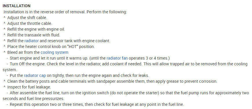

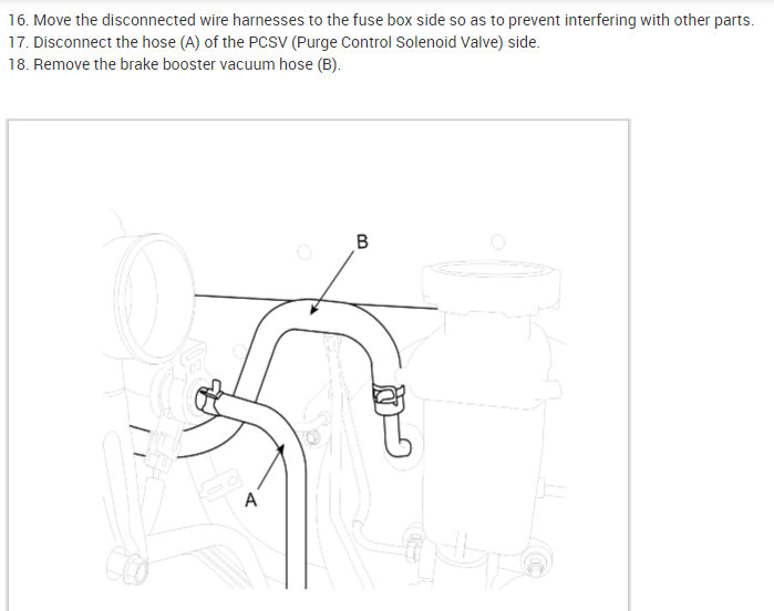

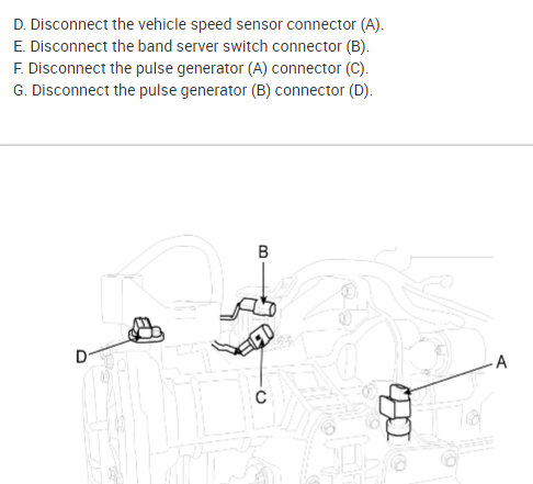

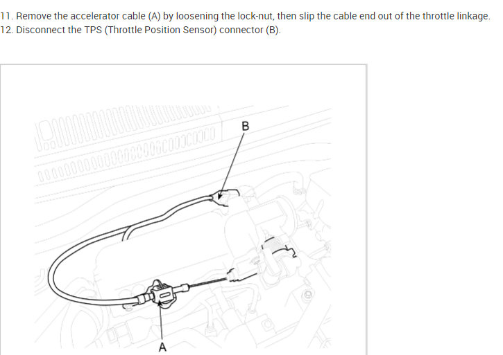

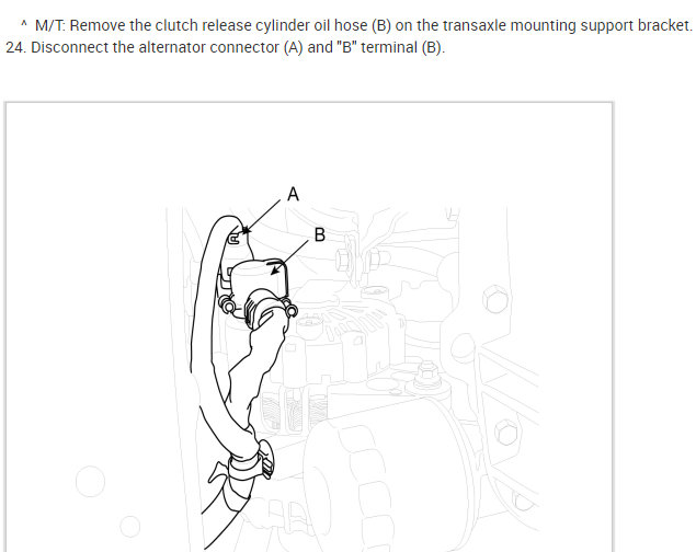

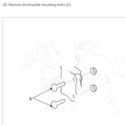

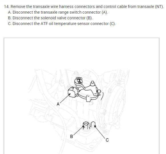

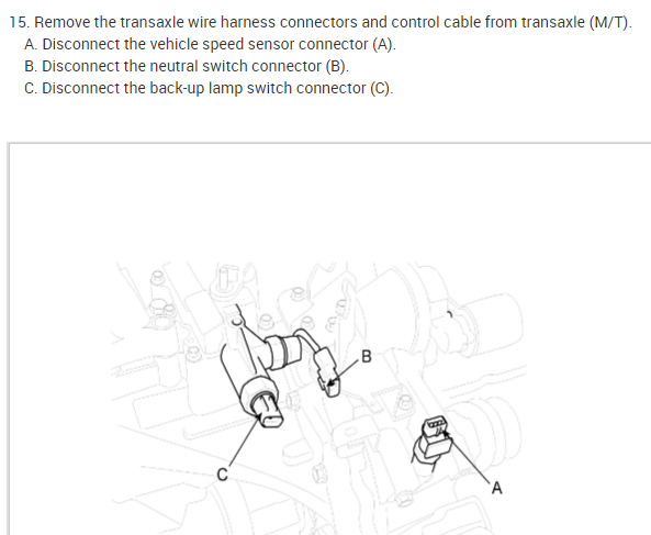

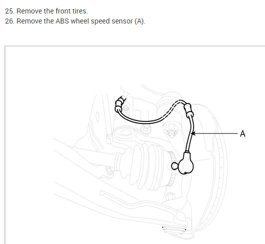

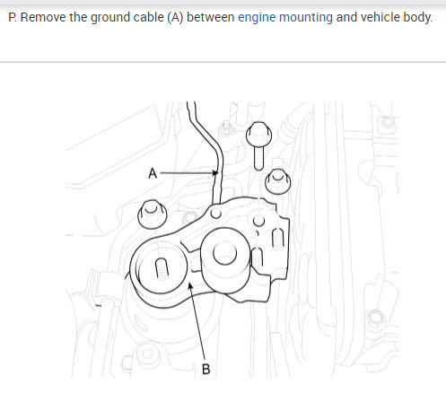

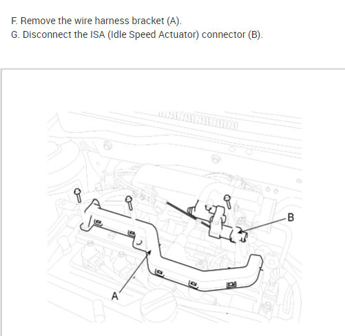

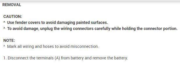

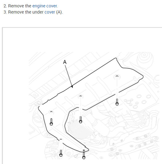

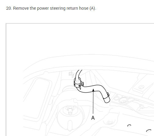

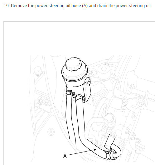

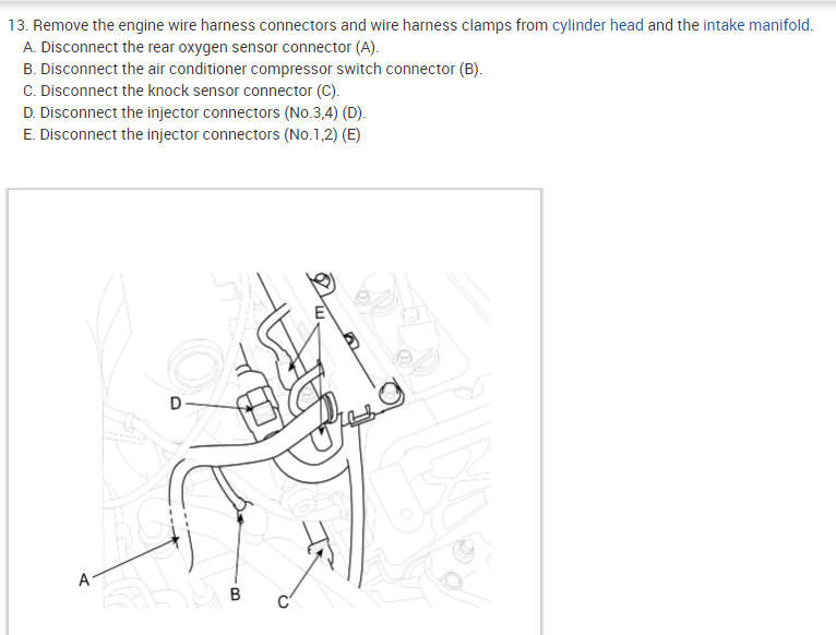

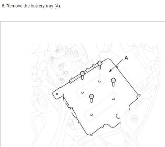

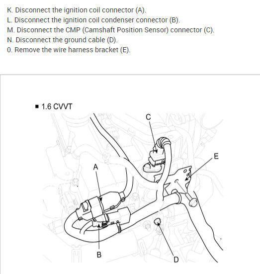

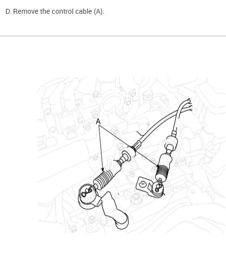

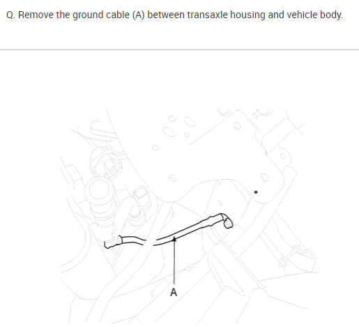

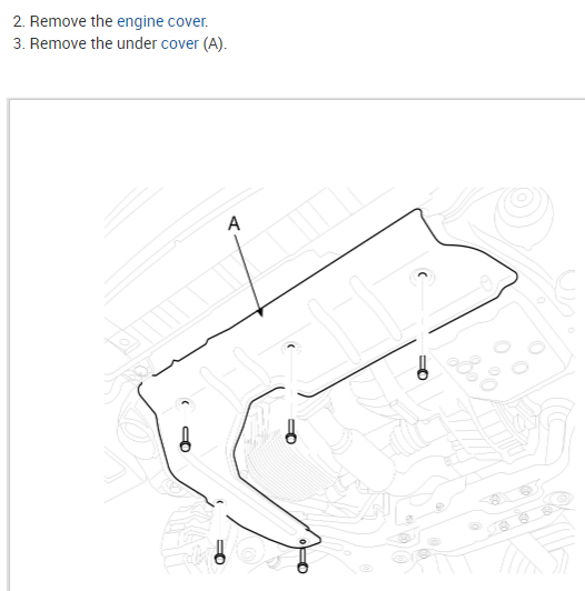

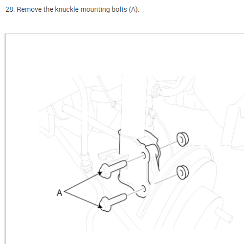

I have removed everything that I know of to remove the engine to my 2006 Hyundai, Using an engine hoist, I still can't get the engine out. What am I missing?

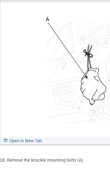

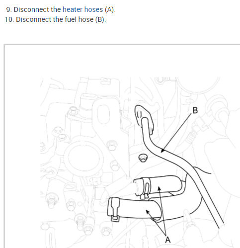

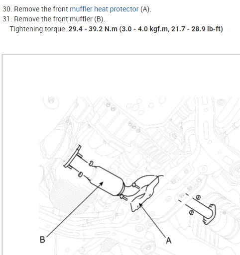

Hello, I'm Danny.
I've attached picture steps below on how to remove and replace the engine and transmission on your car. Once removed from the vehicle it will be easier to gain access on separating hopefully. Hope this helps and thanks again for using 2CarPros.
