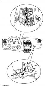

asked about the buld that illuminates the 3 knobs that light the heater AC knobs. I made a $10.00 donation and KHLow2008 didn't even answer my question. My question was If the bulb is burned out, how do I replace it. I thought I was going to get directions or some kine of help for my money.

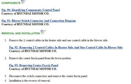

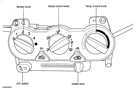

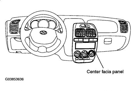

Hi there, thank you for the donation, there is not much in the data base on doing this, but have added what there is, from memory the 2 cable clips are fairly easy to access and the facia is located with clips, the cluster i think has 2 04 3 screws, you should be able to see them with the fascia removed, it's not much but i hope it helps. mark (mhpautos)
