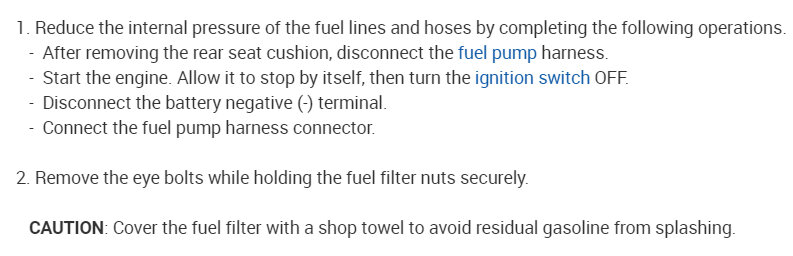

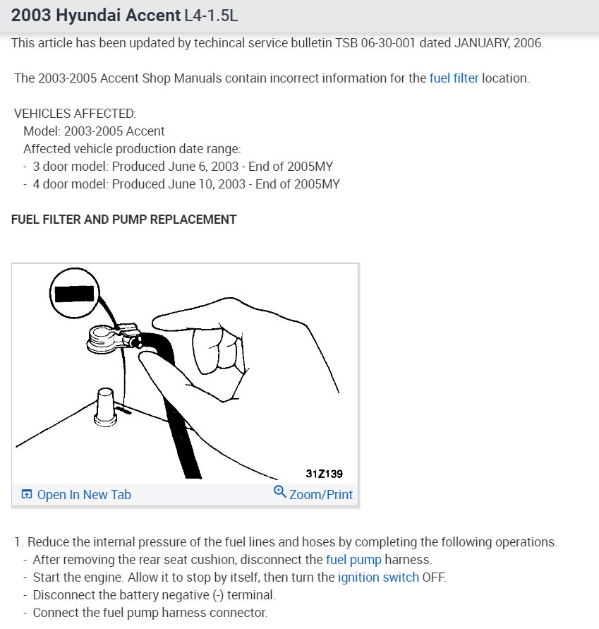

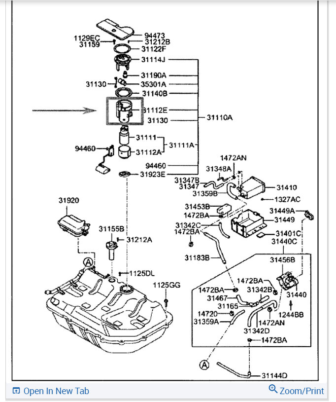

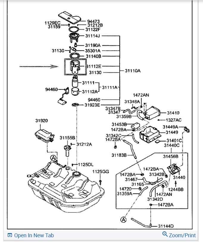

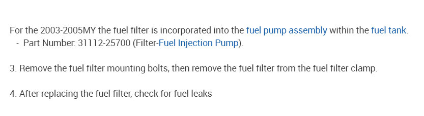

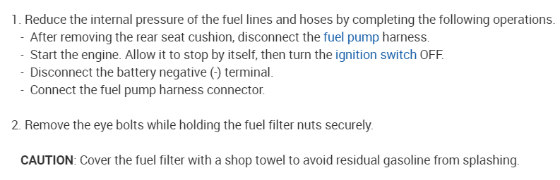

Where is the fuel filter located?
FRANKLIN37743
  • 2003 HYUNDAI ACCENT
  • 4 CYL
  • 2WD
  • 88,000 MILES
Friday, January 9th, 2009 AT 3:00 PM
ZACKMAN
  • 4,202 POSTS
For the 2003-2005 model years the fuel filter is incorporated into the fuel pump assembly within the fuel tank. So the fuel pump will need to be removed to service the fuel filter. Check out the images (Below). Please let us know if you need anything else.
