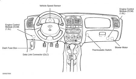

Where is the speed sensor?
Tuesday, March 24th, 2009 AT 12:30 PM
  • 110,194 POSTS
It is behind the instrument cluster. Here is the best picture I could find.
https://www.2carpros.com/forum/automotive_pictures/249084_sensor_2.jpg
Let me know if this helps.
