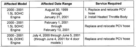

Well, let's do a couple of things. First is your vehicle a GL Sedan, GS hatch Back or L Hatch Back?
Next, there may be a recall for this very thing. . .. . .I have attached it. Please contact the dealer to see if it applies to you. The recall does involve the Throttle Body and the problem causes high idle. No guarantees, but worth checking into. Contact the dealer, Service Department and provide them with our VIN and they will be able to tell you if it applies to you.
While checking on those, I have attached 4 Safety recalls you can check on also.
Recalls are normally paid by the dealer at no cost to the consumer.
Next, since you can not probably do this until Monday, please go to Auto Zone or O'Reilly's and for FREE they can pull the codes to the car. Most important: Once they check your codes, if they find something and you don't get it fixed and need to get back with us, please make sure you tell us exactly what the code was, number and all. Example, if the code was E0568 O2 Sensor bad. Then make sure you give us all of that. While there for FREE also they can bring their tester out and check your battery, alternator and starter.

Group:
CAMPAIGN
Number:
02-01-004
Date:
APRIL, 2002
Model:
2000-01 ACCENT
Subject:
POSITIVE CRANKCASE VENTILATION (PCV) HOSE RELOCATION AND HEATED THROTTLE BODY INSTALLATION - CAMPAIGN 047
DESCRIPTION:
This bulletin describes the steps necessary to replace and relocate the PCV hose and install a heated throttle body on certain 2000 and 2001 model year Accents.
While driving at a steady throttle opening for an extended period of time during extremely cold ambient temperatures (below approximately -5 °F -20 °C with high humidity), moisture in the combustion blow-by gases traveling through the PCV valve and hose may freeze, blocking the PCV hose. If the PCV hose freezes, combustion chamber blowby gases are forced to exit the valve cover and enter the air intake hose through the breather hose. Because the breather hose enters the air intake hose before the throttle body, moisture in the combustion chamber blowby gases may freeze inside the throttle body idle speed control circuit and in the throttle body bore, resulting in a higher than normal engine idle speed and the throttle valve not closing fully.
AFFECTED VEHICLES:
All 2000 model year Accents and 1.5 liter
2001 model year Accents produced through February 13, 2001 and all 1.6 liter
2001 model year Accents produced through June 5, 2001 which are registered and operated in the 23 affected cold weather states listed below.
AFFECTED STATES:
Alaska, Colorado, Iowa, Idaho, Illinois, Indiana, Kansas, Massachusetts, Maine, Michigan, Minnesota, Missouri, Montana, North Dakota, Nebraska, New Hampshire, New York, Ohio, Pennsylvania, South Dakota, Vermont, Wisconsin, and Wyoming.
AFFECTED VEHICLES and SERVICE REQUIRED:
https://www.2carpros.com/forum/automotive_pictures/248015_1_63.jpg

BlueLightning/Impala SS: Okay I will tell my mechanic that. Anything else you think it might be?

Impala SS: It is a GL sedan.

I fit the recall - but will they honor a recall this late in 2008 when it was created in 2002?

Most dealers will honor a recall for up to 10 years from the release of the vehicle. It is different for each vehicle though so only your dealer will be able to tell you if you will have to pay for labor/parts.
