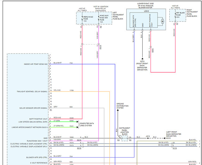

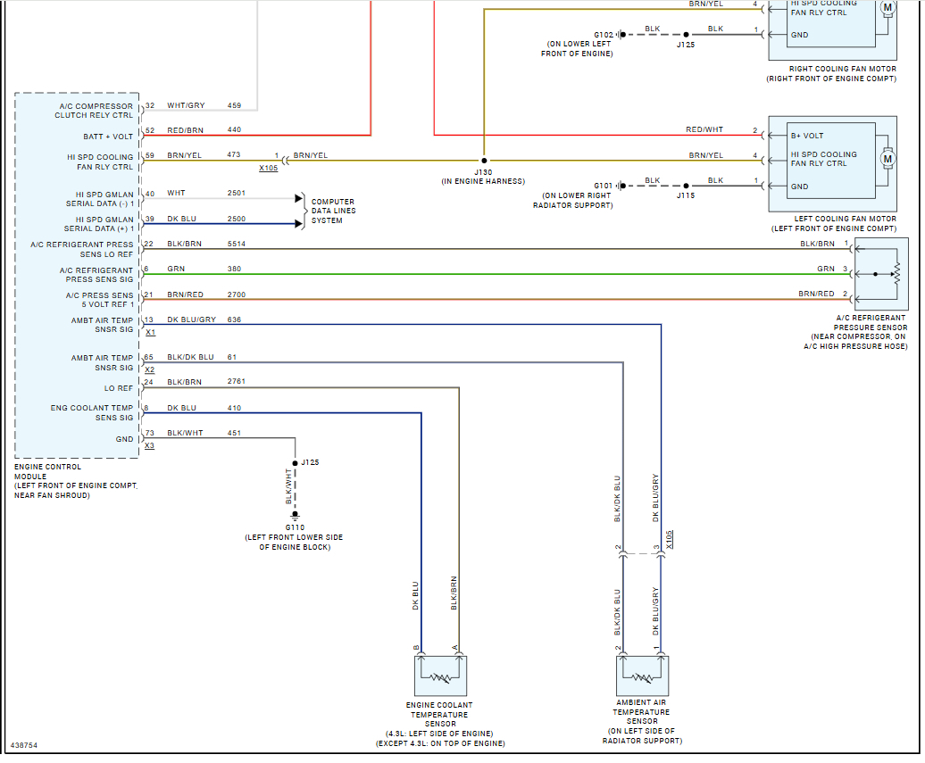

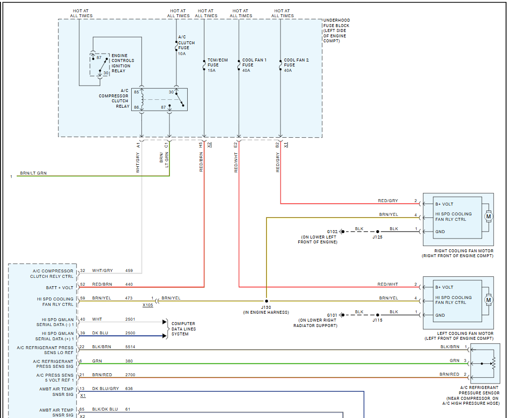

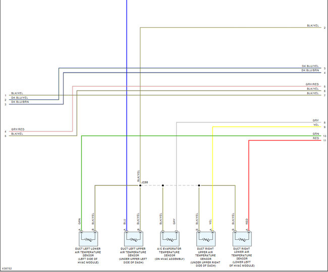

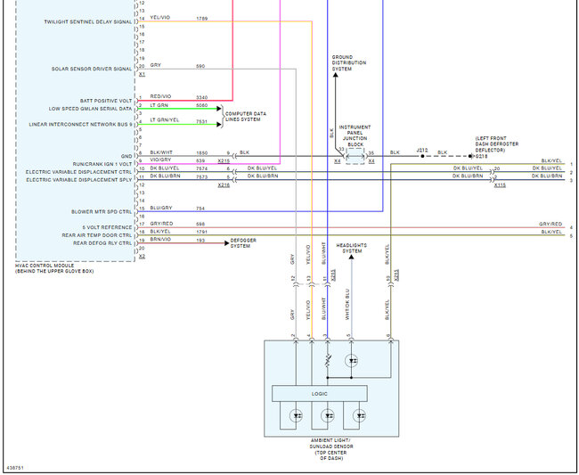

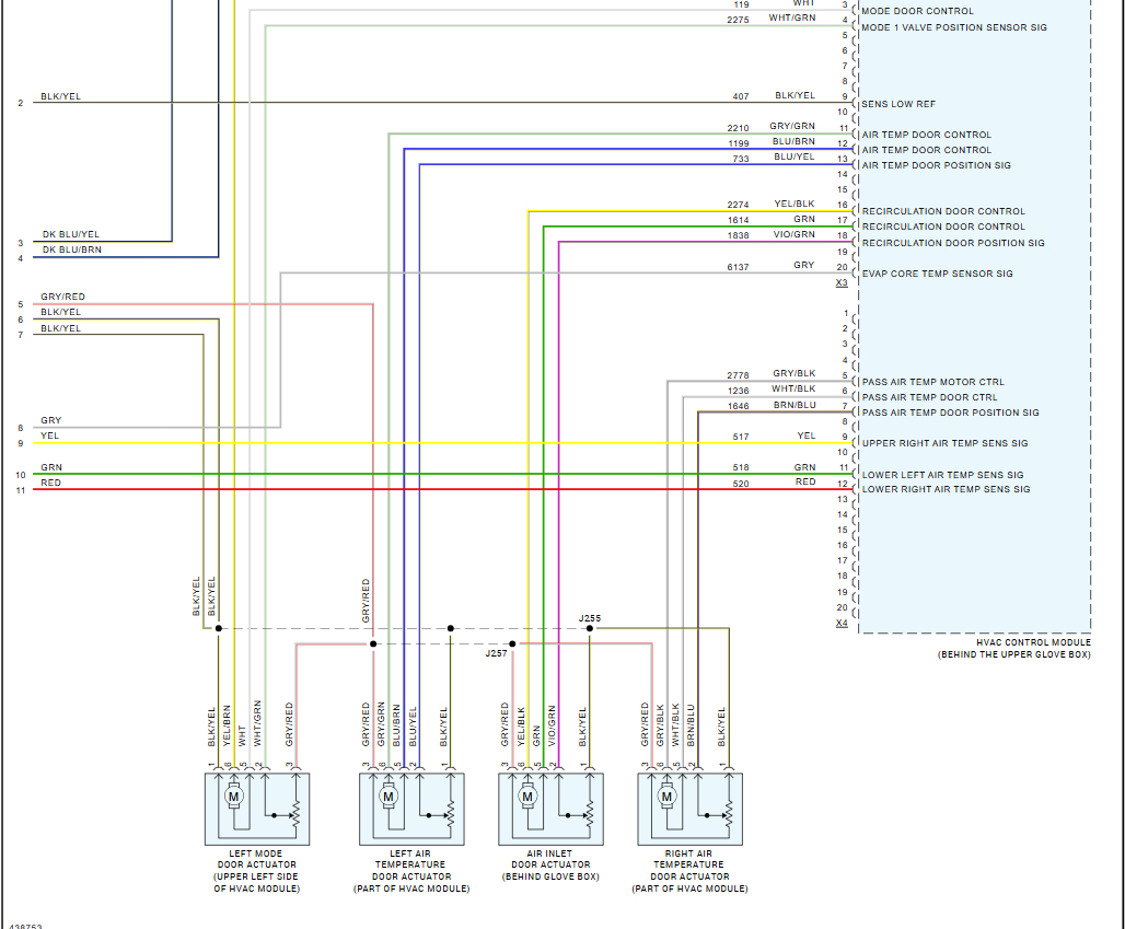

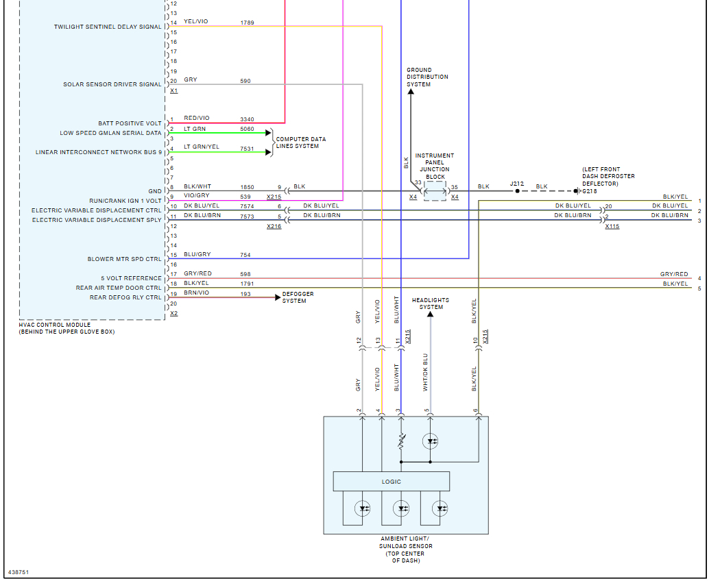

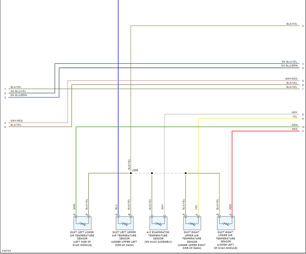

I need the HVAC control module pin out diagram, I need to know what wires are for what.

What size engine? 4x4?

It’s the v6 2-wheel drive.

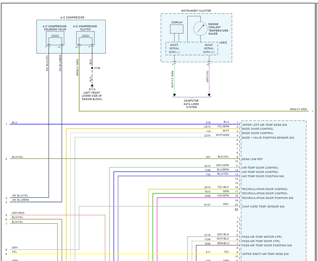

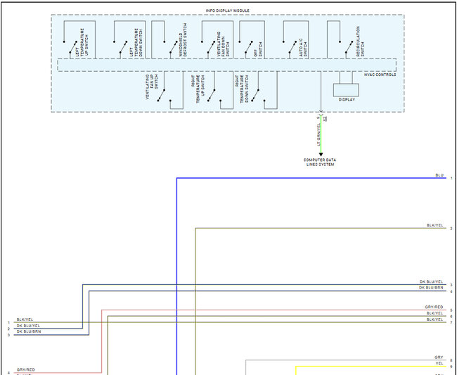

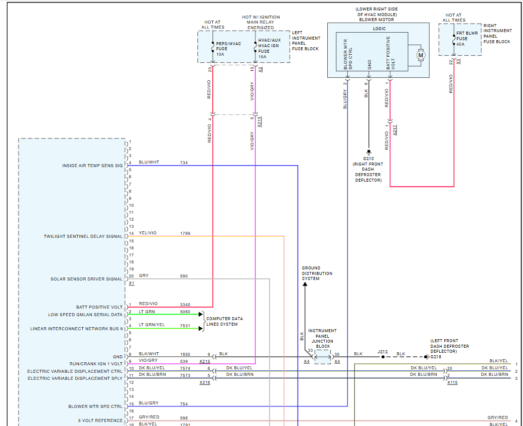

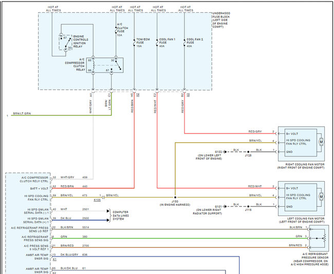

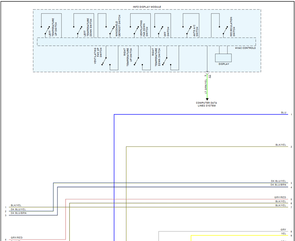

Here are the HVAC wiring diagrams so you can see how the system works.
Check out the images (below). Let us know if you need anything else.
