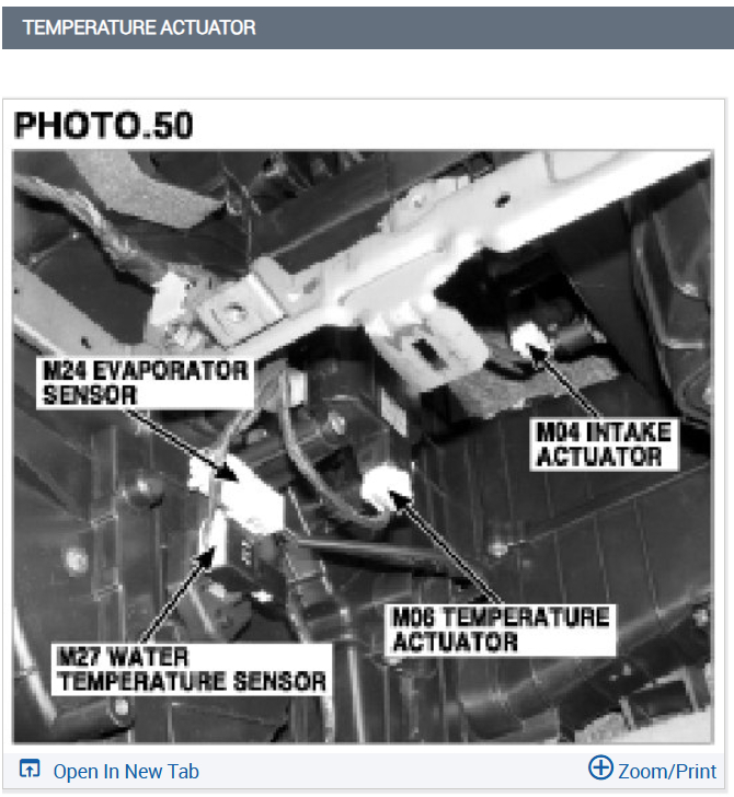

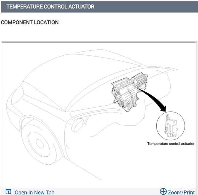

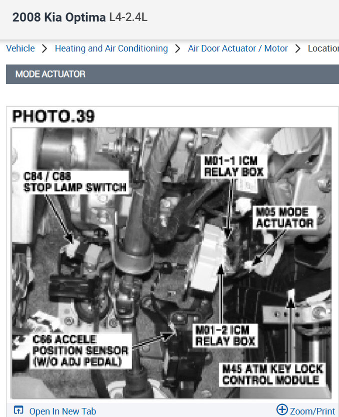

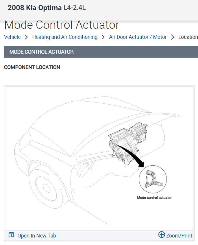

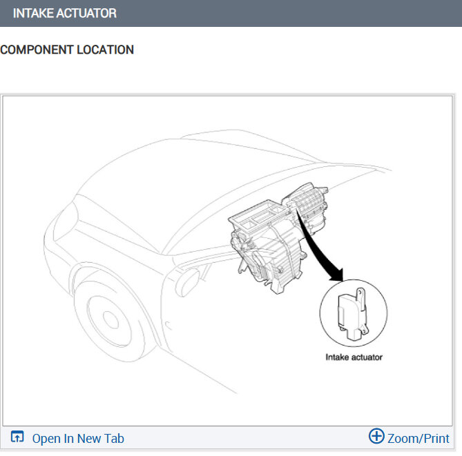

Where is the HVAC blend door located?
2008 KIA OPTIMA
180,000 MILES • 1.6L • V6 • 2WD • AUTOMATIC
MAC ROBINSON
HVAC blend door location.
Mar 15, 2025 at 3:50 AM
  • 55,006 POSTS
There are four blend door actuators which are listed below and, in the images, as well. If you have any question on what they do let me know.
Mode Actuator
Temperature Actuator
Intake Actuator
Temperature Control Actuator
Check out the images (below). Let us know if you need anything else.
