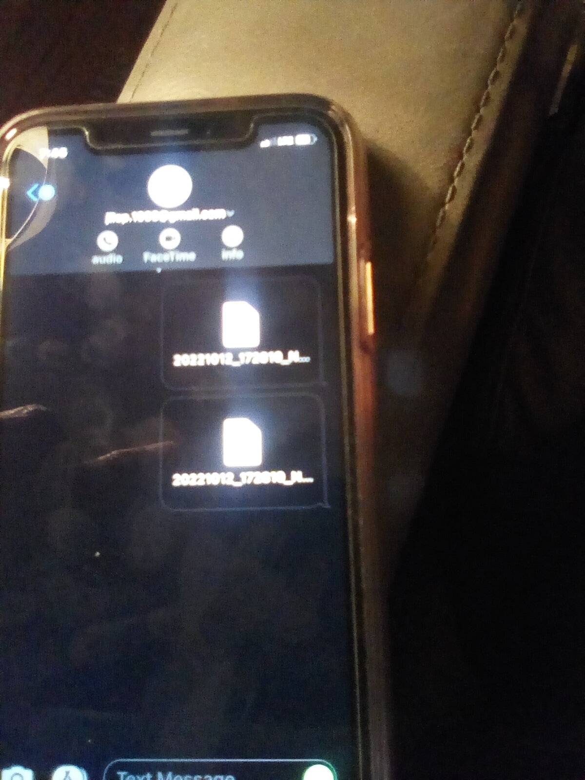

My wife recorded the sound on her phone. How do I put I put it on the email?

Hope this worked.

Also, I'm not sure what you attached above. I see pics of a phone. What am I missing?
