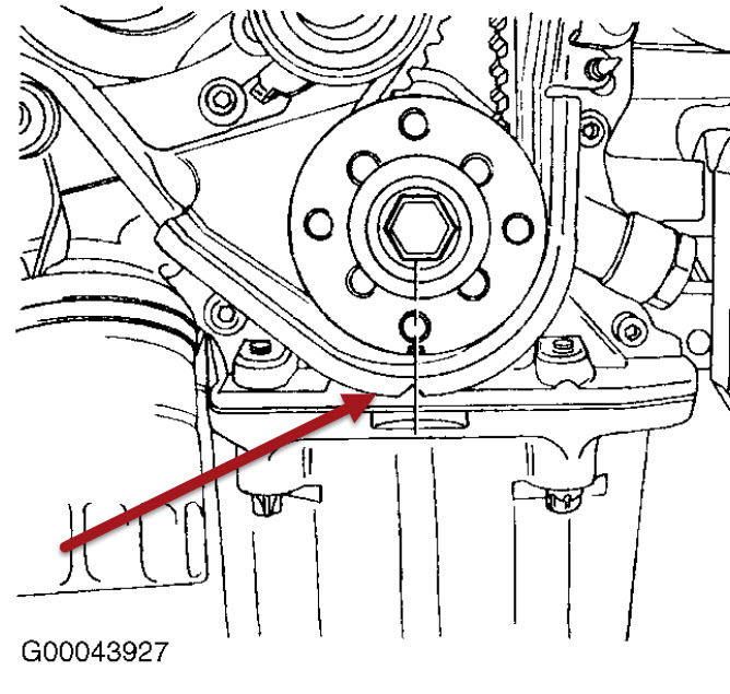

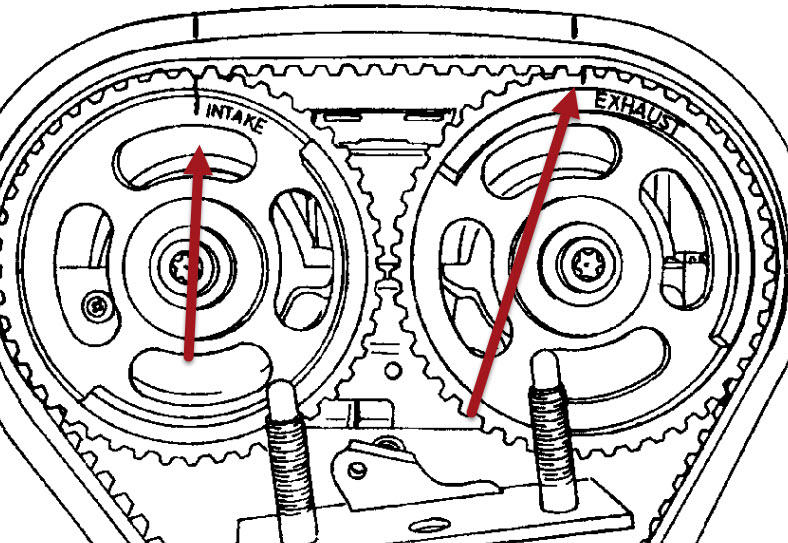

2002 DAEWOO LEGANZA
2.2L
4 CYL
FWD
AUTOMATIC
134,000 MILES
Cannot seem to get the timing marks lined up
Saturday, May 16th, 2015 AT 6:02 PM
HMAC300
MECHANIC
48,601 POSTS
Here are the timing belt marks for your car.
