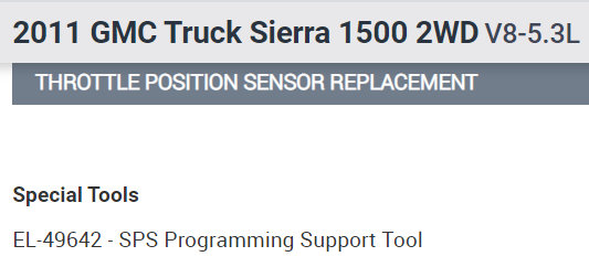

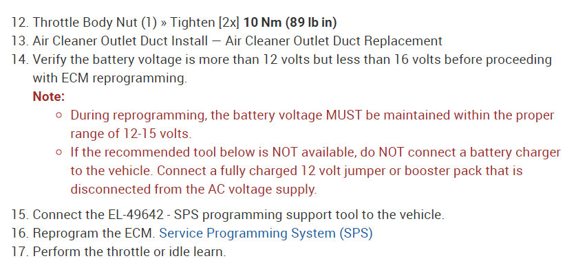

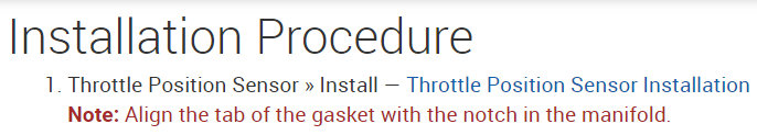

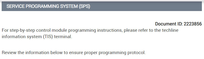

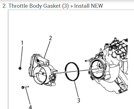

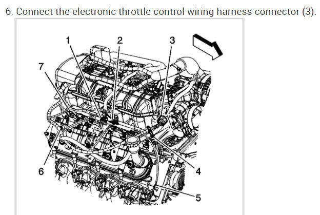

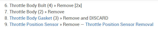

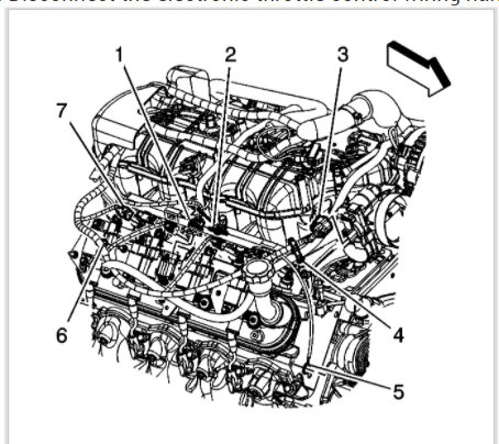

Need to replace the throttle position sensor on my truck.
Nov 25, 2019 at 10:41 AM
DANNY L
  • CAR REPAIR CONTRIBUTOR
  • 5,648 POSTS

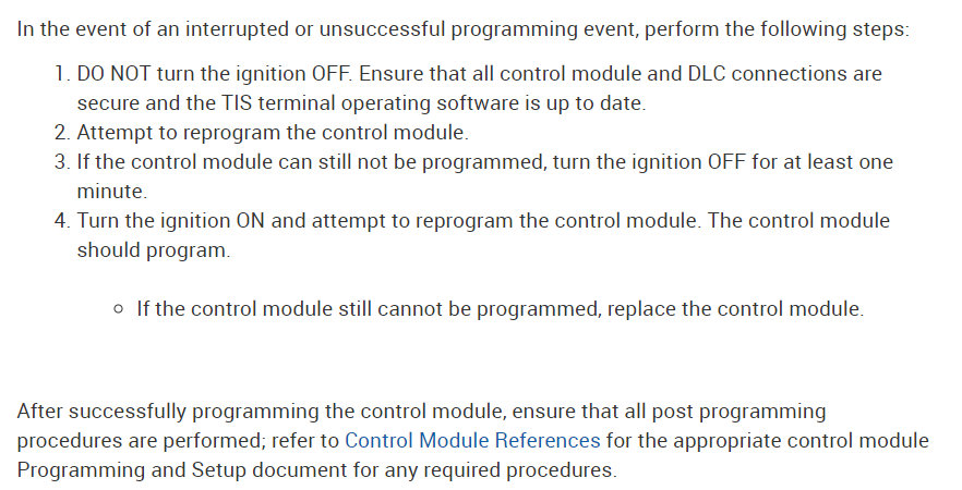

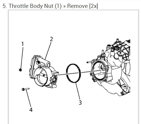

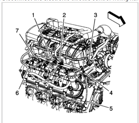

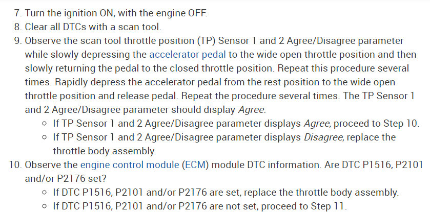

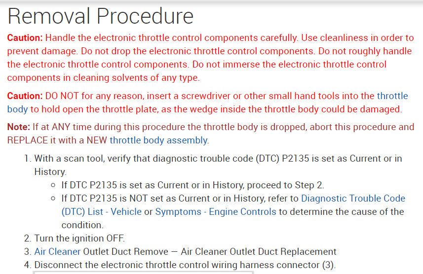

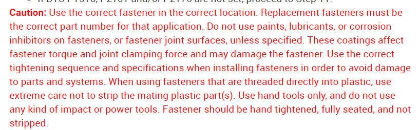

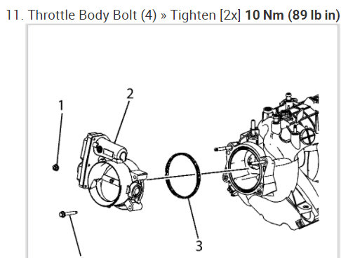

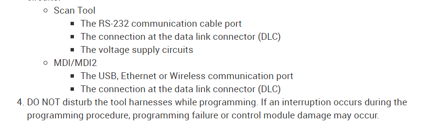

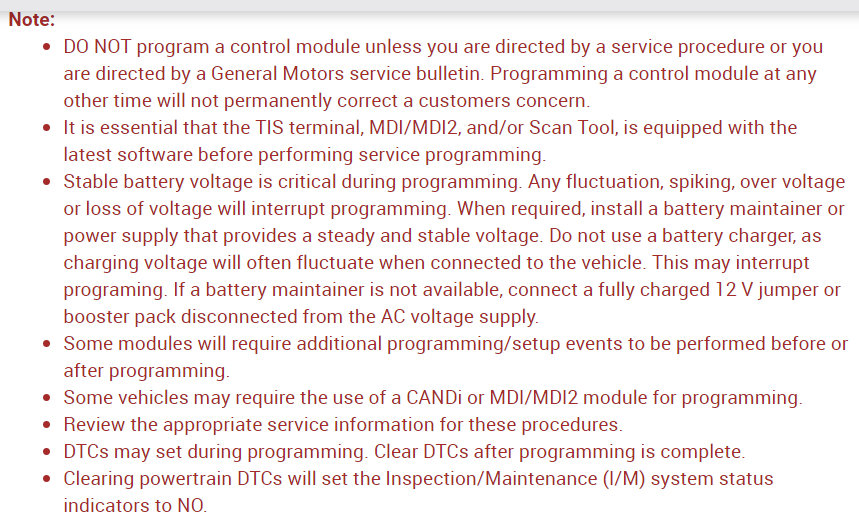

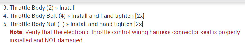

Hello again.

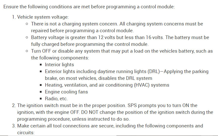

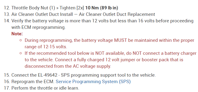

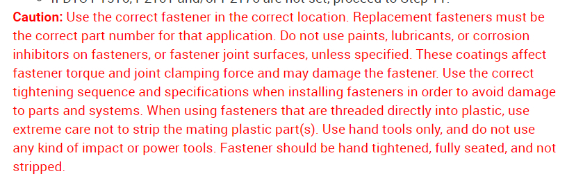

I've attached picture steps below on how to replace the throttle position sensor on your truck. Steps for module programming are included as well. Hope this helps and thanks for using 2CarPros.

My mechanic tells me the throttle body along with the sensor inside is bad, as my redeced engine power
alert comes on often now . Im told by mechanic that sensor is sealed inside throttle body and I need to
replace the entire throttle body $320 at GM dealership and $307 at Advance Auto. Just need someone
to confirm this info before I go spend this amount of money . Thanks Scott Bolivia NC

what hes telling you is true.

of course its always a good idea to check wiring. unplug the TPS and look at the plug for dark or brown marks as this would indicate a poor connection

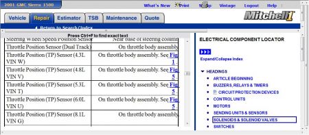

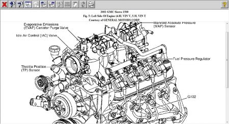

My trucks throttle has been sticking in the cold while on the freeway. (not very safe) Must shut truck off and restart to bring rpm's back down. Engine runs at erratic idle when stopped in park or in gear. Ran a diagnostic and got codes p0101, p0106, p0121. Suspect throttle position sensor. Any advice. Where is sensor located? It's -35 c outside and I don't want to be crawling around in the snow trying to find it.
Jan 7, 2021 at 12:13 PM (Merged)
  • 75,992 POSTS
See below-The TPS on V8's are at the same similar location
https://images.2carpros.com/forum/automotive_pictures/12900_tps_16.jpg
https://images.2carpros.com/forum/automotive_pictures/12900_tps1_9.jpg
