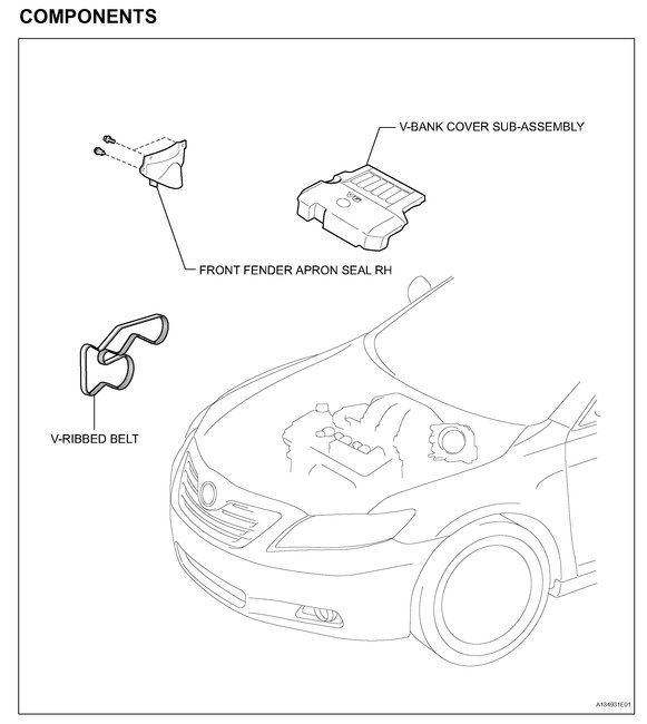

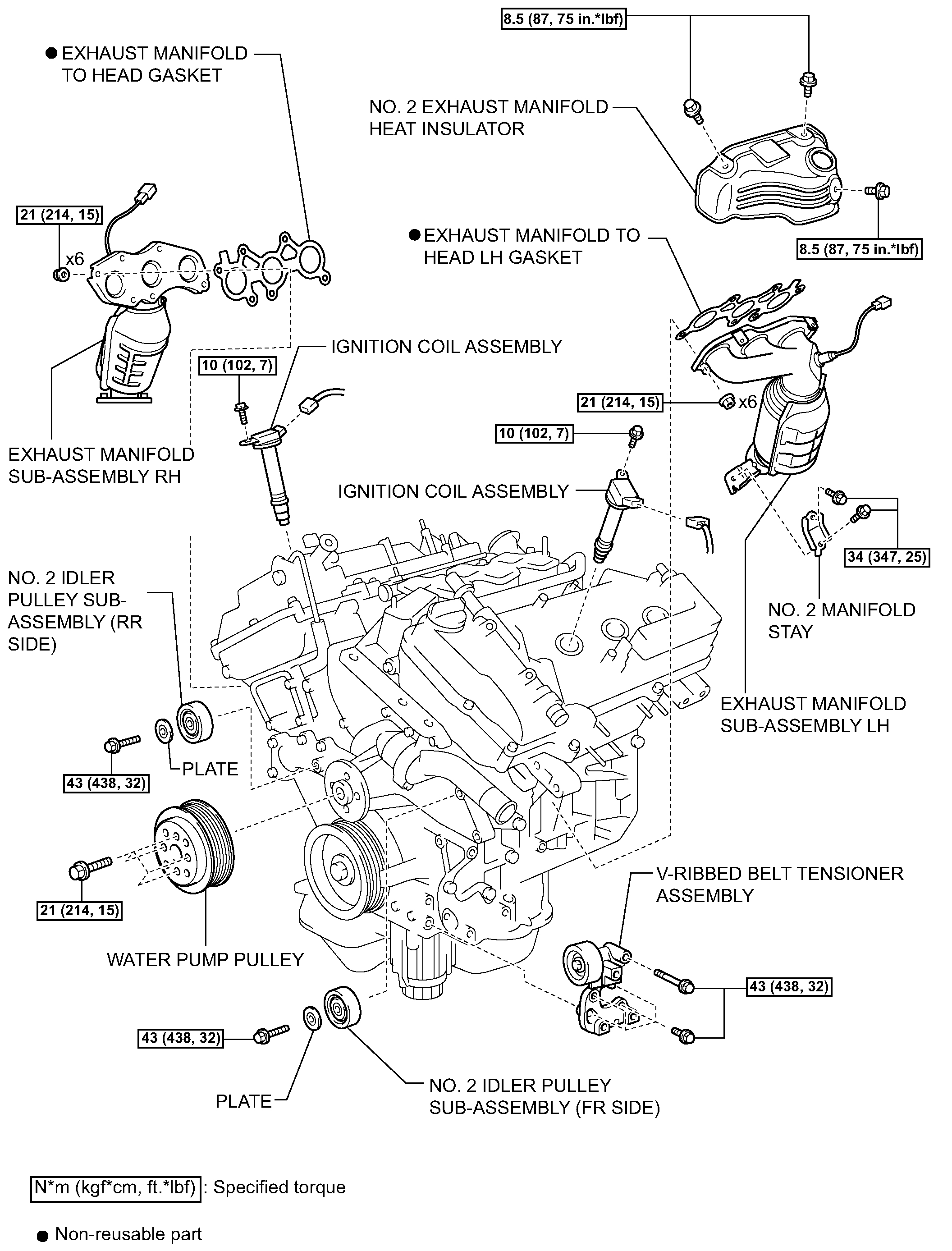

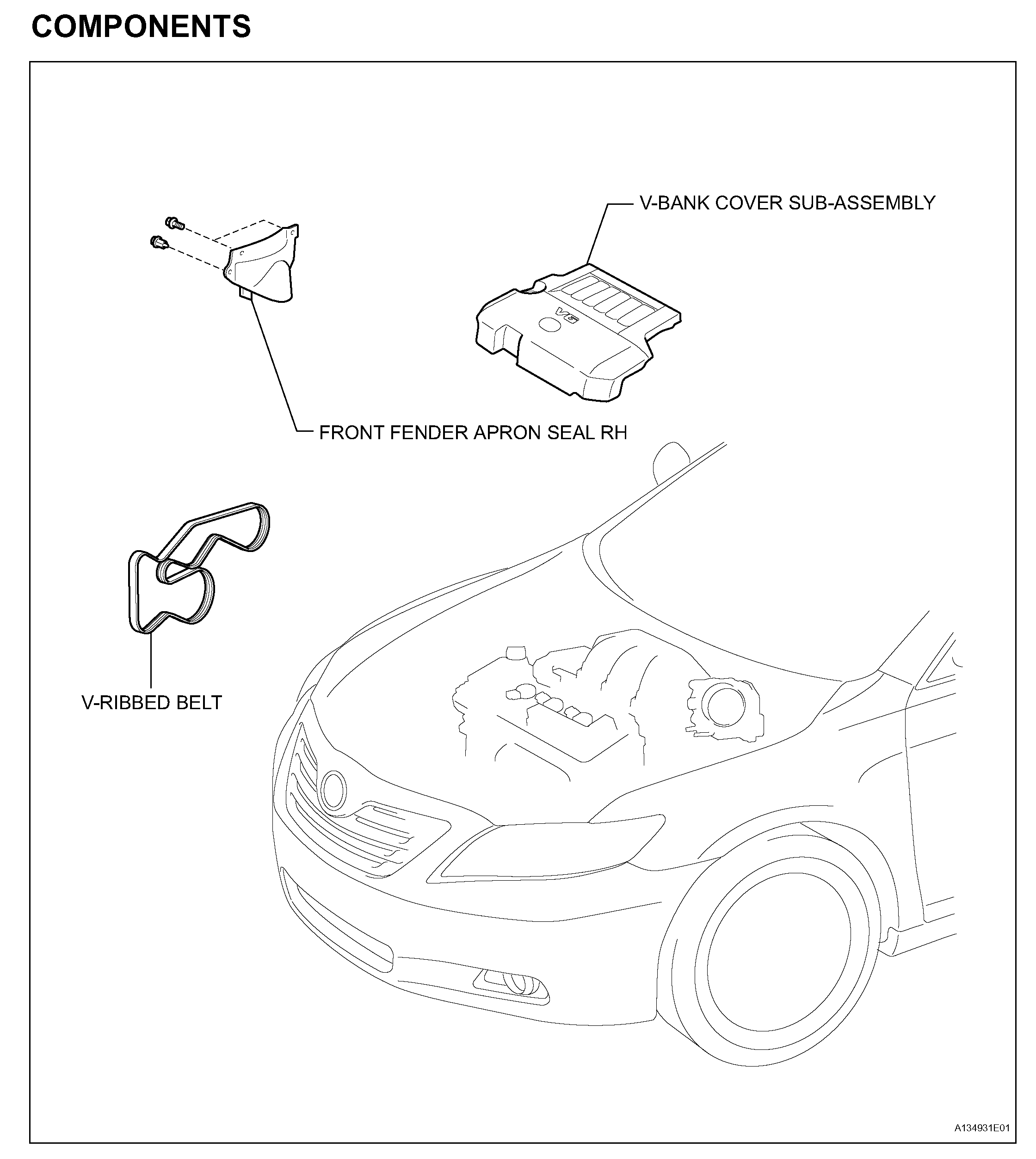

I have the LE model with the 3.5l engine. How do you remove the belt tension-er. Doing a visual it looks like I need to remove the alternator to get to the mounting bolts on the tension-er, which also means I need to remove radiator. Am I looking at it wrong? Please advise
Monday, October 29th, 2018 AT 9:00 AM
18 Replies
  • 110,194 POSTS

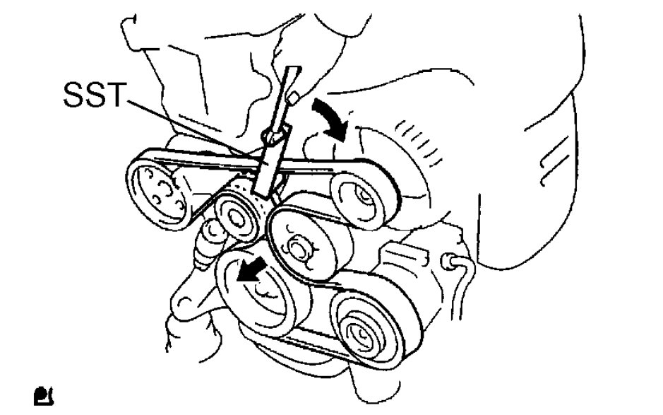

Hi and thanks for using 2CarPros. Com.

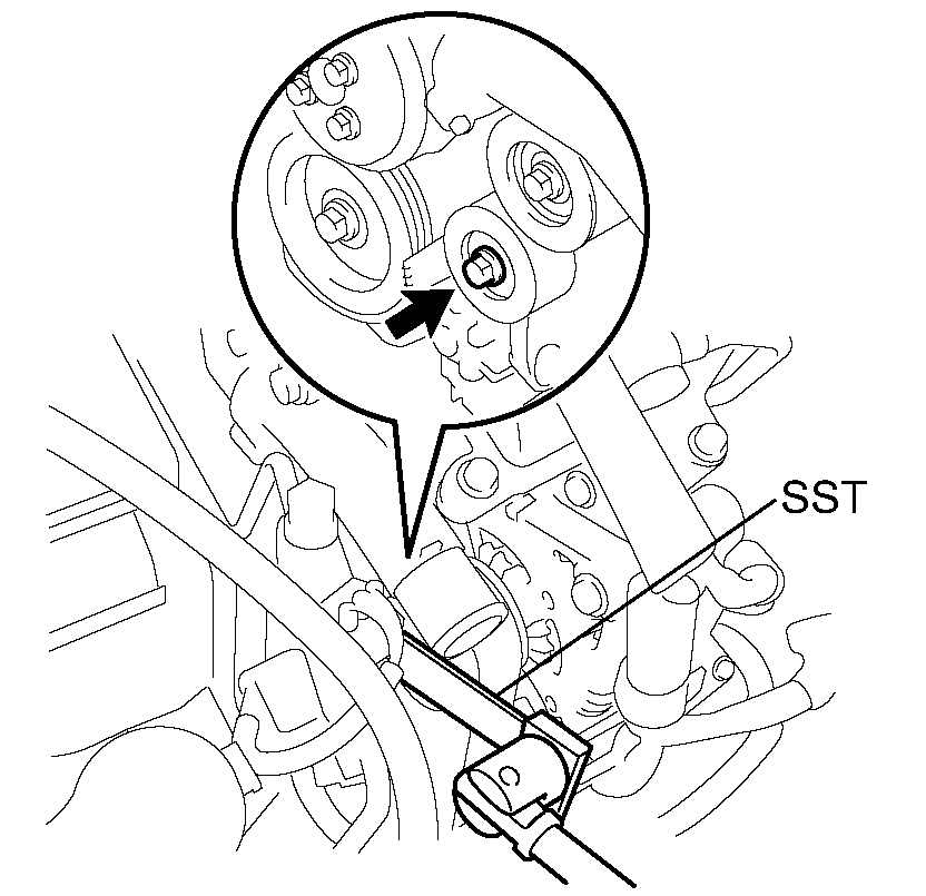

I have not done one in some time on the V6. However, I believe you can access it through the inner fender. Here are the directions for belt replacement. It shows how to access the tension-er. Take a look through this and let me know if it will help.
REMOVAL
1. REMOVE FRONT WHEEL RH
2. REMOVE FRONT FENDER APRON SEAL RH
3. REMOVE V-BANK COVER SUB-ASSEMBLY
4. REMOVE V-RIBBED BELT
(a) Using SST, release the belt tension by turning the belt tension-er counterclockwise, and remove the V-ribbed belt from the belt tension-er.
_________________________________________
I checked labor for replacement. It calls for 4.5 hours. Ugh! It is starting to come back to me. It was not too easy.
Let me know if this helps.
Monday, October 29th, 2018 AT 6:37 PM
UCLAJOHN
Yes, it verifies the alternator must come out which in turn means the radiator must come out as well. Much appreciated. I can see why it says 4.5 hours for labor. Thank you sir for your help.

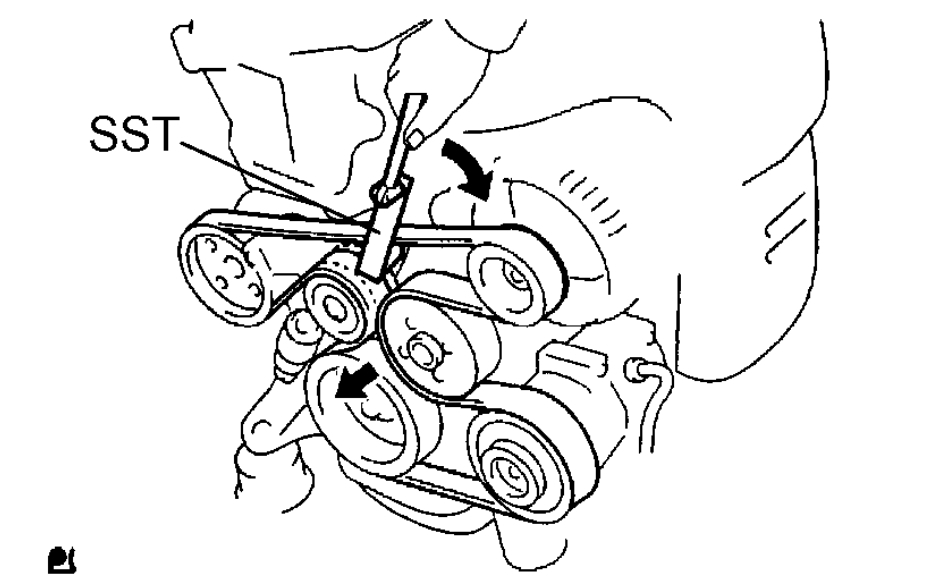

Hello, I am Angel RÃ os from Puerto Rico. I need to know the complete process for replace the Serpentine Tensioner Belt for Toyota Camry 2007 4 cylinder LE model.
Thanks for the help that you can give me.

Refer to our homepage under the DIY section for belt repairs. There are schematics there for belt routing.
As far as the tensionier replacement, you need to remove the belt, unbolt and remove the tensionier, and reverse the order to replace it.

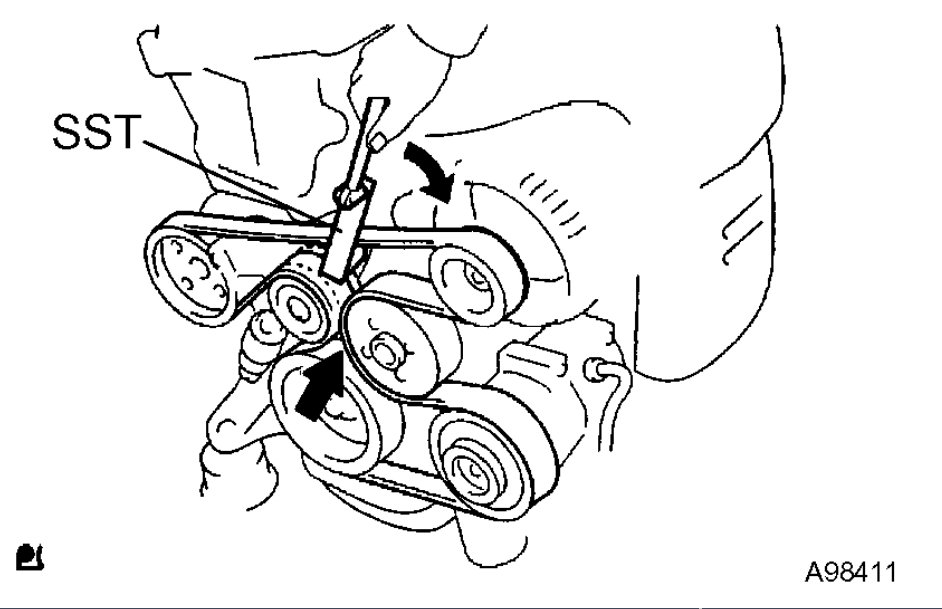

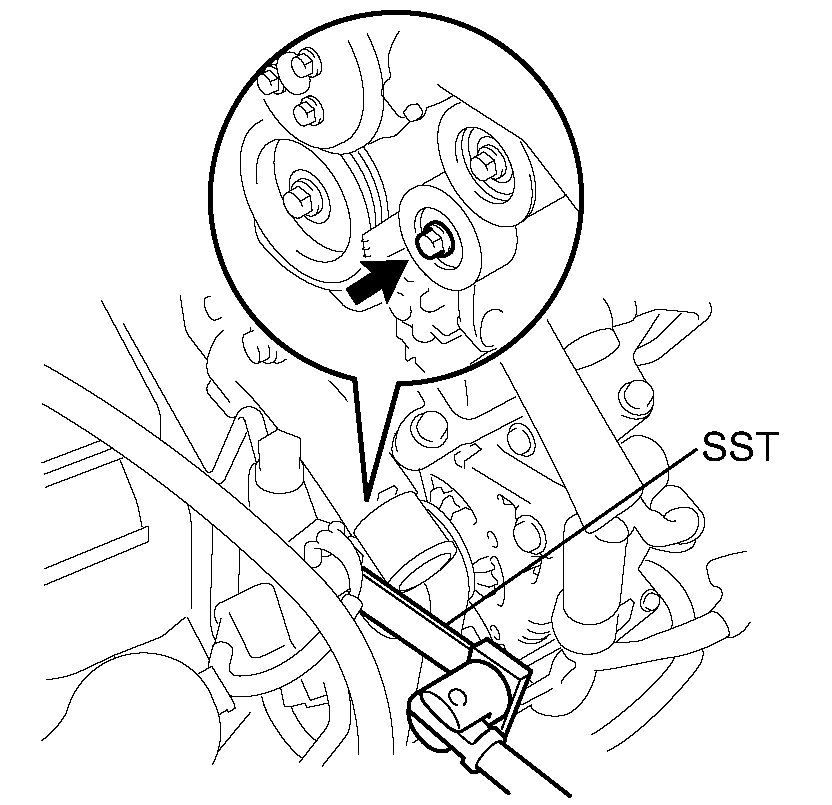

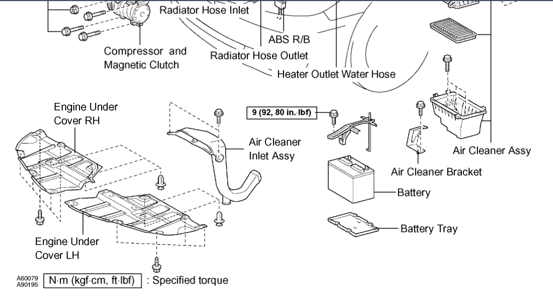

SCGRANTURISMO
  • 4,897 POSTS
If that works for you, than yes, there is more than one way to skin a cat. In the diagrams down below I have included the Toyota Factory directions for the proper way to remove and install the drive belt on your vehicle. Please go through this guide and get back to us with how it turns out.
Thanks,
Alex
2CarPros

I need to replace the serpentine belt. It has a hydrolic belt tensioner. It looks like the nut that you crank on to release pressure so I can remove, but it is broken. Everything else is okay. I think this nut is just to release pressure so hat to have to change out the whole tenisionor. How else can I release pressure? I do not weld. Is there something else I can loosen?
Tuesday, July 21st, 2020 AT 11:22 AM (Merged)
KEN L
  • MASTER CERTIFIED MECHANIC
  • 55,440 POSTS
Here is a diagram on what you need to do
https://www.2carpros.com/diagrams/toyota/camry/2002
Let me know how it goes
Best, Ken

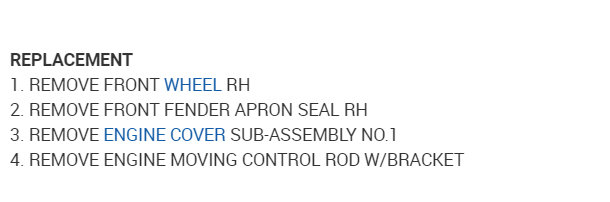

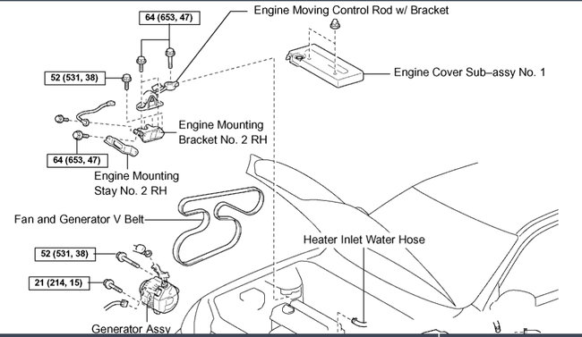

How do I release tension on the serpentine belt to change it?
Tuesday, July 21st, 2020 AT 11:23 AM (Merged)

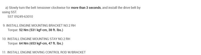

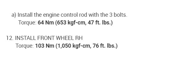

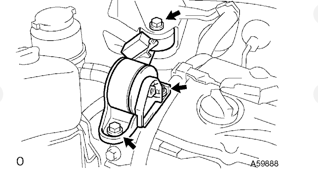

SATURNTECH9
  • 30,869 POSTS

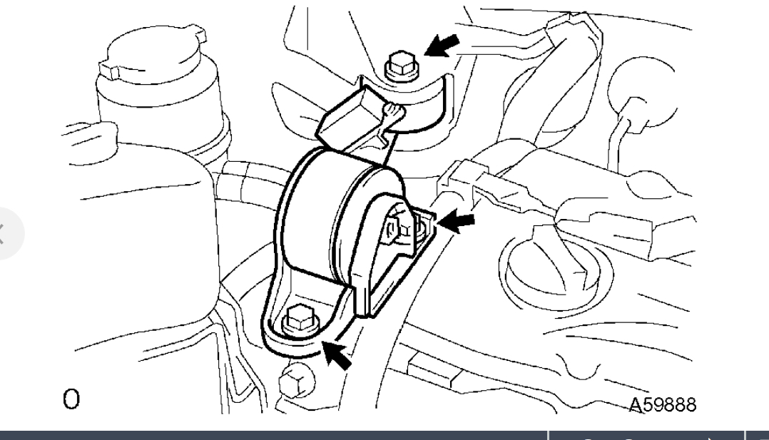

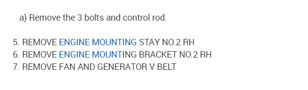

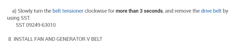

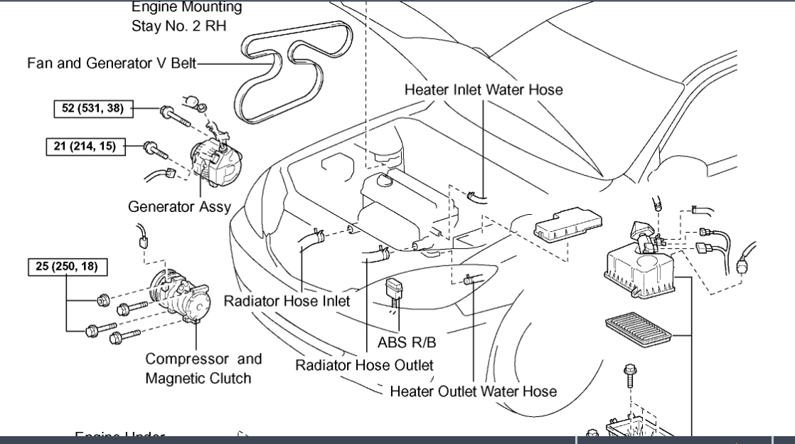

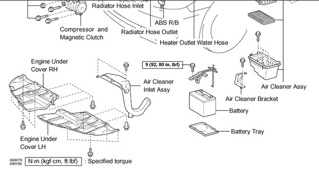

REPLACEMENT
3. REMOVE ENGINE COVER SUB-ASSEMBLY NO.1
4. REMOVE ENGINE MOVING CONTROL ROD W/BRACKET
a) Remove the 3 bolts and control rod.
5. REMOVE ENGINE MOUNTING STAY NO.2 RH
6. REMOVE ENGINE MOUNTING BRACKET NO.2 RH
7. REMOVE FAN AND GENERATOR V BELT
a) Slowly turn the belt tensioner clockwise for more than 3 seconds, and remove the drive belt by using SST.
SST 09249-63010
8. INSTALL FAN AND GENERATOR V BELT
a) Slowly turn the belt tensioner clockwise for more than 3 seconds, and install the drive belt by using SST.
SST 09249-63010
9. INSTALL ENGINE MOUNTING BRACKET NO.2 RH Torque: 52 Nm (531 kgf-cm, 38 ft. Lbs.)
10. INSTALL ENGINE MOUNTING STAY NO.2 RH Torque: 64 Nm (653 kgf-cm, 47 ft. Lbs.)
11. INSTALL ENGINE MOVING CONTROL ROD W/BRACKET
a) Install the engine control rod with the 3 bolts.
12. INSTALL FRONT WHEEL RH Torque: 103 Nm (1,050 kgf-cm, 76 ft. Lbs.)
-1

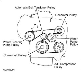

RTHALLMAN
  • 2002 TOYOTA CAMRY
  • 4 CYL
  • FWD
  • 160,000 MILES

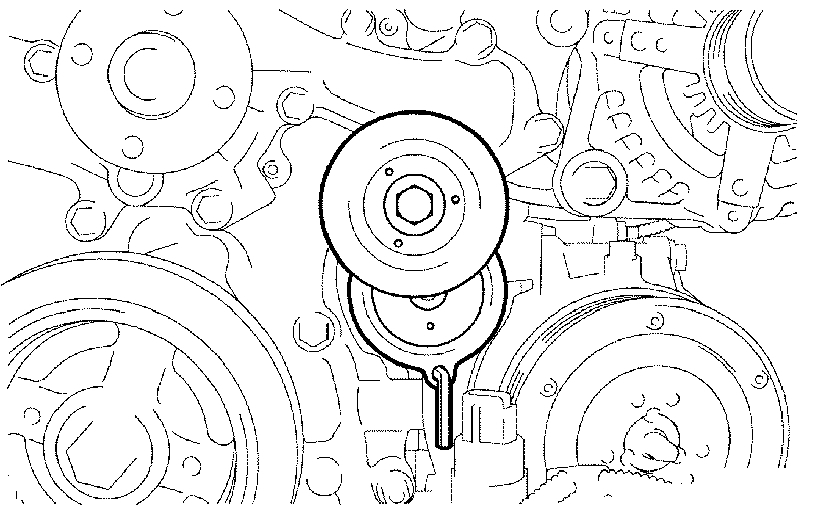

How do you adjust the drive belt tensioner. It does not allow enough movement to change the belt. THe Hynes manual says to "remove the driver bolt", but I'm not sure what that is.
RACEFAN966
  • 5,029 POSTS
From what I can find it say's that it is an automatic tensioner so therefor there is no adjustment. Here is a diagram of what I see.
https://www.2carpros.com/forum/automotive_pictures/249564_Graphic_121.jpg
