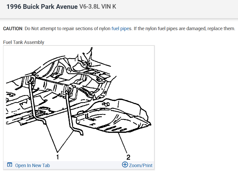

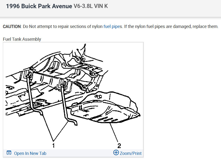

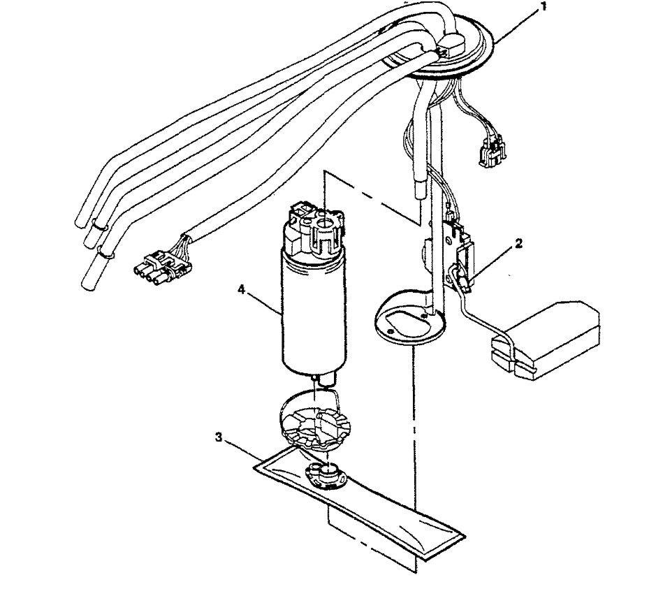

Can I go through the back seats or do I have to drop the tank?
Dec 8, 2024 at 10:37 AM
  • 54,520 POSTS
Yep, you need to drop the tank, I would drain the fuel out first.
This video can help you:
https://www.youtube.com/watch?v=Q5MH2gnyFH0&t
Check out the images (below). Let us know if you need anything else.
