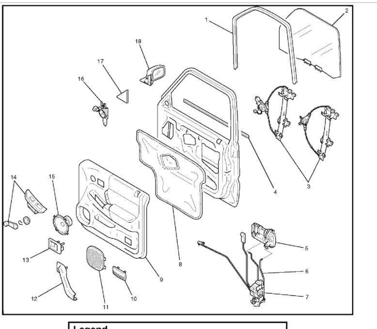

Both driver and passenger doors will only open from inside. Cannot figure out how to remove door panel so I can check the linkage.

You must remove the door handle first to check the linkage which has probably fallen off of the handle.
Here is a guide that will give you an idea on how to do the job.
https://www.2carpros.com/articles/door-panel-removal
Here is a diagram for your car (BELOW)
Please let us know what happens. I am curious ;)
