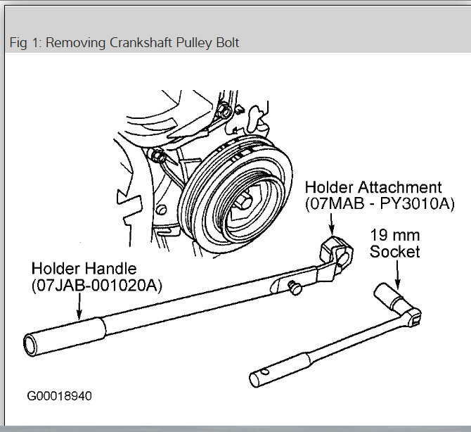

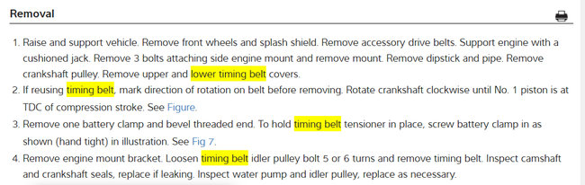

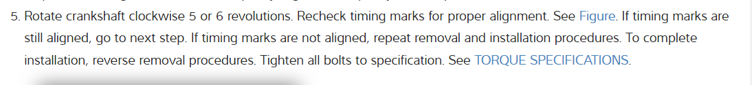

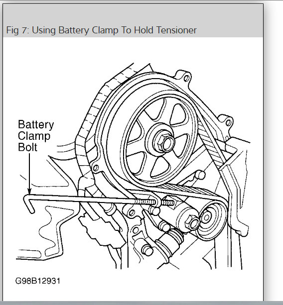

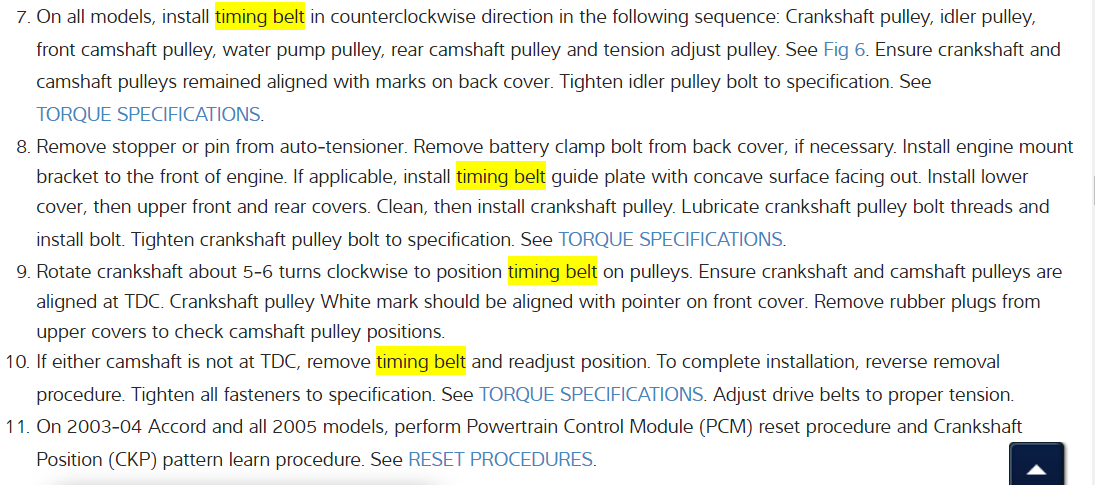

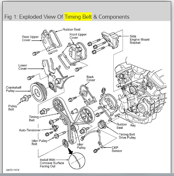

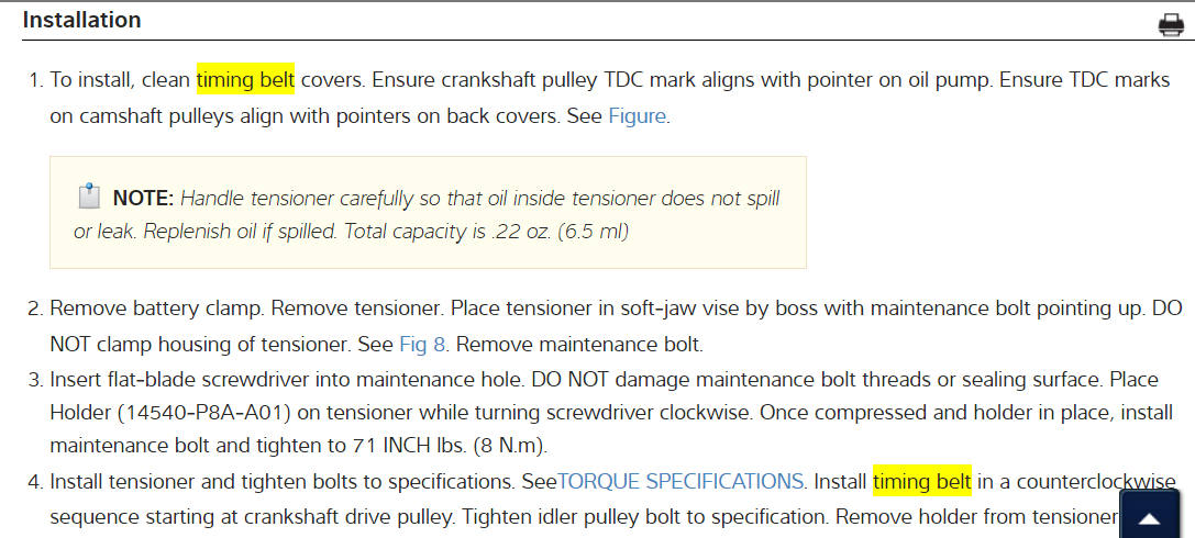

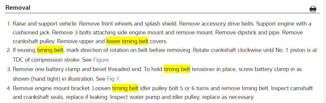

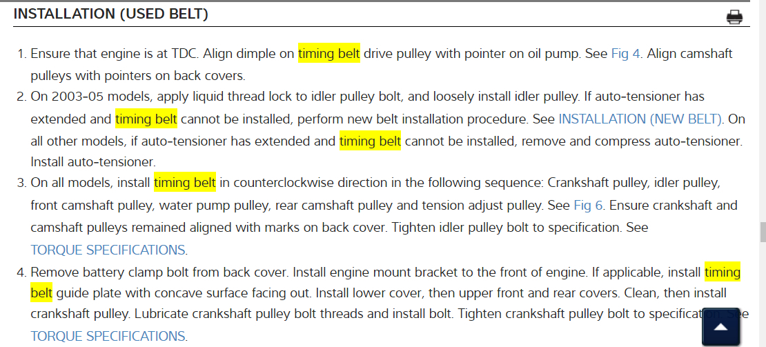

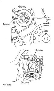

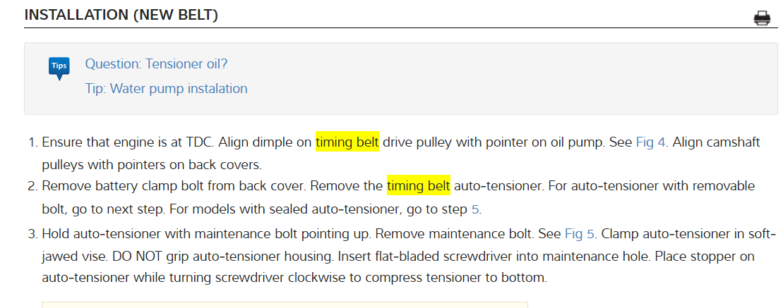

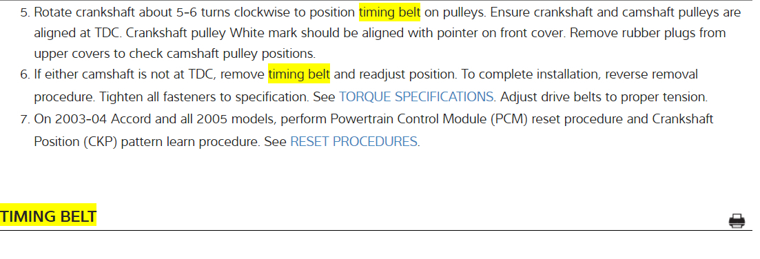

How can l change a timing belt?
Wednesday, April 3rd, 2019 AT 7:39 PM
15 Replies
SCGRANTURISMO
  • 4,897 POSTS

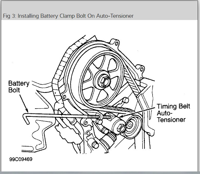

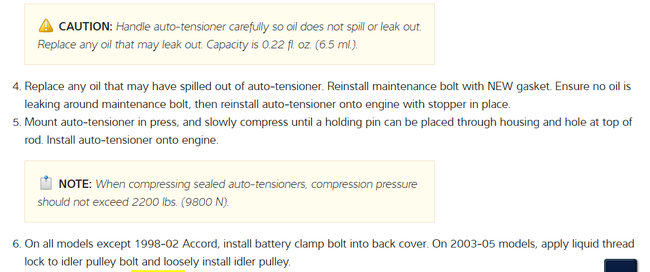

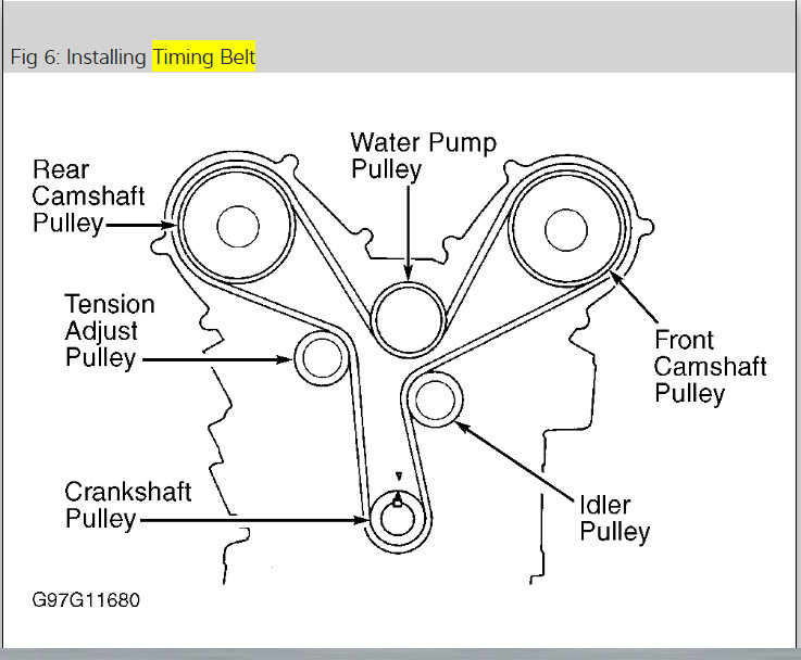

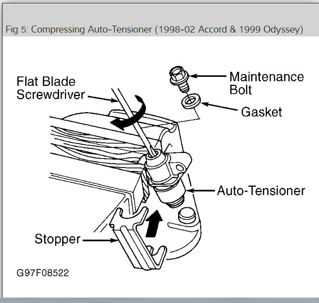

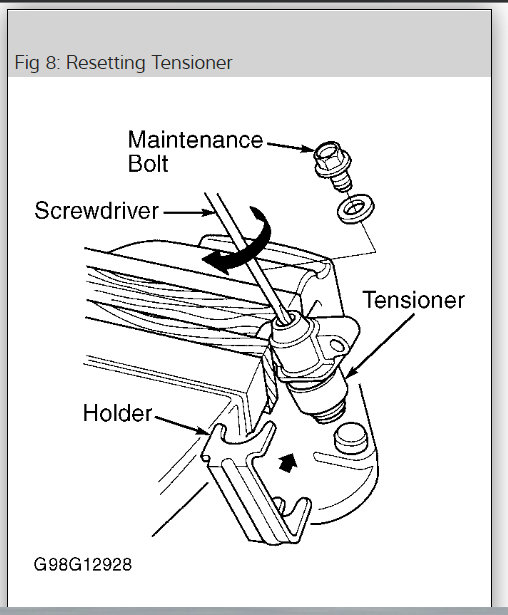

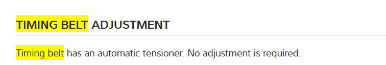

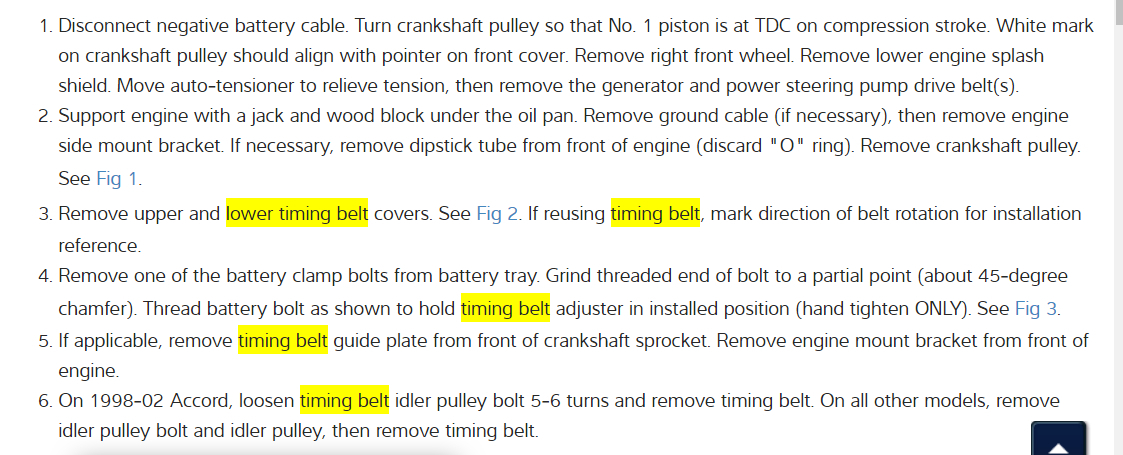

I have included the information that you requested in the diagrams down below. Please go through the factory installation guide provided to you and get back to us with what you find out. Here is a guide to help you step by step with instructions in the diagrams below to show you how on your car.
https://www.2carpros.com/diagrams/honda/accord/2001
If you have any other questions please feel free to ask. That is what we are here for.
Thanks,
Alex

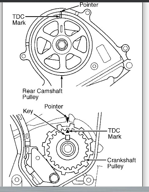

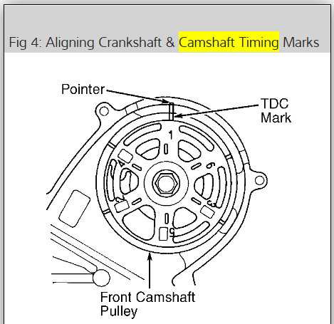

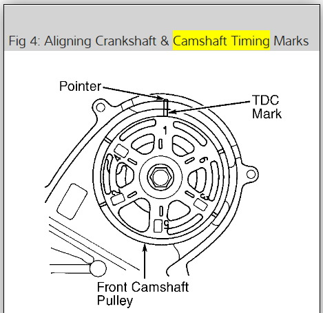

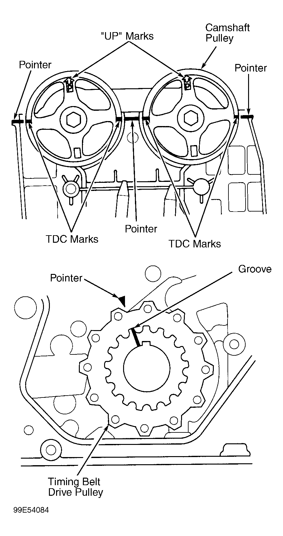

Need timing belt marks for 2001 honda crv
Monday, January 11th, 2021 AT 5:13 PM (Merged)
DOCFIXIT
  • 18,828 POSTS
Here is a guide and diagrams below to help show the engine camshaft timing marks.
Cheers

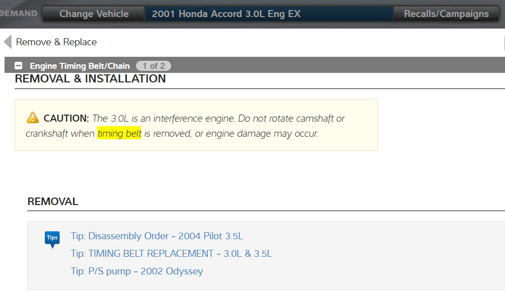

Back in the '80s Honda recommended the belt be replaced at 75,000 miles, ... And they commonly broke at around 65,000 miles leading to a REAL expensive engine repair. They use an "interference" engine which means when the timing belt breaks, the open valves are hit by the pistons as they coast to a stop and become bent. You'll need new valves and a since the cylinder head has to come off, you'll get a new head gasket too. Independent mechanics can replace the belt but if proper procedures aren't followed, some valves can still be bent. Anyone with a little experience can handle the job. $1200.00 seems awfully high. They most likely plan on replacing the water pump too if its pulley is one used by the timing belt. The extra cost of the part is cheap insurance against a failure later.

Does my car have a timing belt or chain? What kind of sound might I hear if this has broken?
Monday, January 11th, 2021 AT 5:14 PM (Merged)
MHPAUTOS
  • 31,937 POSTS
Hi there,
The liter V6 has a belt drive, if it has broken, the engine will not run, there may be no noise heard as when the belt breaks it will case the pistons to hit and bend any open valves, this will happen in a mili second, you wont know it has happened.
