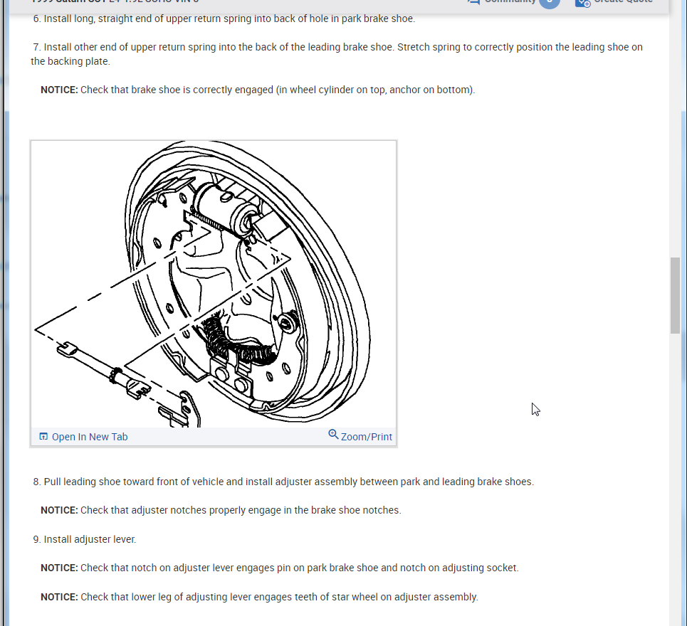

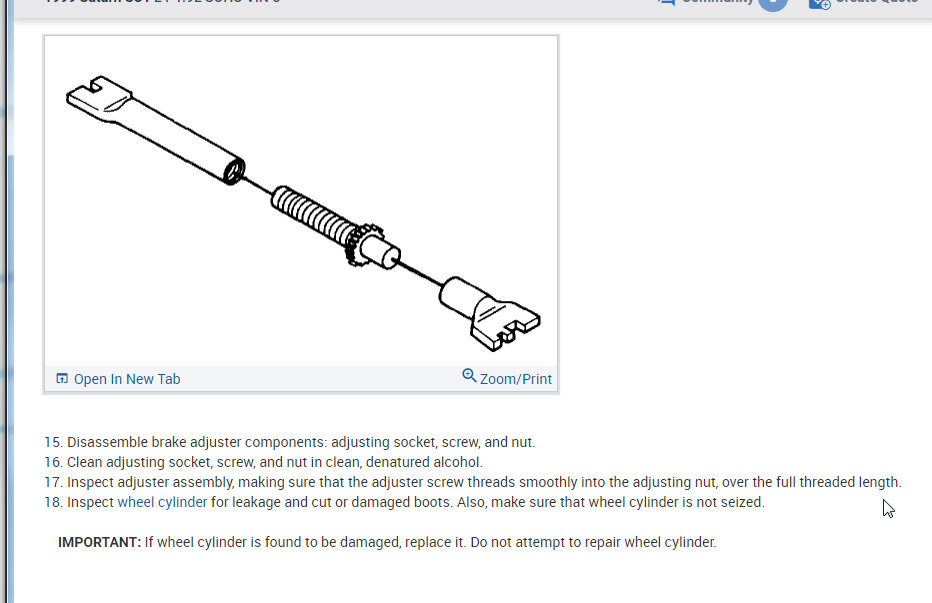

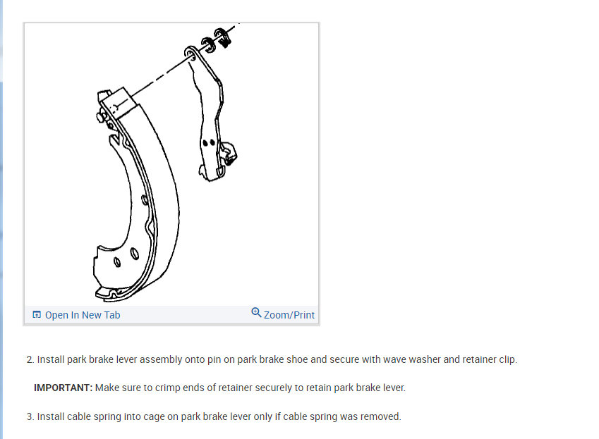

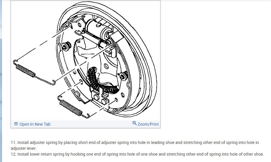

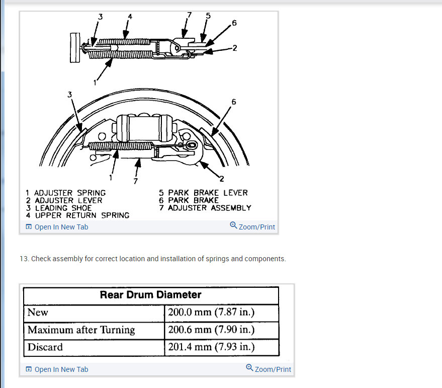

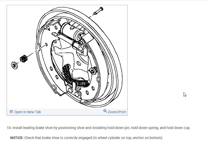

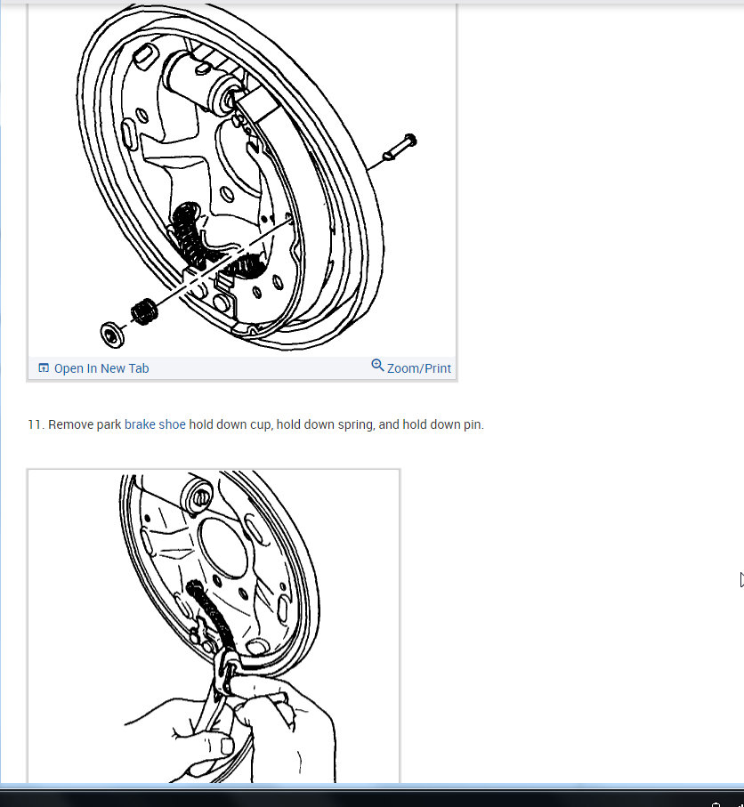

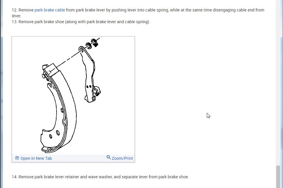

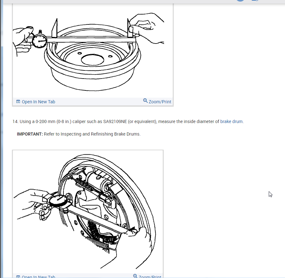

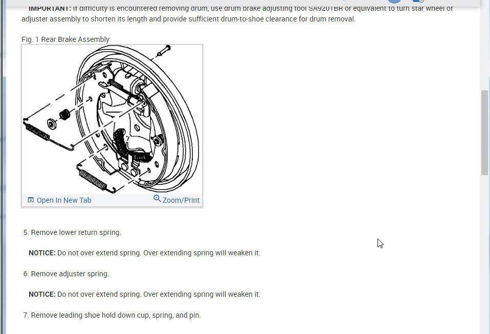

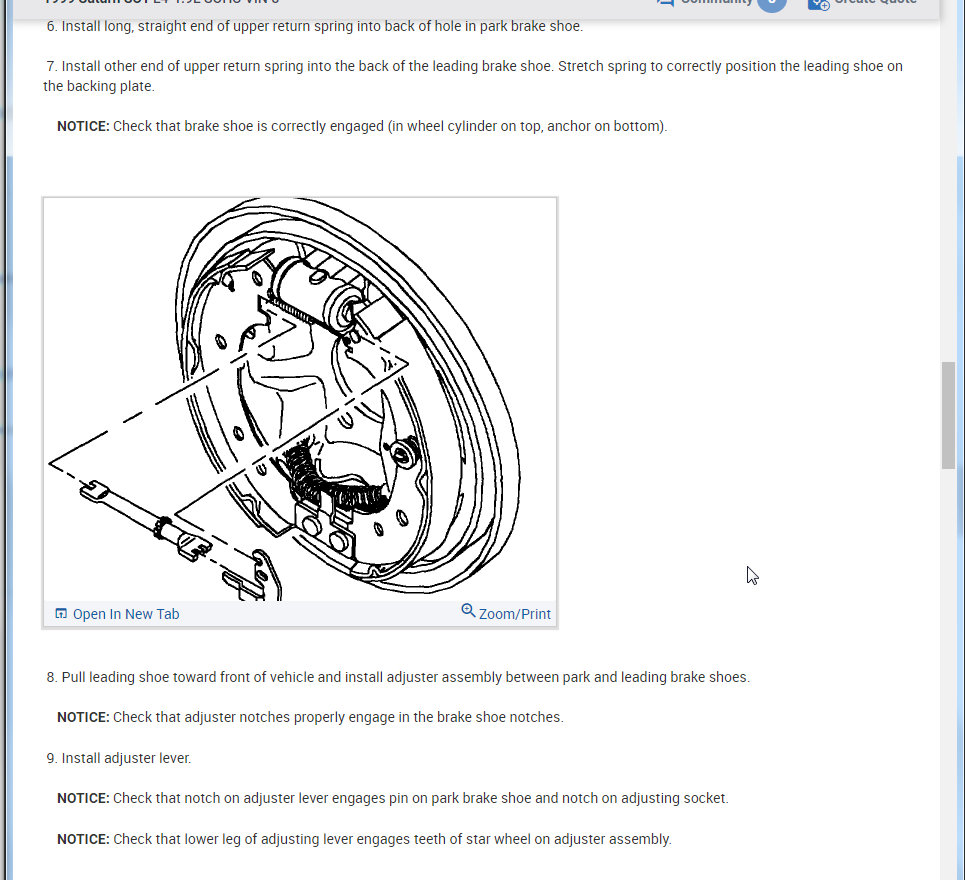

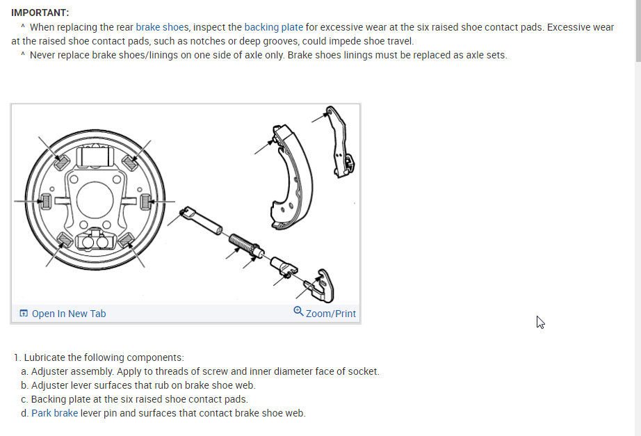

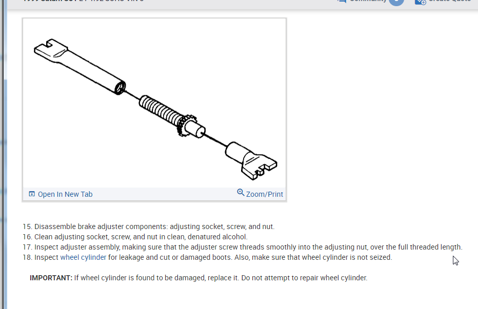

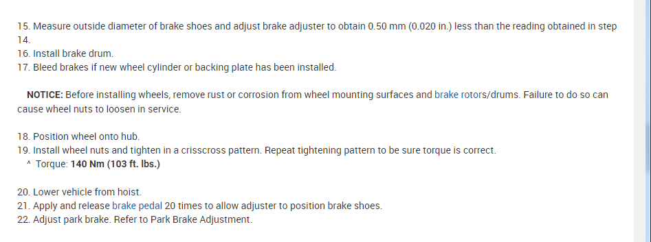

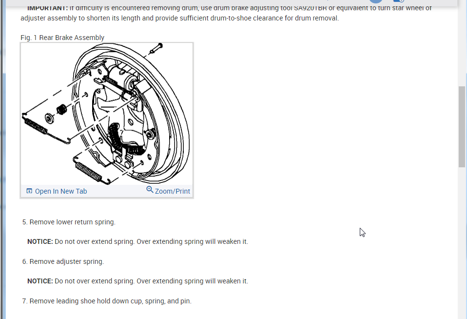

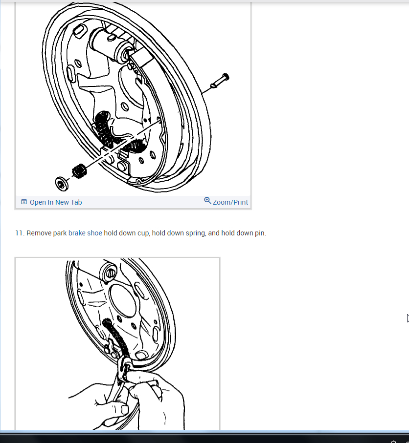

Noise when apply brakes I need to change the rear brake can you help me please?
Saturday, September 23rd, 2017 AT 4:36 PM
MECHANIC
18,907 POSTS

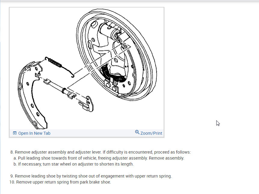

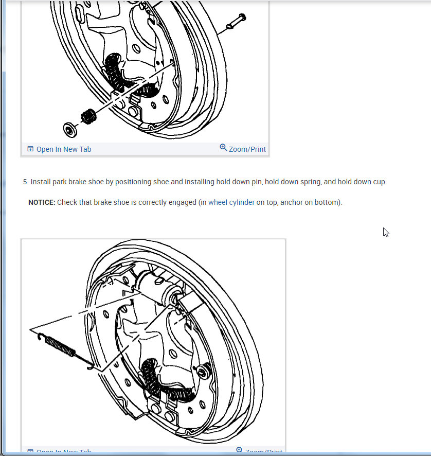

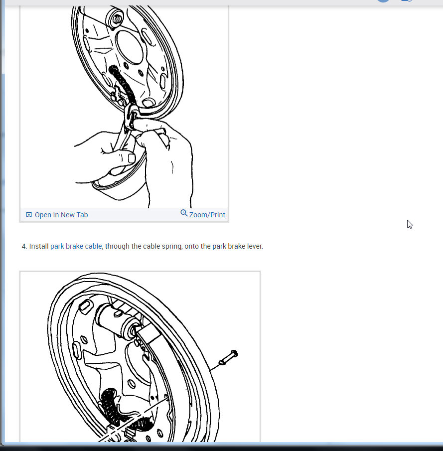

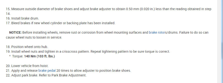

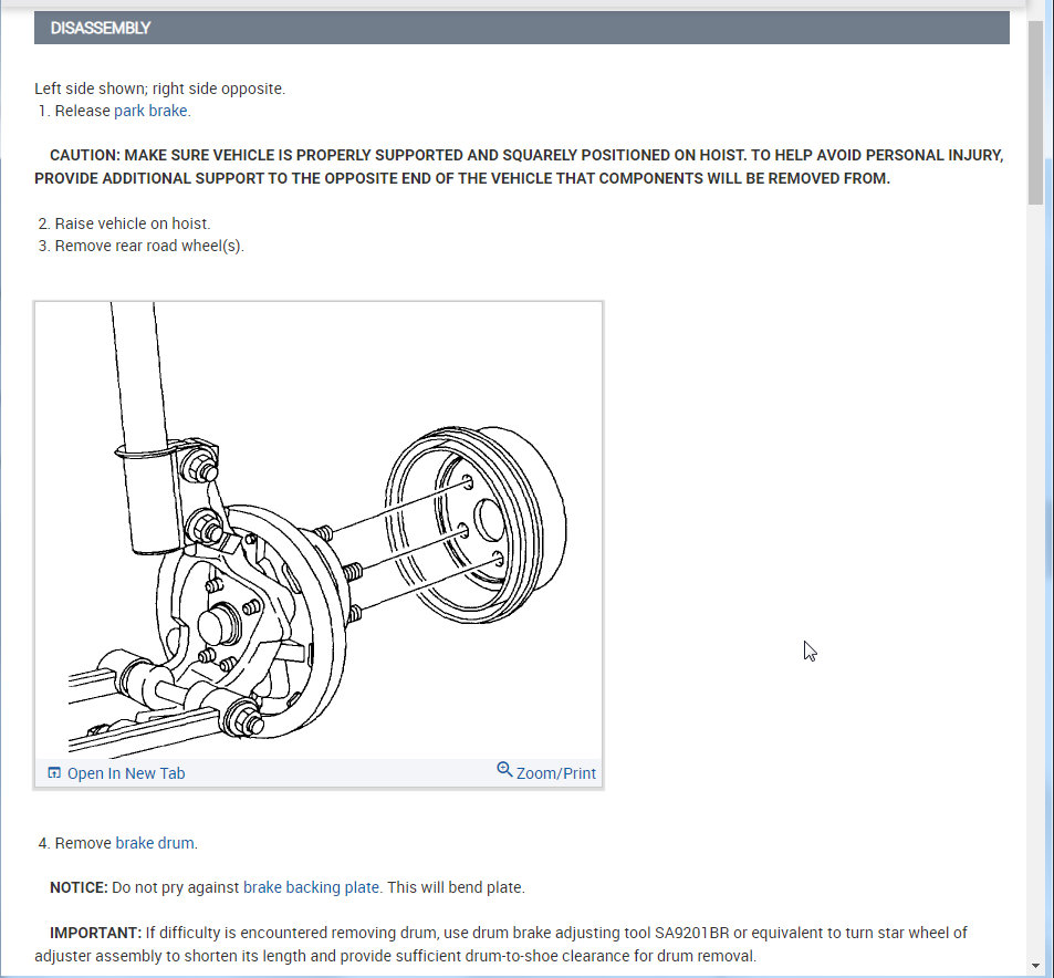

I am attaching the process on how to do this.
Also, here is a guide that will give more detail on how to do it as well:
https://www.2carpros.com/articles/how-to-replace-rear-brake-shoes-and-drums
Below you will find the process from the manual which will walk you through this as well. Let us know if you need more info. Thanks
