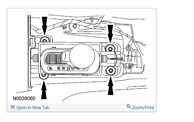

How to change out shifter
2007 FORD EXPLORER SPORT TRAC
135,000 MILES • 4.0L • V6 • 2WD
MTS62

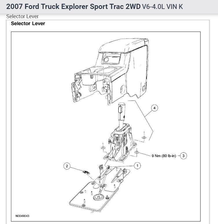

I have to remove old shifter and replace with a new one.
Nov 20, 2019 at 8:42 AM
  • 54,520 POSTS

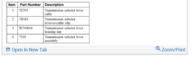

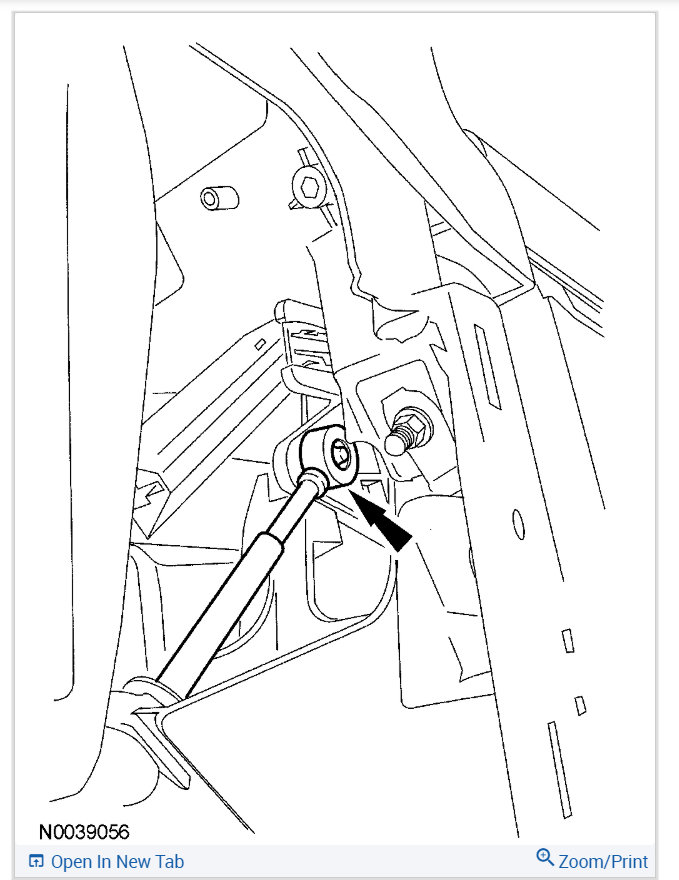

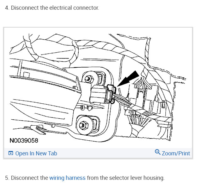

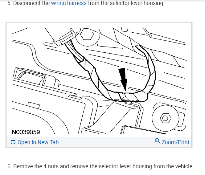

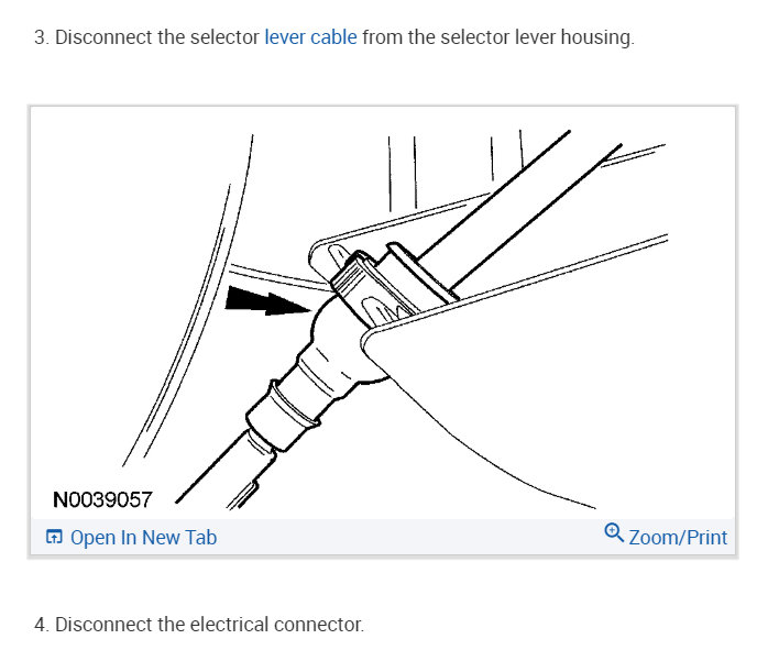

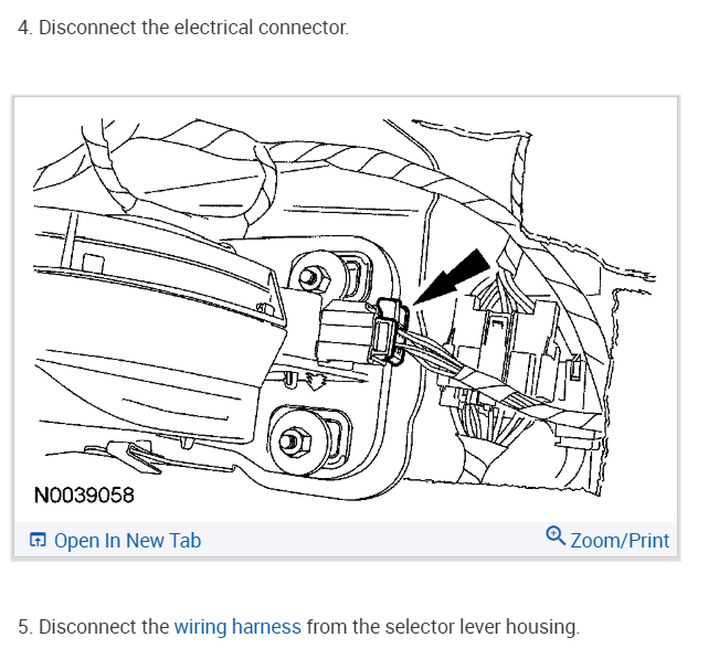

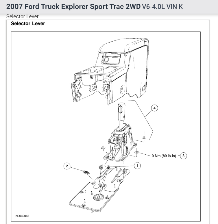

The shifter replacement instruction are in the diagrams below. You must remove the center console before you can begin. Check out the diagrams (below). Please let us know if you need anything else to get the problem fixed.
