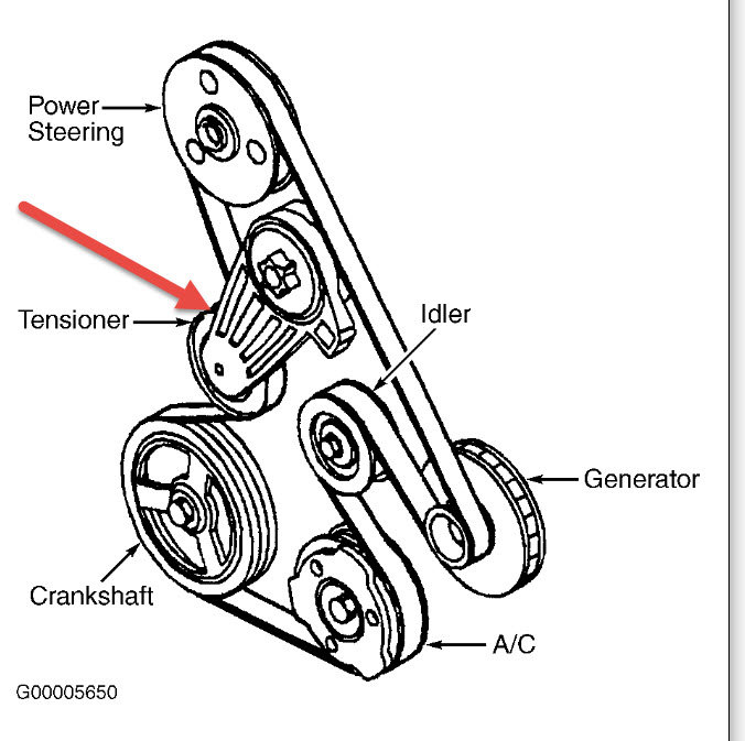

I am getting ready to replace belts are there one or two belts required? Thanks

If you don not have an auxiliary generator there is one belt. If you replace the belt replace the tensioner as well see picture. When taking the belt off move tensioner away from belt.
