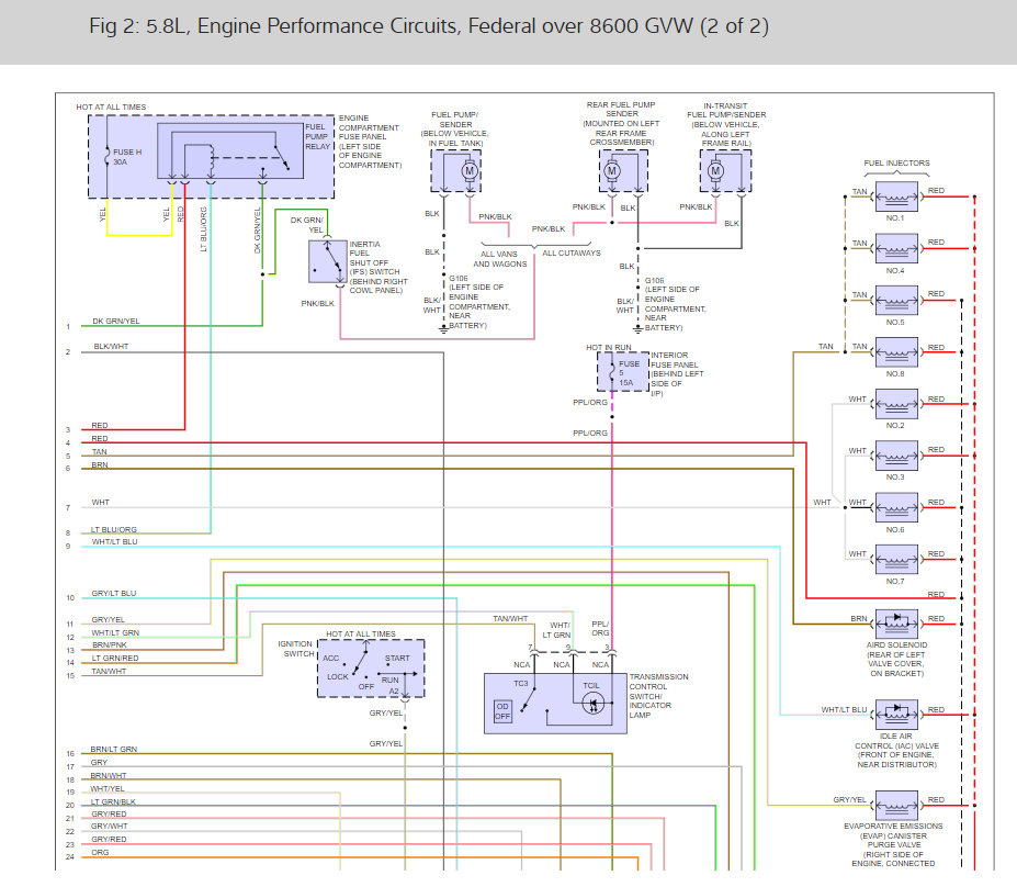

On this van the PCM has only two pins dedicated to sending a signals to the fuel injectors. It appears each pin supplies a signal to four fuel injectors simultaneously. How can that work? I always believed that the cylinders fired in sequence, but how can that be if the PCM is alternately opening four injectors at the same time? I am getting a headache trying to get my brain around how this could possibly operate. Could someone please explain how this works?
Wednesday, September 5th, 2018 AT 6:04 PM
15 Replies
Good evening.
The PCM does not send power to the injectors. Power to them is provided by a fuse controlled circuit from the ignition switch. From there the ground side of the injector goes to the PCM. Based on the cranks sensor signal, the PCM grounds the injector to allow the injector to inject fuel into the cylinder. It makes and breaks the ground many times per second to allow the proper amount of fuel into the cylinder.

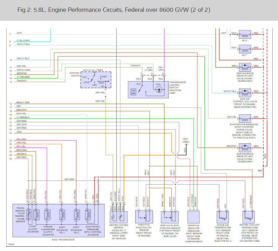

That sounds fine, but the wiring diagram in the shop manual does not match that at all. You can see the two pins feeding to the two groups of injectors, pin 59 feeds the odd numbers cylinders, and pin 58 feeds the even numbered cylinders, then on the other side of the injectors you can see all the grounds are tied together. Makes no sense to me at all.
What got me here was I wanted to run a test by turning off each injector to see if the RPM's drop off on each cylinder. They are so hard to get to I was going to add 8 N.C. Momentary push buttons to my breakout box so I could momentarily interrupt the signal to each injector without physically removing each connector. I was shocked to discover I only had two injector pin outs to work with instead of eight. So that ruined my bright idea.

The system and controls are the same for 1995 and 1996. They are exact wiring diagrams.

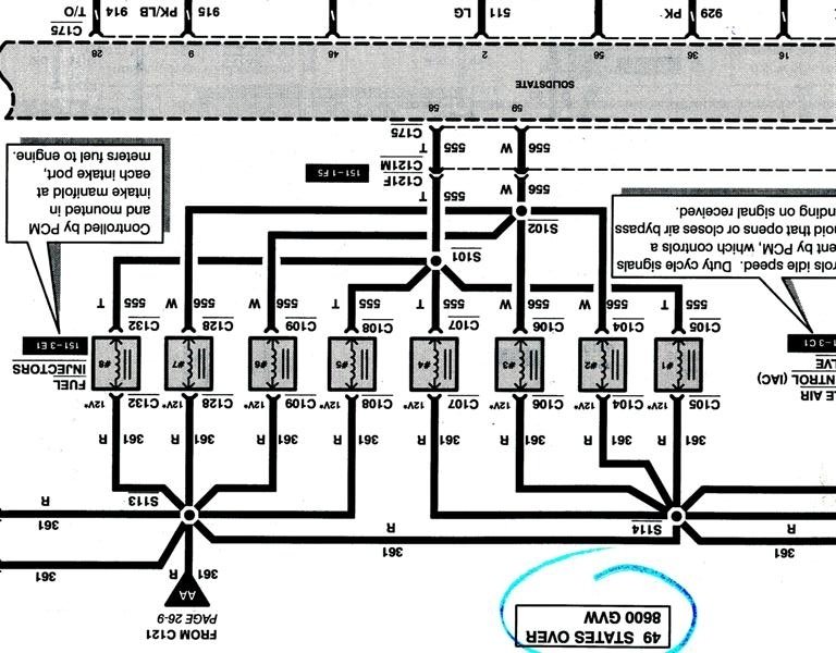

That is the way the engineers developed the system. The red wire is common to all eight injectors if you look at the diagram. There are two connectors to each group of four but they are fed by a common feed.

If the injectors are connected/wired together in groups of four how is each injector opened individually at its proper time if all four are wired together?
+1
Thursday, September 6th, 2018 AT 4:03 AM
They do not. In that diagram the companion cylinders both get fuel when the PCM grounds the the control. Strange way of controlling it but that is the way Ford designed it.

That is the same wiring diagram I have. It still does not explain how it works. You can see that all the injector grounds are tied together and all eight cylinders are controlled by only two wires from the PCM. If four injectors are controlled by the same two wires how can each one inject fuel at the correct moment? Wouldn't all four inject fuel at the same time? That would be okay if all four cylinders were firing at the same time, but they are not. The distributor is firing them in sequence, and each injector must operate in a matching sequence. So how is this possible?
If half the rail is charged at a time what controls that charge? The only thing I see is the fuel line from the gas tank, a fuel pressure valve controlled by the amount of vacuum in the intake manifold, and the pipe splitting off to the two injector rails. There does not appear to be anything that would allow the rails to have separate charging, and nothing in the wiring diagram to indicate any other fuel controls.
